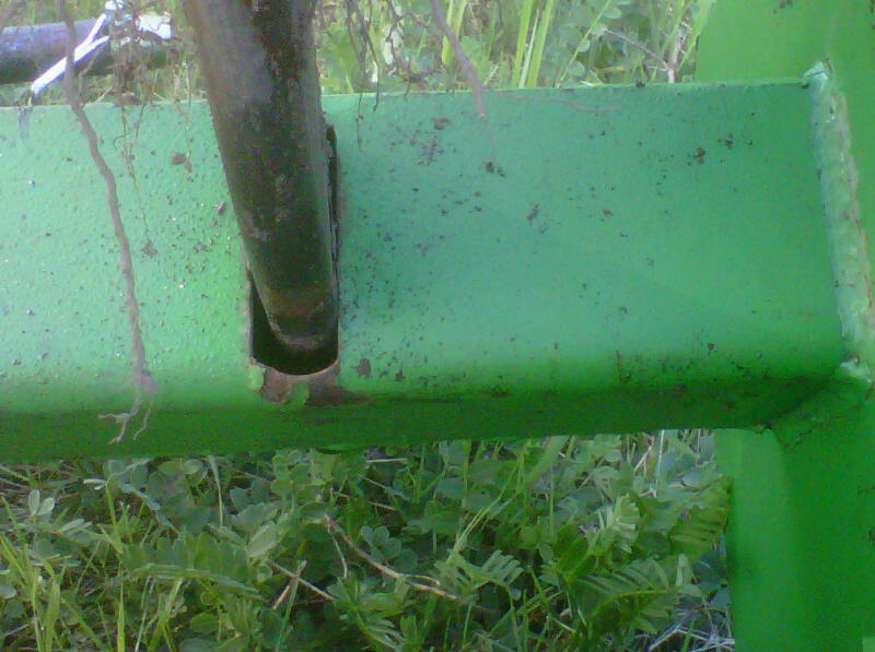

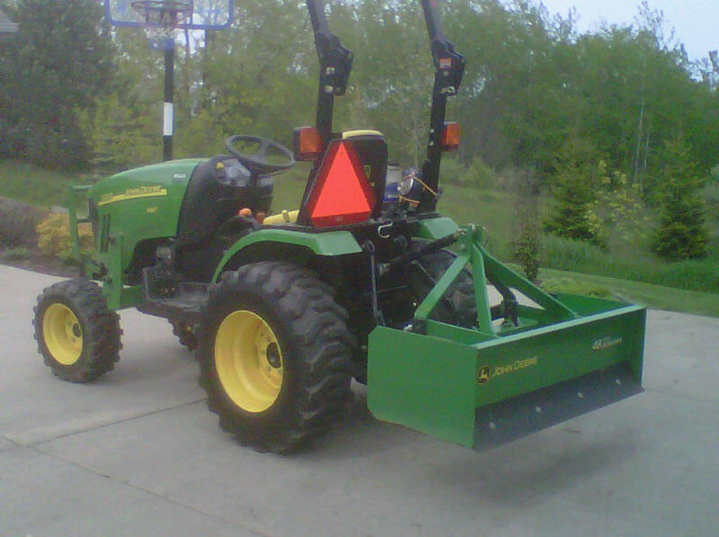

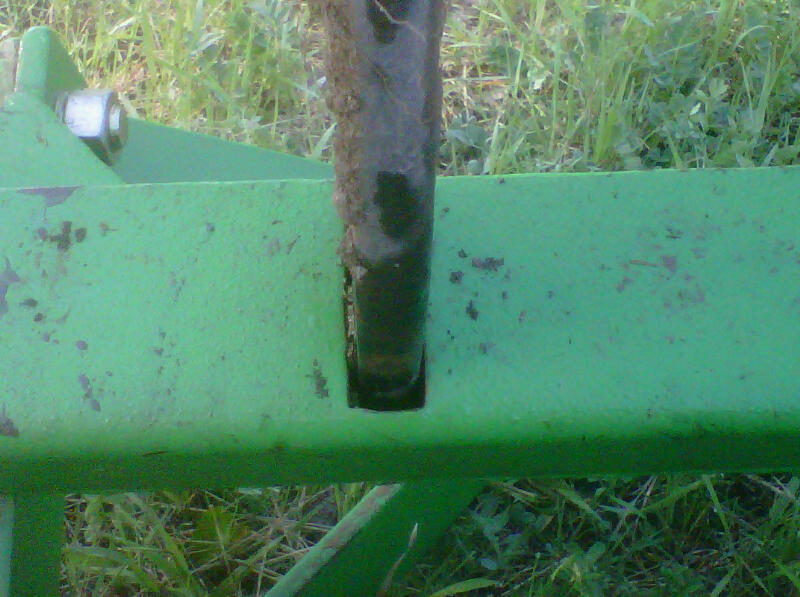

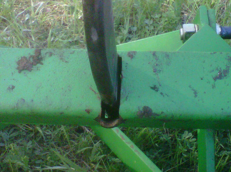

I just acquired a 48" used box scraper this weekend for my JD 2320. Even though I know you are looking at the 60", I thought I would give my 2 cents since you still in the 'looking phase'. I went with the 48" b/c I wanted something ASAP and thought I could start small and always go bigger. Besides, I found a pretty good deal on a used unit.
a) I think 60" will be just fine with your machine. I ripped 12k sq ft this weekend for additional horse pasture. Ground was virgin with rocks and small roots (1-3") and the tractor never had to really work.
b) Below are some pics of the underside of the 4x4 square tube that runs the length of the BB (where the shanks slide up and down). As you can see, I had one shank push back through the cut out of the 4x4 square tube (I did pull out some pretty big rocks). 2nd pic = good; 3rd pic = bent; 4th pic = starting to bend.
c) I also agree with saskman49 in regards to a boltable cutting edge.
My advice when 'looking' at the different scrapers, is to see how heavy and robust the unit is. Be allowing different positions for the shanks, it creates a lever and in turn, the load on the shank is on a very small portion of the square tubing. For reference...I flipped my BB upside down to take pics. I also apologize for the low resolution pics as I had to use my blackberry that day.

Lost how is the 48 doing covering your tracks from the rear I am just a little concerned going to a 48 when doing final grade work in the yard
It does cover them but all the work i have done thus far has been straight. That was a concern of my also and if my driveway was gravel, I would have looked at nothing less than 54.
