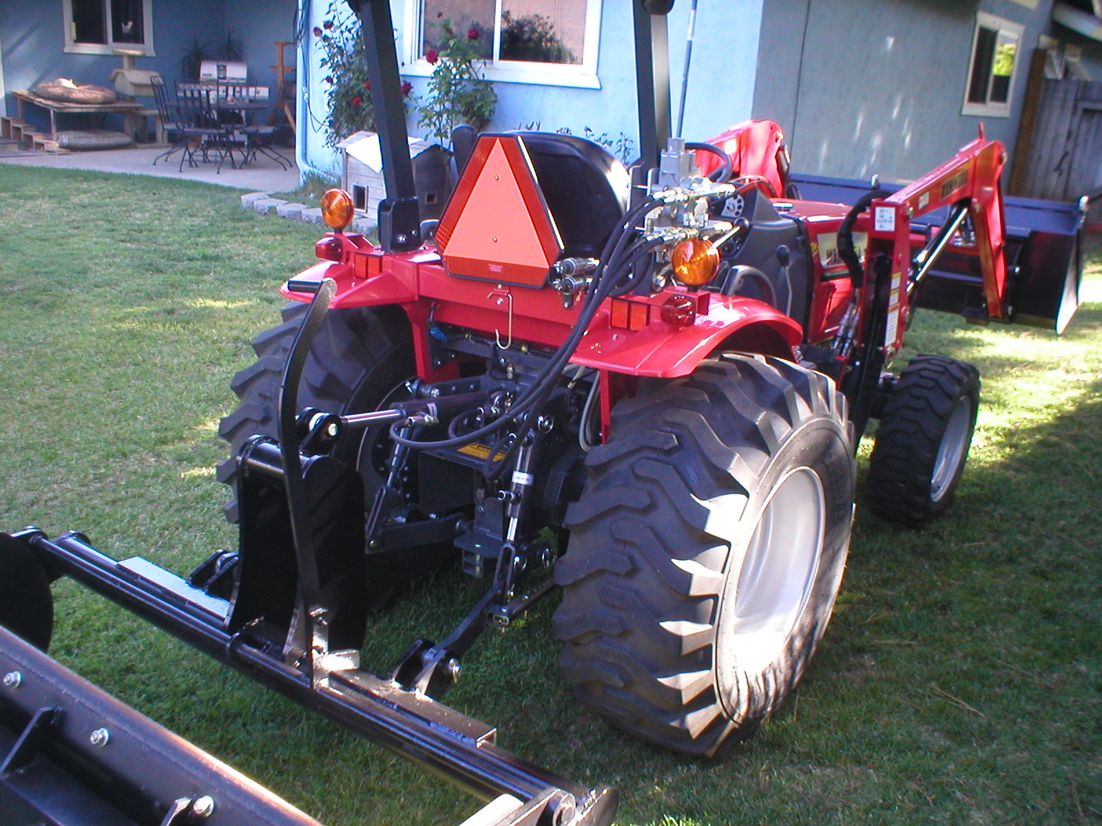

Though I know I want TnT, I want to understand it better B4 I go off looking for one. My mount is a Kubota M6040. I have a long unimproved road/driveway that was put in over 10 years ago. Basically, no one has maintained in much. So I bought a box blade, thinking I would resell it (was a deal with a flail) but I have started using it.
Last year I did some work on the road with a cheap rake, but I decided that without gauge wheels, it was minimally effective. The box blade digs up the big rocks and fills in holes, but it too seems to need gauge wheels when attempting to smooth/finish. It also seems to take forever to move stuff from the ditch to the crown, which was why I wanted a back blade. Anyway . . .
I am hoping someone can help me understand how TnT will improve Box blade performance without gauge wheels. Seems straightforward that Tilt will make ditch/crowning simpler, without getting on and off the seat. But how does the hydraulic top link help? Do they have a float position?
