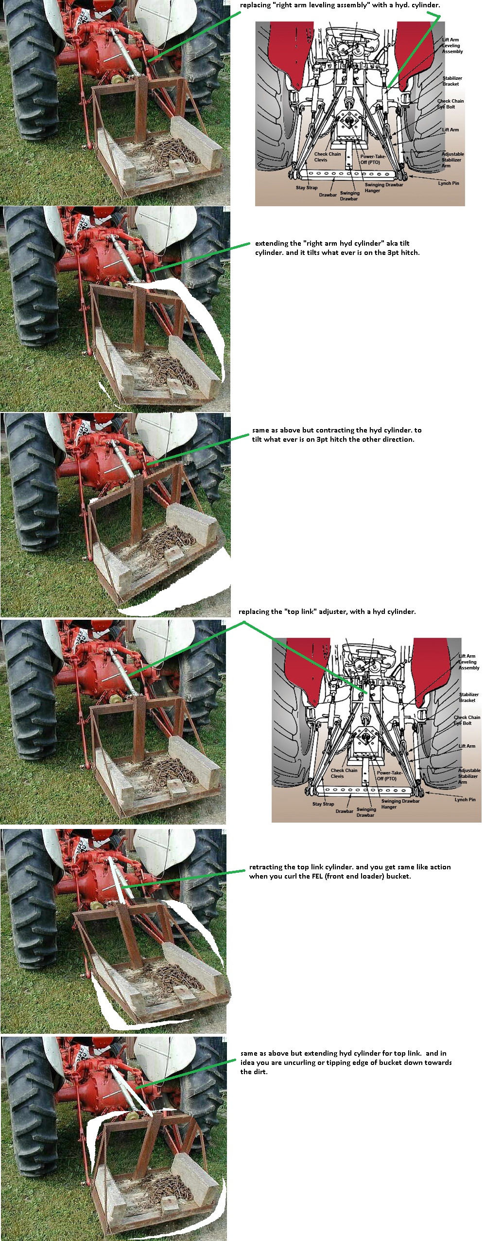

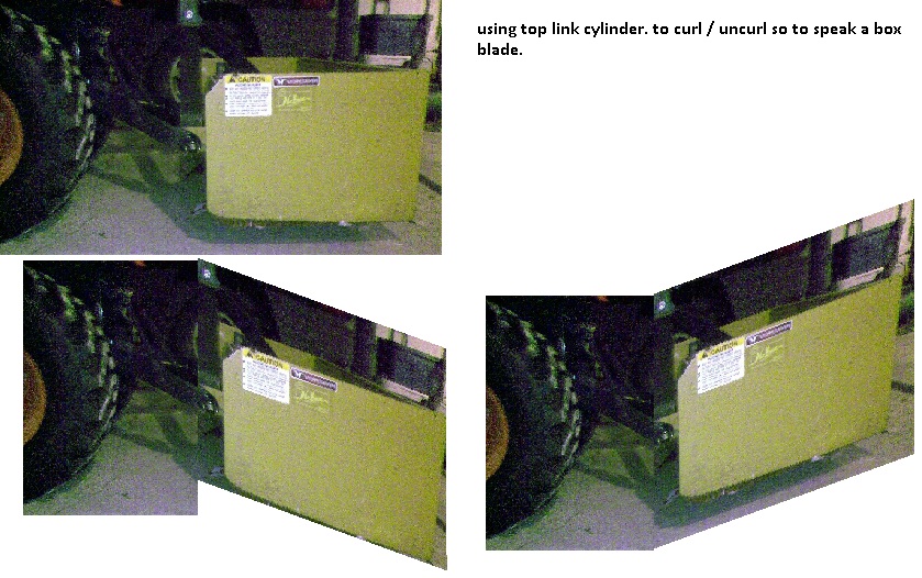

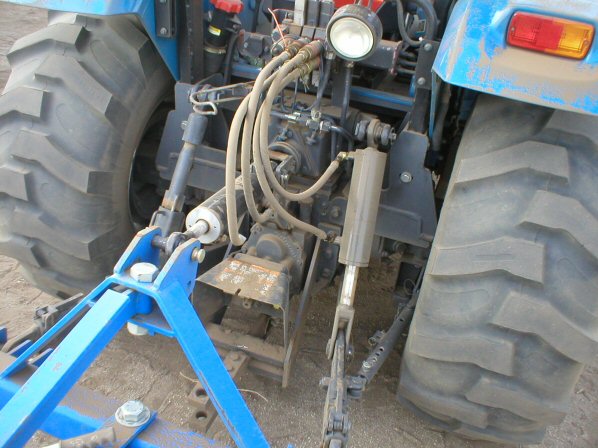

TnT=Top and Tilt. It is achieved by using a hydraulic cylinder in place of the top and side links of the 3pt hitch. That allows you to make adjustments without getting off the tractor and to change adjustments on the fly.

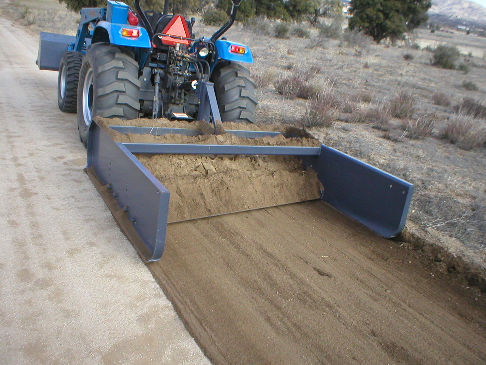

MarkV
/ Help me understand TnT-how does it help grading? #11

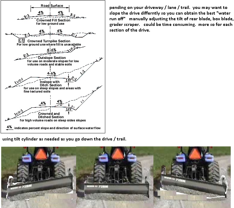

i generally see the following 3 items (3pt scraper, 3pt box blade, 3pt grading scraper) as a good want when dealing with trails, dirt and rock driveways. each has there own specific uses and features. also having a FEL (front end loader) can be nice as well. (back dragging for example)
i can do a descent job on the 1/2 mile dirt lane back to a lake just using the FEL and back dragging. but it is a requirement to have left and right back steering brakes (separate brake peddles) way to easy to get the front tires off the ground. more so do to i tend to constantly change bucket angle and height of the FEL arms.
when i say descent, manly just pulling dirt back into ruts. and if need be moving some dirt into an area here and there. the dirt lane is not an all weather lane / driveway. ya need to stay off of it during rains. or bad rutting happens. that or need a truck or tractor to drive down it when it is muddy.
it still needs ditch on both sides. and one more culvert to get near a point were deeper mud spots would be reduced a good amount, and would just need to be rocked for a gravel driveway.
TNT (top and tilt) would reduce my time considerably 1/2 it if not more. i have a lot of hills, curves, etc... i need to deal with. and at same time the crown instead of being in middle in one spot. may need to be slopped to one side, then around next corner slopped to another side. getting on and off tractor, to just do a large adjustment is one thing, but that fine tuning would be to much chore work and time consuming to get on and off tractor. and would more likely half way do it with box blade and call it good enough. or less some big party happening and wanting to all look nice and good. with TNT one more pass and constant adjustment with a lever would be to easy not get a fine tune smoothness.
do you need the TNT? no. but boy can they make life easier. and help you get a better smoother driveway that is more towards all weather driveway vs. only driving on it during dry times.

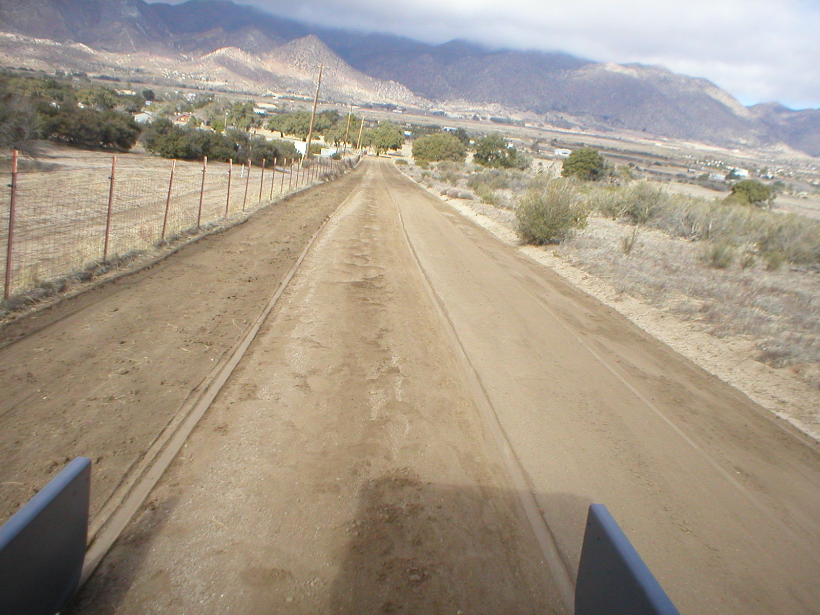

I find my TnT immensely helpful in maintaining my mile long gravel roadway and my woods road network. If I am using the rear blade it is the height and tilt that is most used. As the tractor is traveling over the ungraded or rough part of the road, being able to constantly adjust the blade angle and height to compensate for the tractor motion as it pitches and dips makes it possible to do a better job easier. When I am using my land plane grading scraper or box blade it is the top link adjustment I use most to control the cut.
Before I got my TnT I very seldom changed my blade tilt angle during a pass. I would just change it when I was setting up for the next pass. Now I am constantly changing the tilt angle as I go. Same holds true for the top link.

Having T&T will allow the operator to make both major and minor adjustments from the seat greatly increasing efficiency.
Here is my take on re-working existing gravel lanes.
Using a box blade, extend the scarifiers to their deepest setting and set the aggressiveness to the max and use the lift as needed, this will disturb the existing material and also cut high points and fill low points. Make as many passes as needed. It will look very rough but have faith. >
Next.
Raise or remove the scarifiers and set the aggressiveness to the min. Make as many passes as needed. This will smooth the surface to an acceptable degree, traffic will do the rest of the work. A rake will improve what the box blade left.
Working when the material is wet gets much better results than when very dry.
As for using the tilt cylinder, as soon as one side of the implement is no longer making the same contact as the other use the tilt adjustment to compensate.
