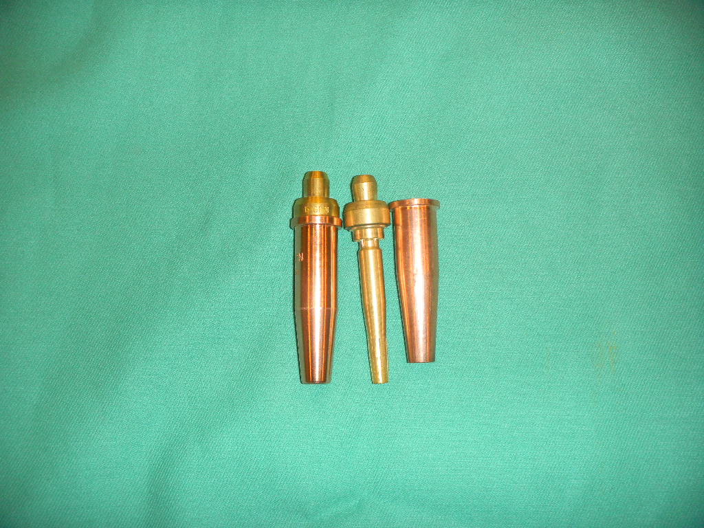

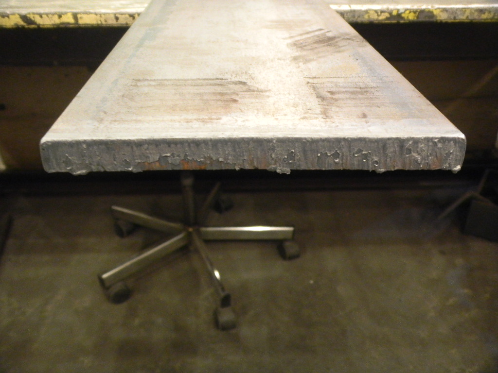

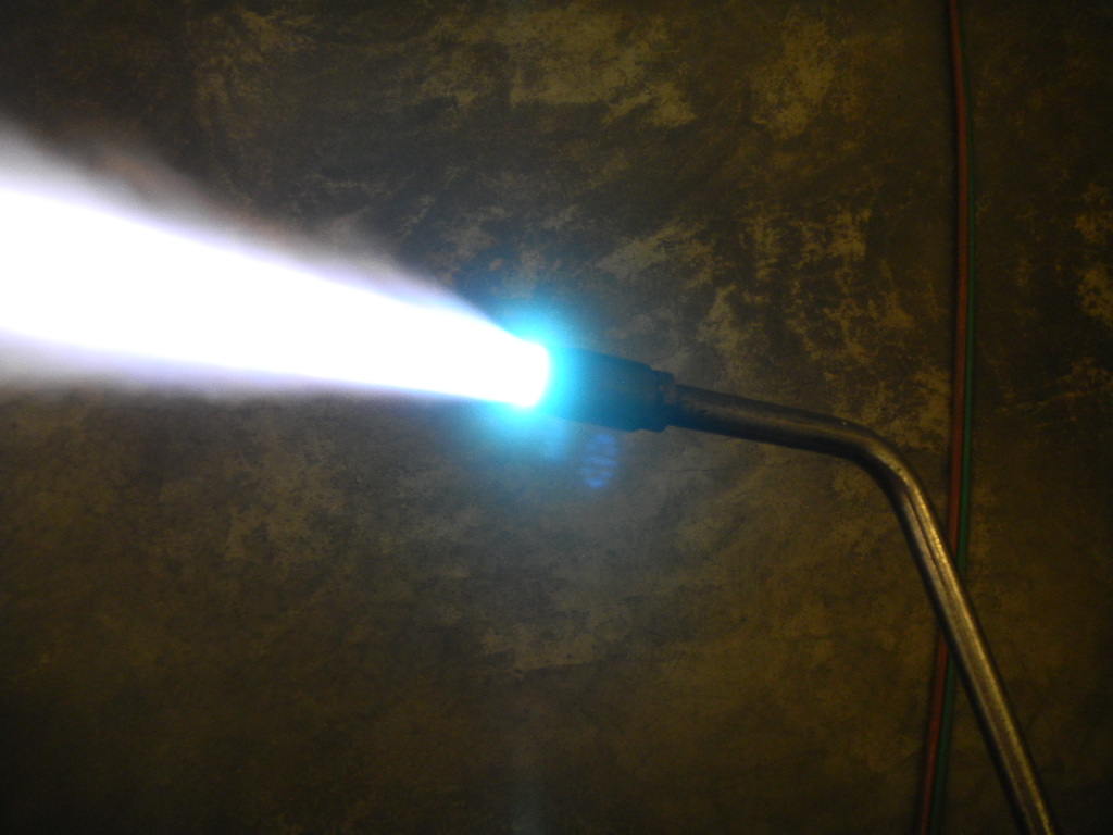

Technically you need to have grade T hose, and you'll need a propane tip. But I'll bet you have a propane tank around some where. Propane takes just a little longer on the preheat, but it cuts very nice.

Did a bit of research on converting to propane a while back, just generically acetylene tips' orifices are flush with the end of the tip, and propane tips have a built in recess; changes how they behave if not used on their "gas of choice" ... Steve
