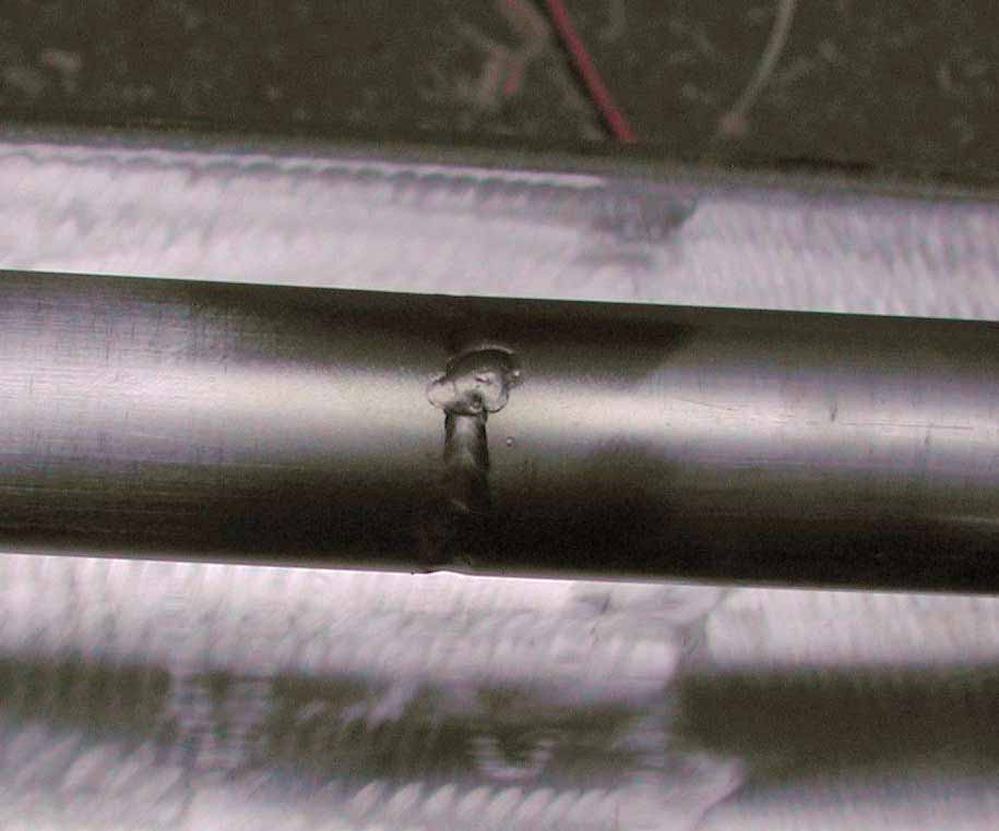

My first stainless effort:

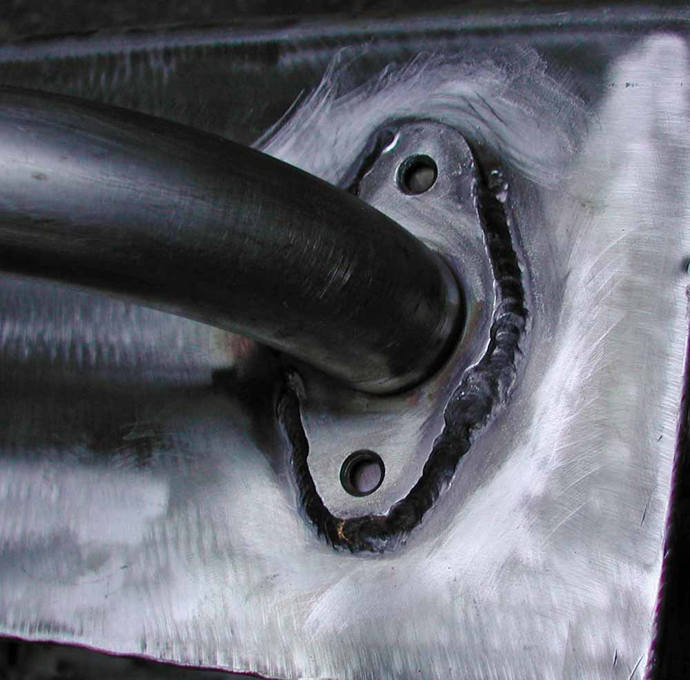

Yes I have, that's how I know it can be done;). But only tried it on DCEN, not AC.

What gas is that Aluminum weld made with? How many amps? What filler? How thick is that materiel ? Curious minds want to know:)
/ Help me find my tig problem #30

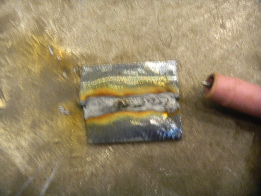

I think those welds are on 10-GA aluminum. If I remember correctly around 50 to 60-amps. On DCEN with 100 % Helium you can pretty much cut your amps in half compared to welding on AC. The problem with using a Tig rig, and no foot pedal you can not control the heat. Other than going faster, well you can only go so fast. Now this can all be done if you make short welds. Then move to another location, or let it cool down. Last time Furu, (member here) brought his Longevity Stickweld 250 over I hooked my Tig rig up to his machine. I really like the arc on that machine.:cool:
Here is the weld I made with it, notice how the weld gets wider at the end? That's because the heat was building up, and I had no way to control it.
The second picture is a weld I made with my Dynasty on DCEN with 100 % Helium, but I had a foot pedal.
