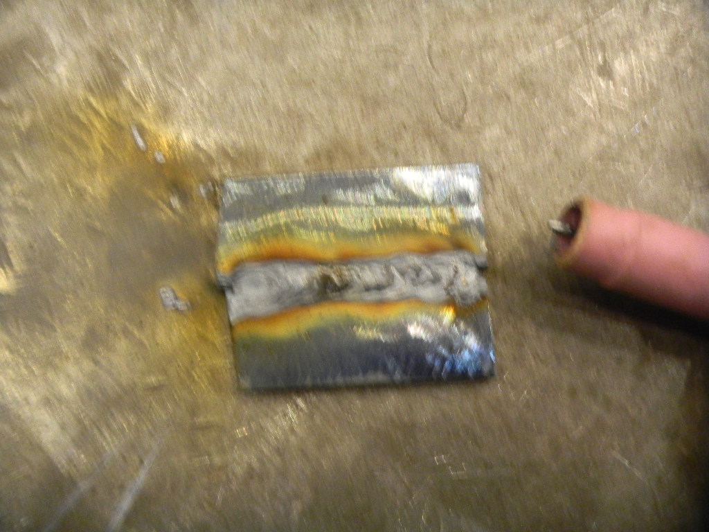

You see the question all the time from guys just starting with Tig. "Why can't I use my Mig gas to Tig weld?" A while back I thought to myself, wonder what does happen? So I hooked my Tig rig to my C-25 bottle. Here's what it looks like. Sorry for the blurry picture!:eek:

I have been grinding all the mill scale off, and wiping it all down with lacquer thinner.
It sure did make a difference.
Can dipping the tungsten in the puddle and badly contaminating it cause welds like the ones in shieldarc's picture?

If I remember correctly it was a very erratic arc, and I stuck the tungsten several times. Notice the arc marks on the table to the left of the plate? Soon as I struck an arc I thought to myself, oh this isn't going to be good! :laughing:

Oh definately! Once you contaminate your tungsten its a downward spiral from there, you'll wind up with having to weld through soot with arc wander and all sorts of mayhem going on. Clean clean clean is the name of the game when it comes to tig.
