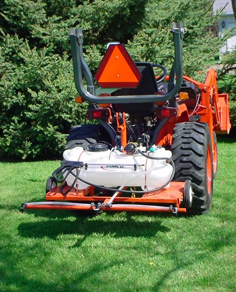

With that many trees, you're gonna need a good size tank.
This is what I came up with to spray the lawn. I started with a fifteen gallon tank but made the 3-pt. platform big enough to hold a larger one. Works good for my applications.

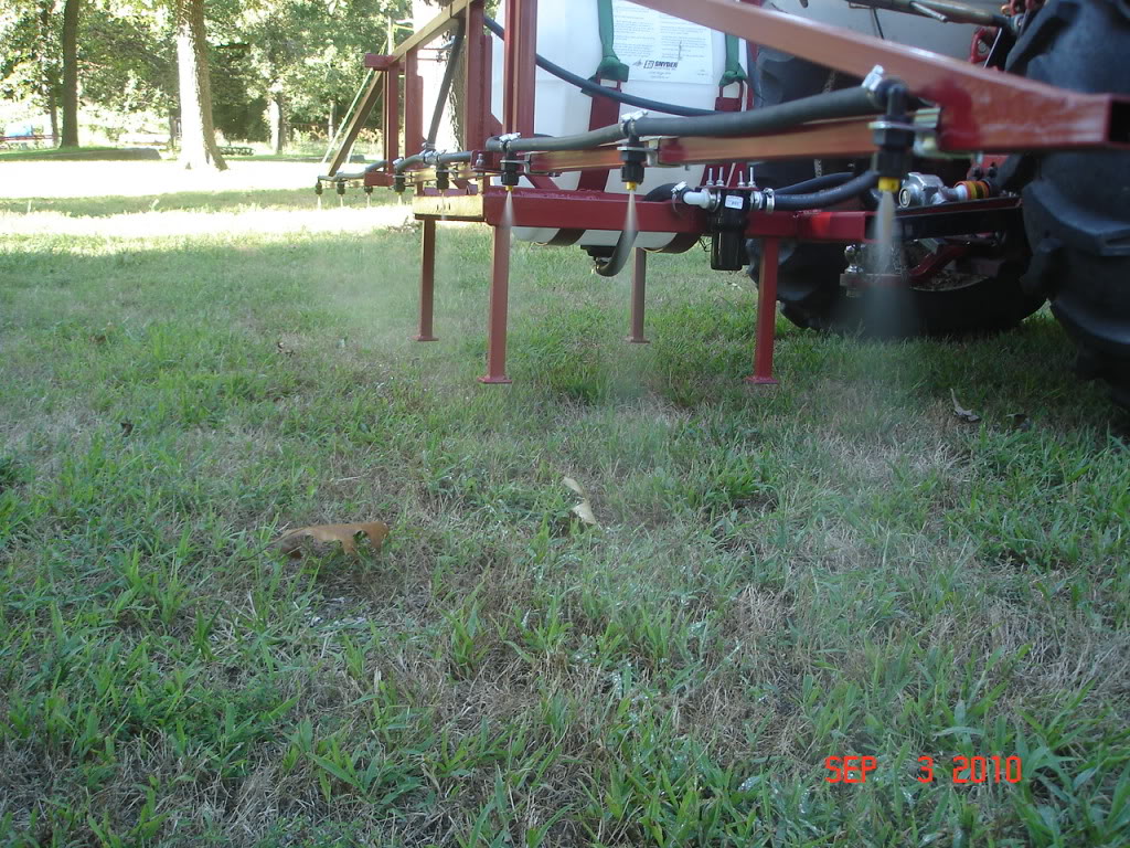

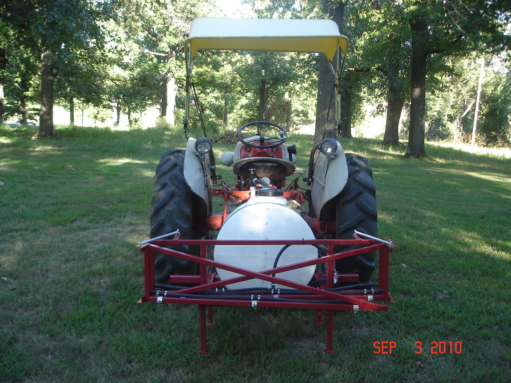

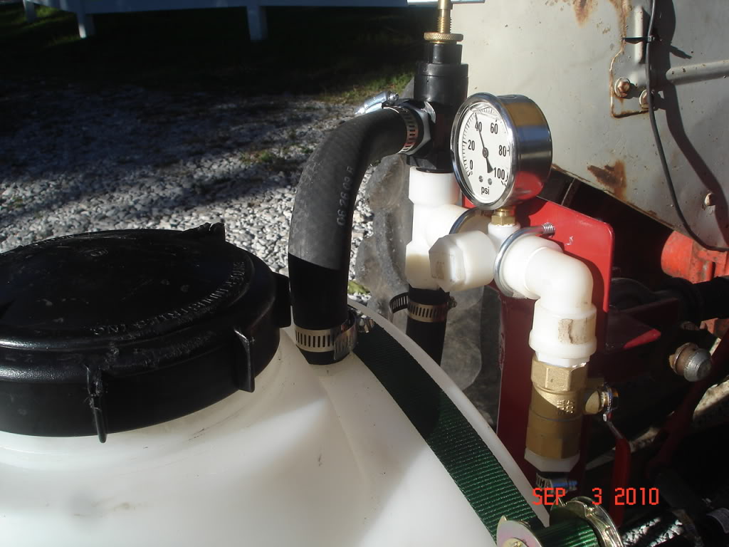

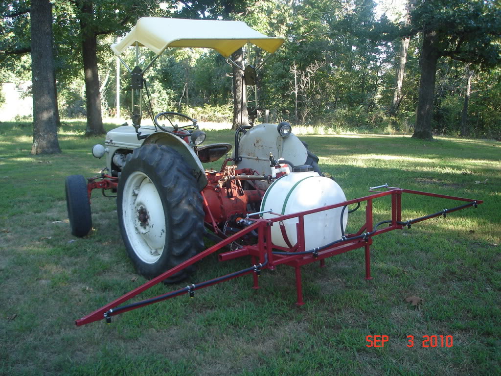

Here's my version. It has a 30 gal tank, 6 roller Silver Series Hypro pump, 12' foldable boom with nozzles @ 20". Under the pressure gauge in the 3rd picture is a valve for a spray wand to be added. The boom sprayer works great. Mark
