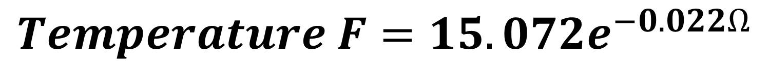

/ Help! L3240 won't start when cold #52
Bferris01,
To test the temperature sensor you'll need to know the exact coolant temperature and resistance value of the sensor. It is best if you can do this at two known temperatures.
Since you're unlikely to have the exact temperatures referenced in the WSM, I've calculated the equation that describes the temperature sensor output at >99% accuracy. Enter the resistance value in Ohms and compare the calculated temperature with the known temperature.
Equation shown below:
If you need help with the equation, just reach out.
