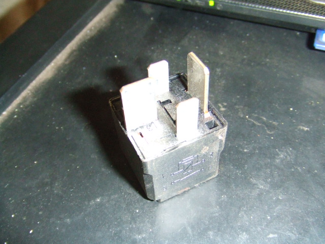

I have a 2010 L3240-HST-3 and this is the first issue I have had with it and need some help. So when the temp's dropped this season it began to give me issues with starting in the cold. I did some internet search and found some starting ideas to check but now I am stumped. I will say when the outside temps are not cold it starts and runs fine, I have tested the battery and it is fine. So here is the situation when temps are down:
-Try to start by cycling the glow plugs 2-3 times and it cranks over but won't start, get a white-ish smoke from the exhaust
-pulled the dash and there are 2 relays behind the instrument panel, 2- identical relays. I pulled the 1st one to look at it and there was some discoloration on the spade, so I replaced it with an autozone relay and when that didn't work bought a OEM Kubota relay and same result, no start white -ish smoke

There was a run of machines where Kubota installed the wrong glow plug and fuel solenoid relays.
You have to pull the dash to check both. The terminals are supposed to be large but they installed smaller than specified relays with small terminals that won't make contact when cold.
Good luck, Fred
/ Help! L3240 won't start when cold
Fred, Thanks... I discovered that when I got the OEM relay from Kubota, so it currently had the new bigger terminals. I had hoped that would fix it, but even with the new one installed same outcome.
