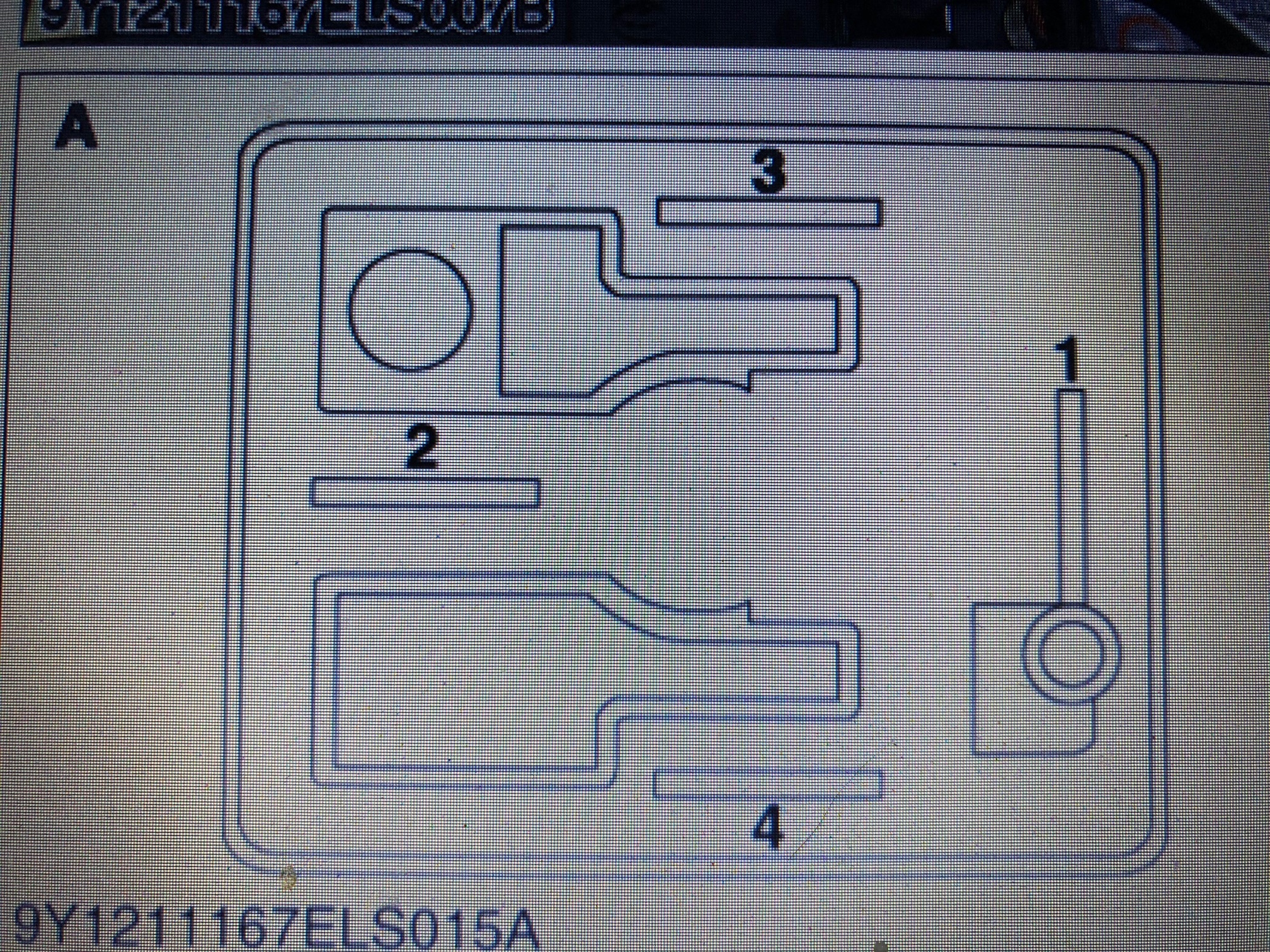

From the picture of the relay I could only tell you how it works. I can't clearly see the terminal numbers, but I can tell by the terminal blade sizes. The large blades carry the current from power to the glow plugs. Power may be battery+ or switched ignition. I would say probably battery + or always hot. The smaller terminals energize the relay. I'm not sure how a Kubota operates without looking at a wiring diagram. On an auto one of the small blades would be ignition + and the module or dash cluster in our case would complete the circuit. I can look at the wiring diagram on my M59 tomorrow, it may be similar. I don't think the power to the large blades would go through the ignition switch, that is probably too much current for the switch.

The pin numbering scheme for the relay from the Grand L40-3 WSM is shown in the first picture.
2nd Picture:
I've also included a picture of a Glow Plug wire connector above the oil filter area that is an easy location to check the presence of battery voltage. Simply disconnect to remove the Glow plugs from the circuit, so the voltage can be tested. (The OP also has this problem posted on another forum and he doesn't have this connector. I'm including the info in the event it helps anyone else that may have this connector. Perhaps the difference is that I have a cab model (L4740-3) and the OP is ROPS. It's also near impossible to isolate the glow plug power supply at the buss bar because of the AC compressor and bracketry being in the way. The voltage can NOT be measured with the glow plugs in the circuit.)
3rd Picture:
The last picture is of the 50 amp slow burn fuse for the Glow Plug power feed (Relay Pin 1). This wire then runs to the relay and from the relay Pin 3 to the Glow plug.
If nothing else, this may help others.

Now that it is away from the other relay and I testing it with a meter, I am getting all the proper voltage to the relay (12V on terminal #1 always, 12volt on #2 with the key on.
But the relay is not clicking and passing 12 volt to terminal 3 like the other is. ( I tried all 3 relays I have an all act the same way. Also when I bench test them they click strong enough I can feel it )
Does anyone know if terminal 4 is just a ground or what it goes too?
I feel like something is not telling the relay that it is ok to activate and let the power through, maybe?????????

Terminal four is the ground that completes the relay coil circuit. I'm not sure if it goes through the ignition switch,or the instrument cluster. Maybe someone with a WSM could tell you. Don't ground that wire while it is connected to the tractor wiring. Leave it connected to the relay but disconnect from the connector side.

Pin 4 of the Glow Plug Relay is the ground side that goes back to the instrument panel. This is Pin 11 on the 20 pin connector on the instrument panel cluster. The OP can check continuity between the two ends (Pin 4 of relay and Pin 11 of connector). Should also check to make certain the pins are fully seated within their socket and verify there is no corrosion.
If all this checks out, it could be the coolant temperature sensor is not sending the correct ohm value with respect to temperature. IE: The computer thinks it is warmer than it really is.
