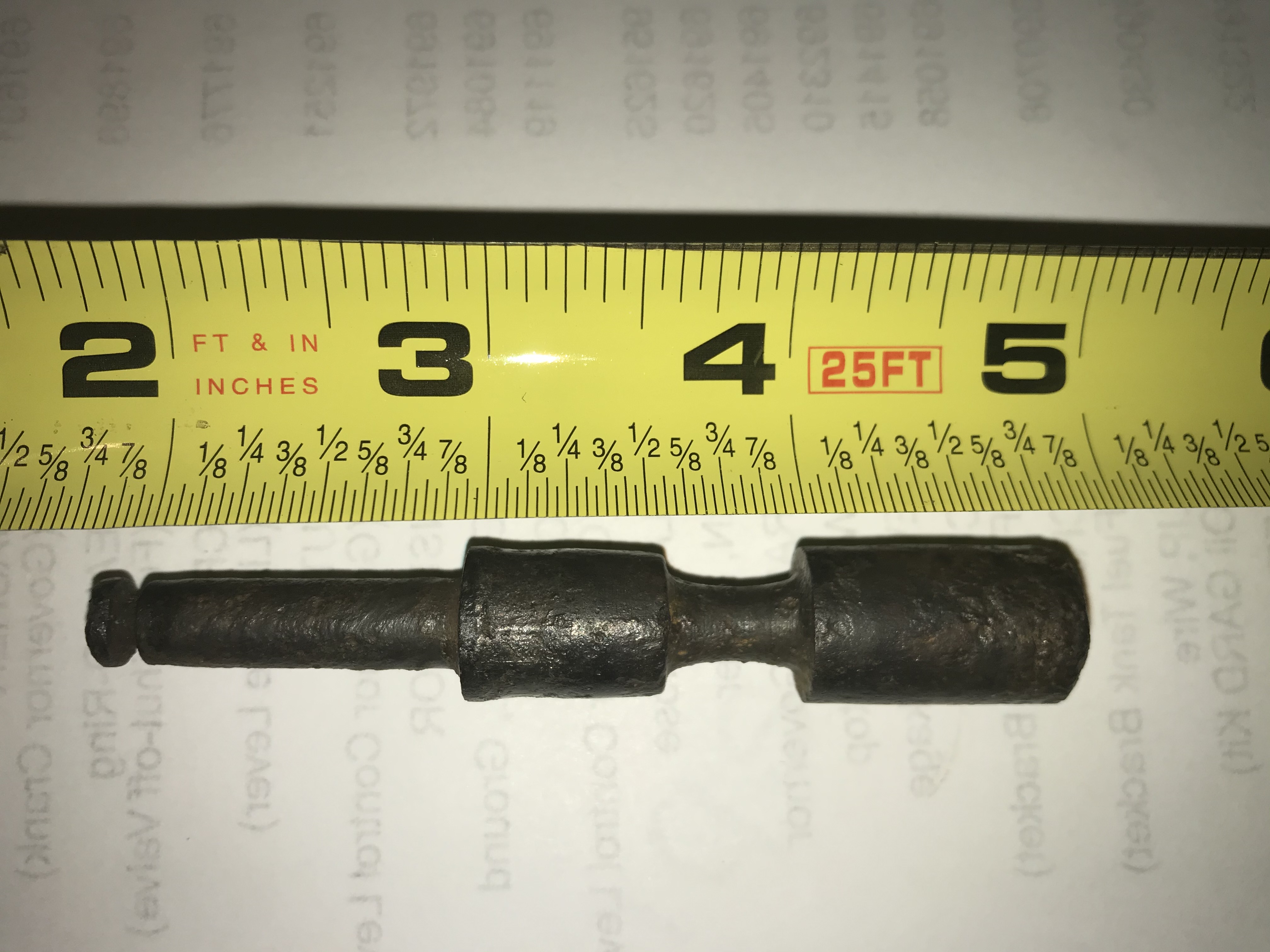

help id this pin
   / help id this pin #1
jiminpa
Bronze Member
Aug 1, 2000
74
northwest pa
massy 35 diesel
i think its a bush hog mower. was my ex's grandfathers, completely rebuilt by him. this pin came out of the quick disconnect on the pto shaft.
   / help id this pin #2
It appears to be the pin you depress to allow the PTO shaft to slide into place and hold it in place once properly situated.
   / help id this pin #3
I think you've already identified it. The ones I'm familiar with use a spring for tension and clip to keep it in the hole.
   / help id this pin #5
Lost mine one time.
My solution was to clamp a 3/8 bolt in my drill press and using a file I 'turned' one (LOL, vertical lathe).
Drilled a hole for a cotter pin and scrounged a suitable spring.
That was 8-10 years ago and still holding just fine.
Not the most economical but sure saved lots of time plus I like DIY.
   / help id this pin
got the pin showed above. had to do a little fitting, but got it on. now if it would quit raining i can try it out!
