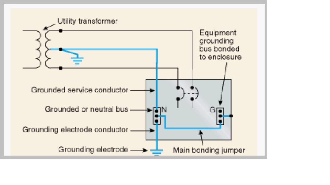

More like : ///////resistance/////////120V (Line-Neutral)) (L1) ----- // | // | // | /////////// Nuetral/////Zero 0-Volts//////(Grounded/Earth) 240V (Line to Line) // | // | // | ///////////resistance)////////120V (L-N)(L2) __|___ but then neutral connection, or it's bond with ground/earth goes bad, and the neutral is not pegged to O volts, thus the 240V L-L is not evenly divided in half to 2 phases of 120V (L-N), instead, now the 240V (L-L) is split across the two resistances, in proportion to one (L1) circuits resistance compared to the others (L2) circuits resistance. (Example if L1 resistance is twice the size of L2's, then the voltage will split 1/3 (60volts) in 1 circuit and 2/3 (180V) in the other.) The way the 240V L-L is split and the voltages measured in any one circuit will change as you switch different resistences (loads) in and out of the circuit, but always add to 240V. With a floating neutral , it now looks like this: ///////resistance (twice that of ckt. L2)/////////160V (Line-Neutral)) (L1) ----- // | // | // | /////////// Nuetral///// -- Not connected to (Grounded/Earth, O Volts) 240V (Line to Line) // | // | // | ///////////resistance)////////80V (L-N)(L2) ----- Edit: Grrrr. My vertical lines showing constant 240V between ckt L1 and L2 don't align.
I think I follow you but in layman's terms do you think the most likely source of the faulty neutral is in my buried cable?
/ Help! Flickering lights/haunted house #31
Most likely in the neutral connection some where, either the connection at your box, in the cable, or at the utility's transformer. Note: Your panel neutral bus should be "grounded" to 0 Volts by a connection to your ground rods. This connection should be made at one location only, at the first disconnect point of your service. Typically there is a jumper between the panelboard's neutral bus (white wires) and the ground bus (green wires) in the panel, and the ground bus is connected to a ground rod in earth.

Most likely in the neutral connection some where, either the connection at your box, in the cable, or at the utility's transformer. Note: Your panel neutral bus should be "grounded" to 0 Volts by a connection to your ground rods. This connection should be made at one location only, at the first disconnect point of your service. Typically there is a jumper between the panelboard's neutral bus (white wires) and the ground bus (green wires) in the panel, and the ground bus is connected to a ground rod in earth. <img src="http://www.tractorbynet.com/forums/attachment.php?attachmentid=357821"/>
One of the first things the electrician tried was adding a new ground.
