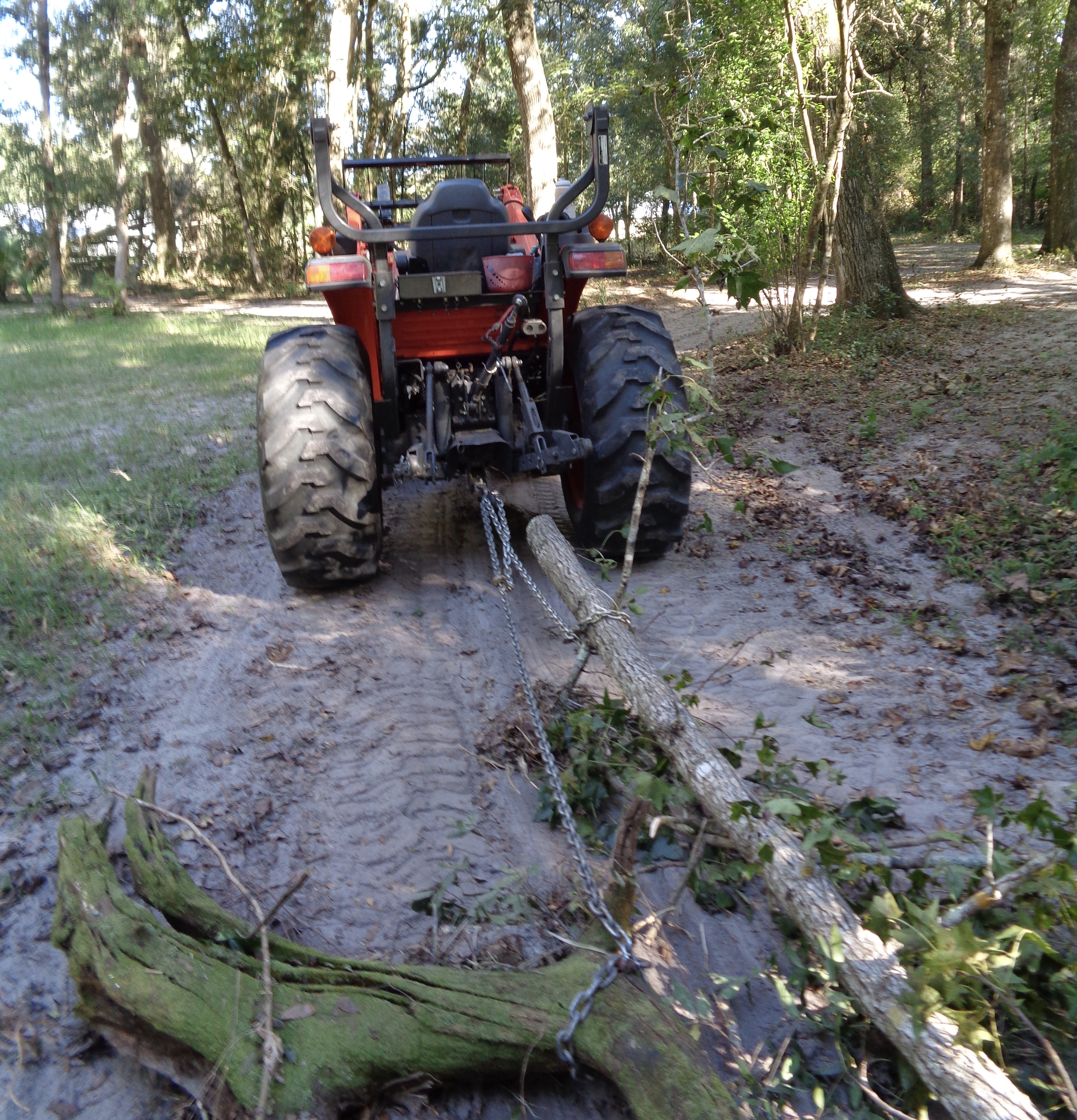

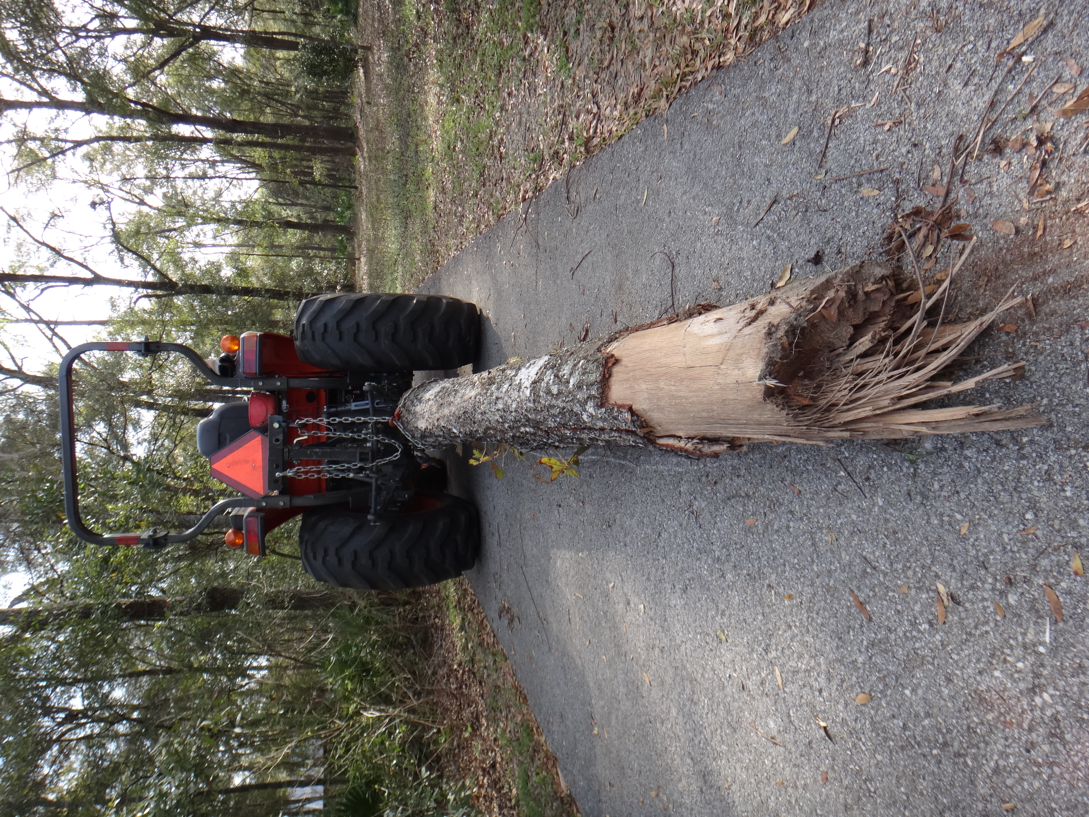

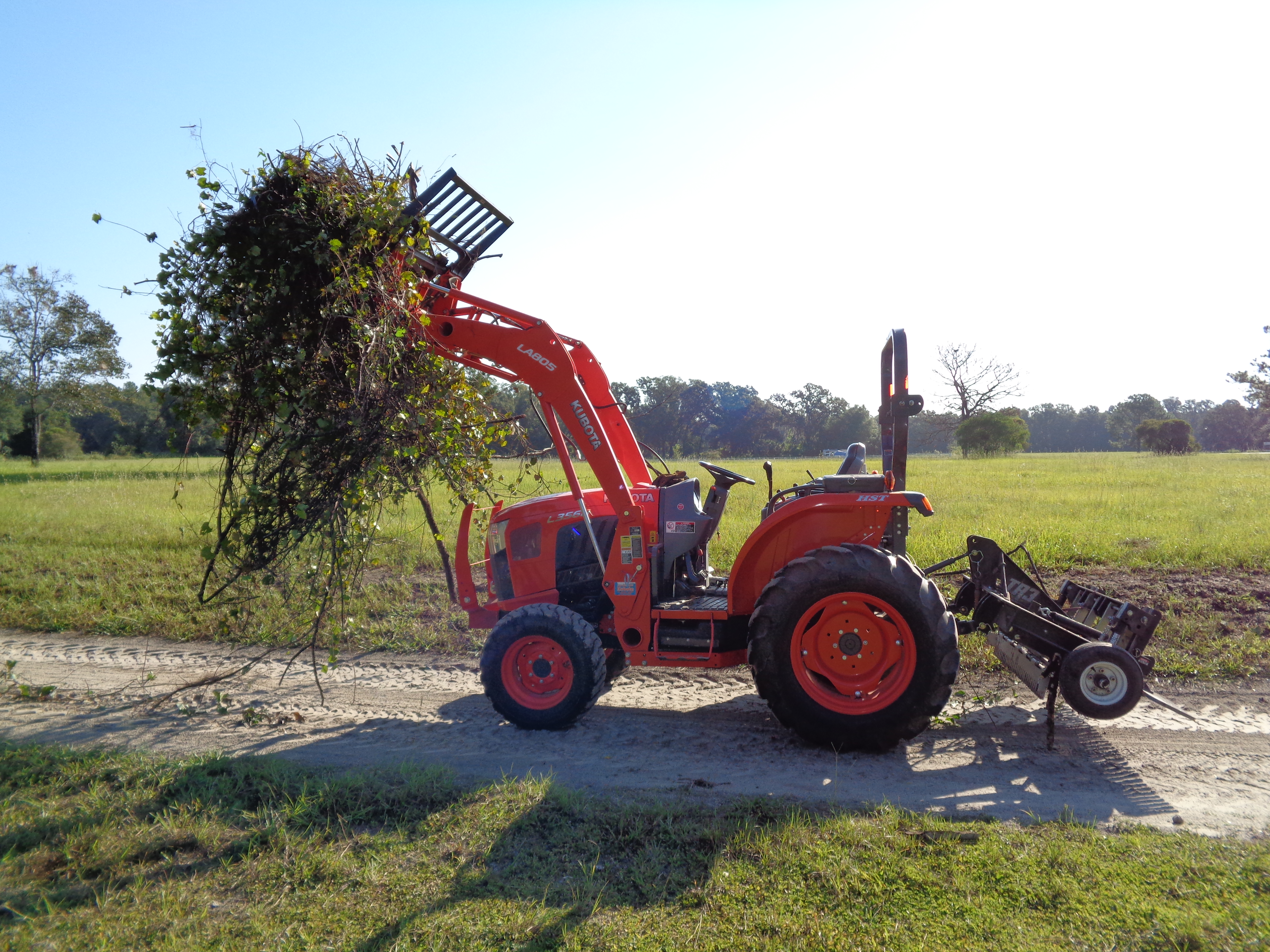

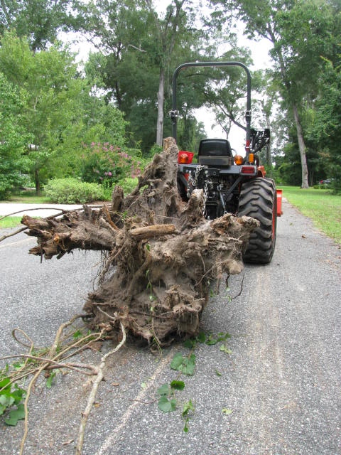

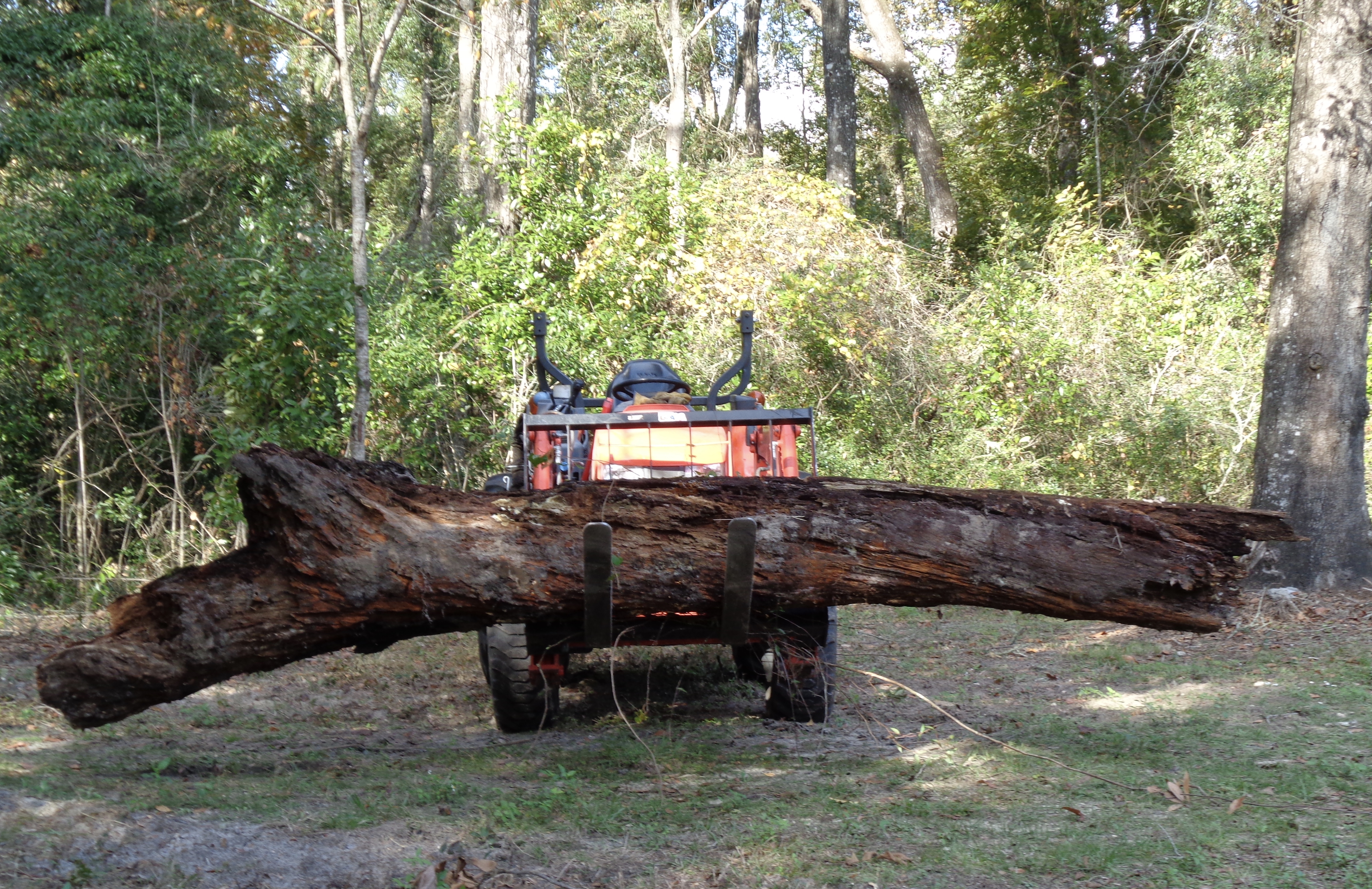

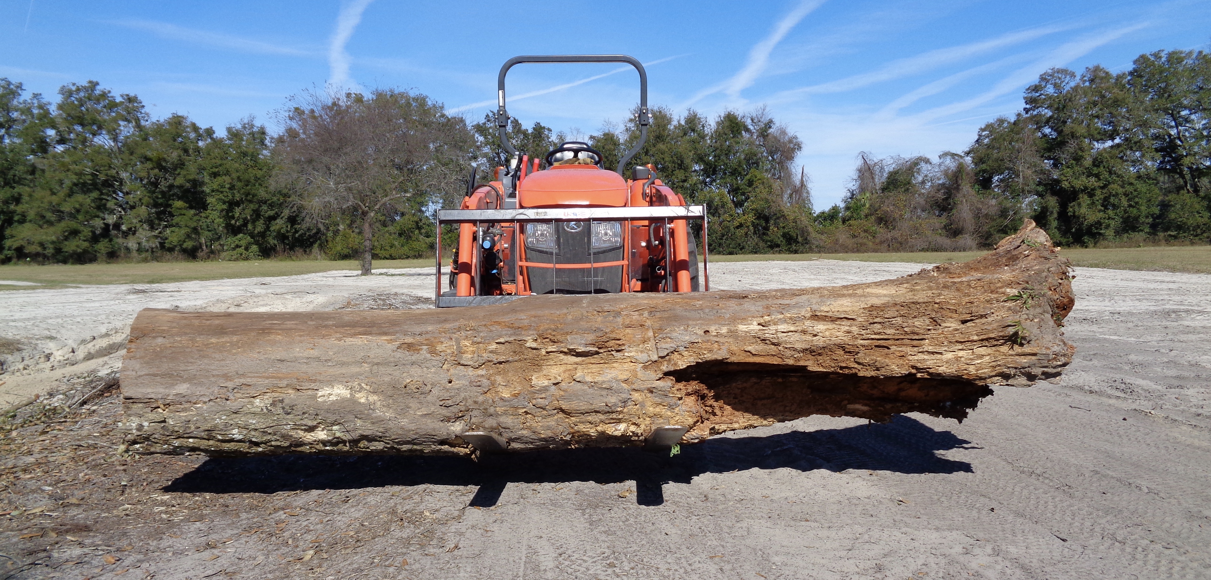

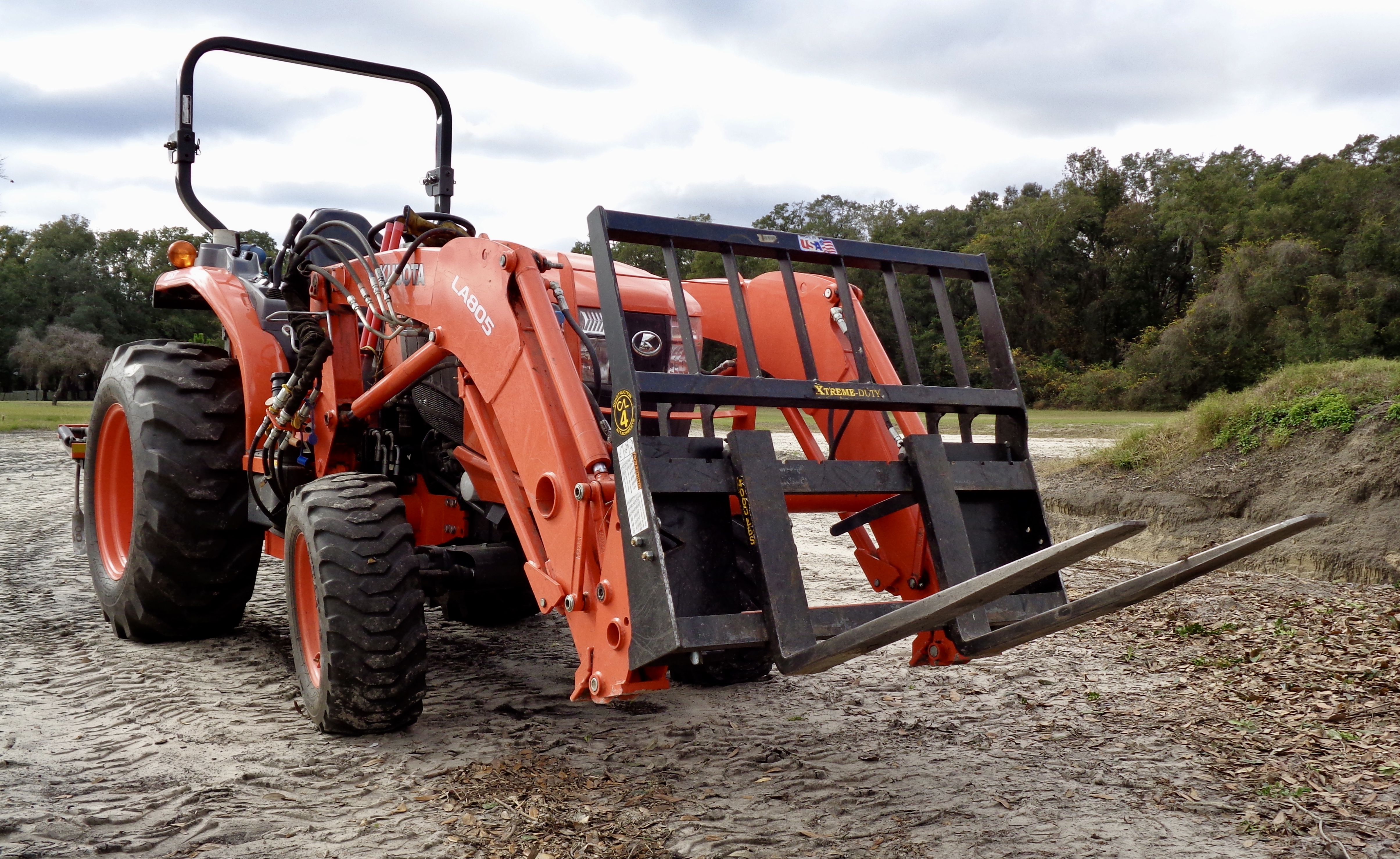

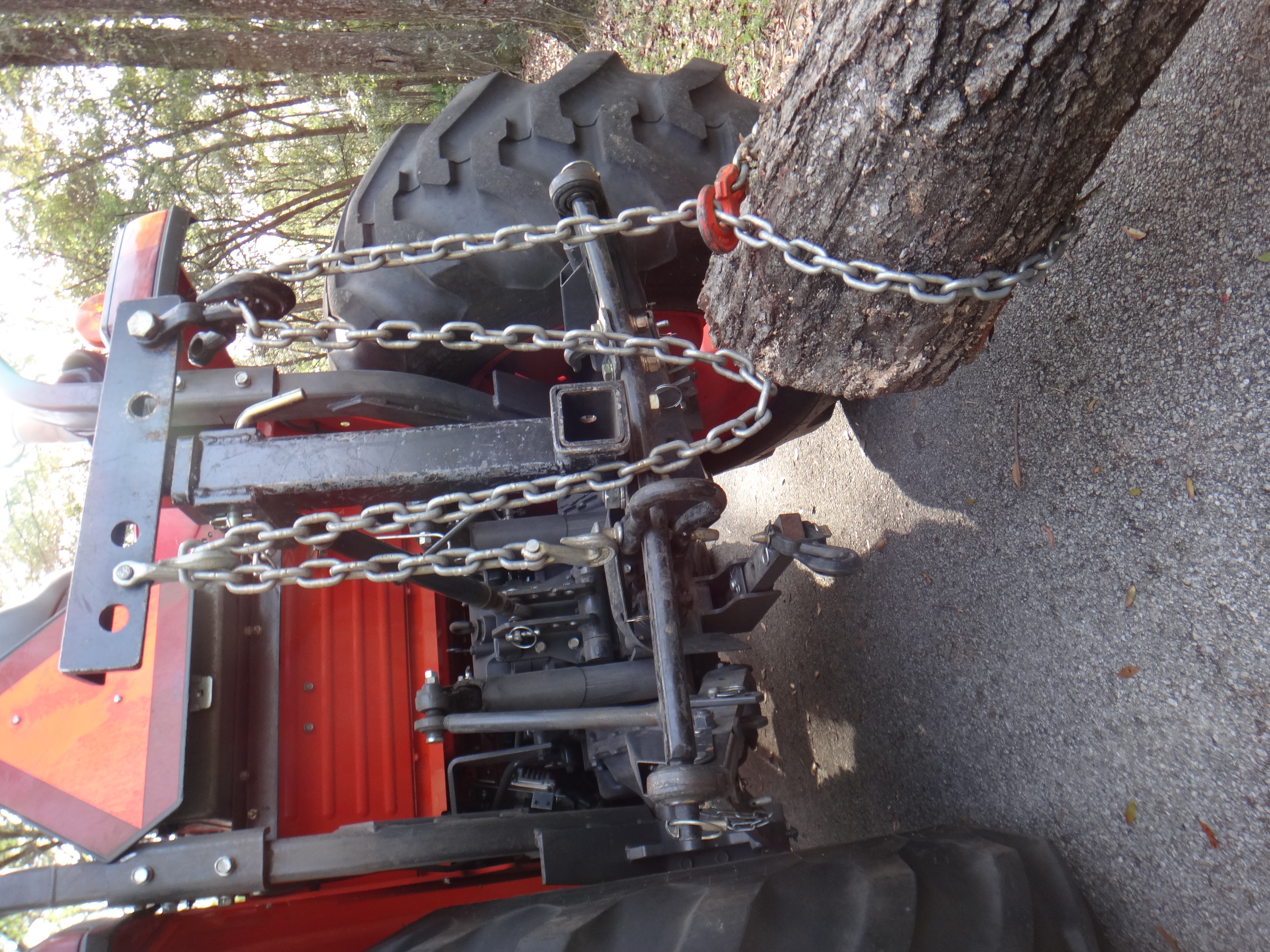

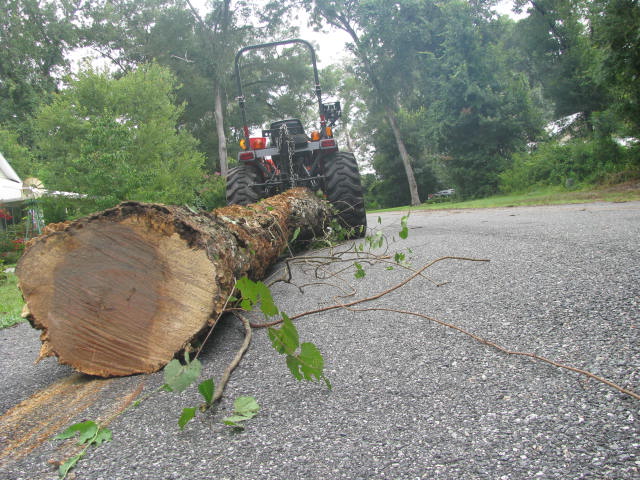

For moving tree debris to a burn pile over ten (10) acres Pallet Forks or towing the trunks behind tractor with chains is a simpler, cheaper solution relative to grapple. PHOTOS

Around 3,500 pounds some tractors will not longer fit under a standard 84" garage door header even with ROPS down.

. Like Jeff said, forks work well for hauling brush.
Well now... Forks WORK for hauling brush, they don't work WELL.
I recently upgrade to a 2019 35HP tractor and went all in on a 66 inch grapple, and there is a huge amount of goodness in a grapple...
1) When working alone, without getting off the tractor you can load the large amount of brush - on the fly, just scoop, clamp and go
2) Brush falls off the dang forks all the time - you will need to take an ATV out and pick up the trail of brush bits... Does not happen as much with the Grapple clamped down on the brush
