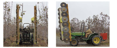

im looking to build something similar to this, to help trim avocado trees. the fab works, looks really simple. need help on figuring out what type of blades ,how to run them and what type of hydraulic motor to use.

I was looking for info mainly , on what kind of hydraulic motor I need to use. and how to i link all the blades together.

good questions. this will be mounted eaither on a ford 5500 or a john deere 5725 .
it will need to trim about 38 acres of avocado trees.
price wise , as long as it is cheaper to build then to buy and import this to mexico.

the blades are heavy duty saw blades. they turn at the same speed as a normal blade. Make sure of this as too slow will cause grabing.
the blades are over lapped to stop jamming.
Easy to mount as replace the bucket on any loader. set it out side the wheel as then can also do hedges. Have a tilt so that it can be changed on the move when the tractor moves due to uneven ground.
The hydralic motor can be spect fron a good supplier.
belt drive between blades.

If it was a belt drive unit, I would think you would need a tensioner between each shaft. But, probably not with a chain driven unit. But again you might, or you will get a bunch of chain slap.
Your sprocket / pulley sizing, along with the mating to a properly sized pump will take some calculating.
Since the blades are offset, would you run the sprockets / pulleys offset also, using a dual drive?
Belt driven would be smoother.
Unless you have already done so, I would be calling and asking some questions. I would ask what the blade RPM is, rotation, belt or chain driven, etc. Blade type and size also.
Interesting build, but you could be buying a ton of parts trying to re-engineer this thing.
This thing will have to be built with some tight tolerances. Having 6 or 8 large spinning blades rotating at 7000 rpm? smacking into tree limbs for hours on end...., having a shaft vibrate loose - someone could loose a head. Ouch.

the thing with this is involves to much man hours, and too much time, i rather am shooting for the box type design as well , but i see this machine cutting my pruning time in half and the man hours as well.

does anyone know what rpm the saws should be running? were could I get the hydraulic motor's . I live in Mexico, but travel to chicago often. hopeing to start building with in the next couple of months.
/ help building a tree trimmer. #17
Go to the home page and in the top left corner click on the add for Surplus Center. They have all sorts of Hyd items
