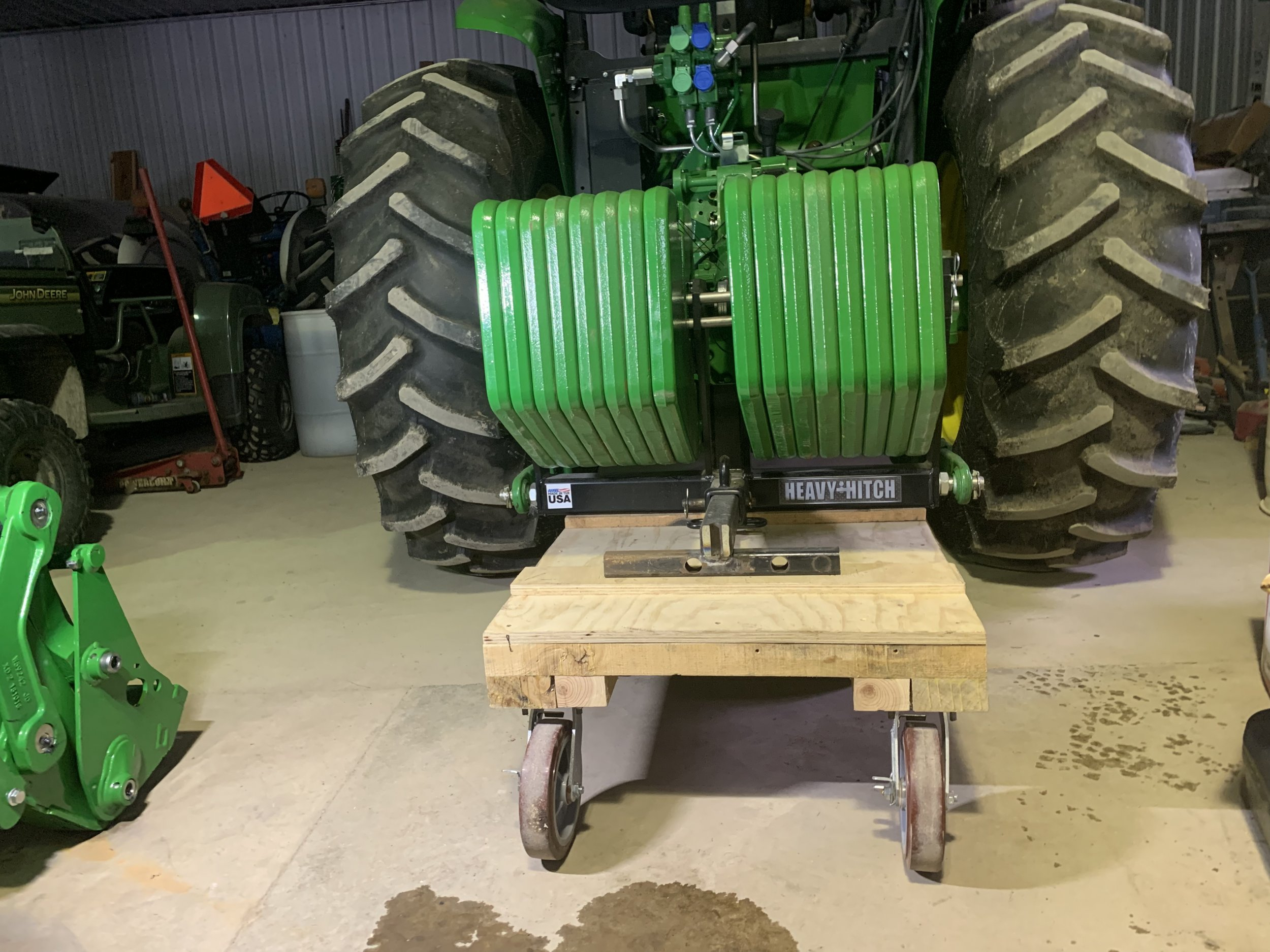

I’ve got a category 2 HH I mainly bought for suitcase weights to use as counterweight and just to store the weights conveniently. Excellent quality. I made the T to slide in the receiver so it would free stand on the HD dolly I also built. Works out real nice 👍

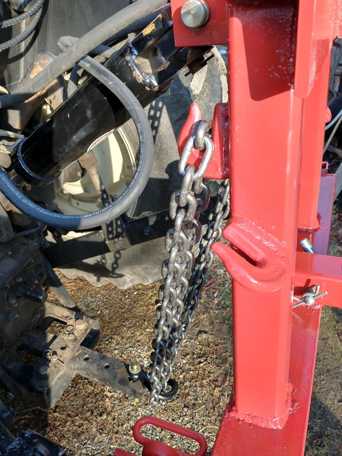

If you are going to use that for moving trailers around I'd recommend a safety chain so that the 3 point can't be pushed up higher then it should go.
You can see my limiting chain going down to a clevis in the drawbar to stop unintended over lifting.

I have always towed from the drawbar, but getting older I might not of done a limiter tied to the drawbar with this setup. Of course I would now!
Thank you for posting this.
/ Heavy Hitch #11
that limiter chain is a good idea, as long as you don't forget and actuate the 3pt lift. I bet you some tractors could bend the draw bar or atleast rip the hook off.
/ Heavy Hitch #12
I have my chain set so the max lift is just starting to pull on the drawbar.
