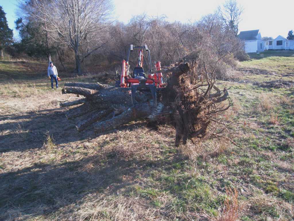

If you want to sift your ground and you have the power, bigger is better.
I have done acres of ground in this fashion, usually try to keep the tines 8-10 inches in the ground. I WOULD NOT WANT TO DO THIS WITH A 48' LIGHT DUTY GRAPPLE. ;)

Agree. Big heavy tractor, grapple underground with unknown obstructions requires heavier grapple construction. No downside to narrow grapple though which would be safer for the FEL arms. Catching a boulder or stump with the edge of a wide grapple while powering forward would put a lot of twisting force on the FEL arms. The task you are doing in the photo is ideally done by a bulldozer which has appropriately engineered short stubby arms attached to the grapple. A tractor Front End LOADER, is not really designed for that type of work. It can do it but will not last as long as a bulldozer because the FEL is primarily designed to lift not push and is simply not engineered for the twisting forces encountered with serious root raking.

Your absolutely right, a dozer would be far better and I should probably make a Rock rake for ours. But I do not have that, but then again I do not have any rocks to hit either, at least not yet. :eek: What I have is root balls in top soil that is left from the fires that went through our area back in 2002. As far as the 48" grapple having no down side, yes a heavy duty 48" would work, but mine is an 81" and gets my work done just a weeee bit faster than a 48" would. ;)
As to this date and 500hours on the tractor although a small percentage of those hours with the grapple, I have had no damage to the tractor or grapple or loader arms. In my conditions I believe that I am fine, but yes if I were encountering big rocks or tree root balls I would be in trouble.

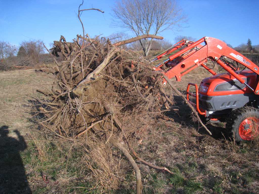

Here is my latest capture with my 48 inch Millonzi (weight 280lbs). I could only lift the stump this high and as my loader is rated for 2700lbs to full height at pivot pins, I'm guessing this stump weighed something close to 3000lbs. If my grapple weighed 500+lbs, I probably would not have been able to lift it and move it.

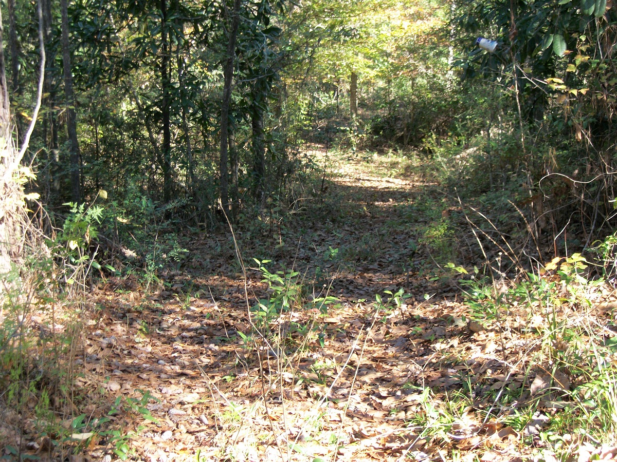

Hey IslandTractor, i've hear ur the "goto guy for grapples" The land, I'm working on is riverfront..soil conditions are soft..flat..and no rocks. i'll be picking up mostly dead pines,clearing small brush which pushes up with just the bucket and clearing trails throuhout property..trying to post pics of brush piles to give you some idea of what i'm dealing with. Your opinion would be greatly appreciated!

I would use a light duty 48" grapple for that work. Benefits over larger grapple are clear: 1) cost 2) manuvering in wooded area, 3) brush sticks together in a grapple so you can lift and transport a six to eight foot pile of brush even though the grapple is narrower, 4) net lift capacity with a light grapple is higher, 5) none of your tasks suggests strains or wear beyond the capability of a light duty grapple, 6) small is beautiful.

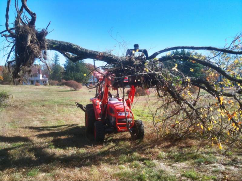

FYI, my grapple is a Millonzi, not a Markham. Note the curved lower tines. Otherwise construction and weight are very similar but I like the better engineered design of my lower tines better. Not sure why Markham/Gator don't do that as they clearly use CNC cutting equipment.
Jake is partially right about the width and visibility. If I take a really large load that I have not bothered to compact, it can have 6 or more feet of dangly brush hanging out either side. The vines sometimes will catch the tires and that pulls some of the brush out of the grapple so I just lift it higher. A wider grapple with brush hanging out the sides would probably not do that except when you made a turn. I only move brush about 200-400 yards so I just lift it and look under the grapple at where I am going. Even with a fully enclosed (nothing hanging over) load of brush I need to raise the grapple to be able to see anything 20 feet in front of the tractor so I routinely raise the grapple so I can travel with better vision. I don't think a wide grapple would be any better for that issue.
