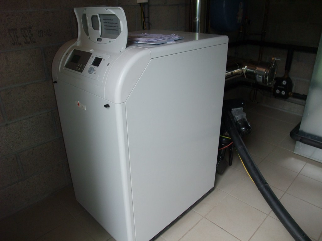

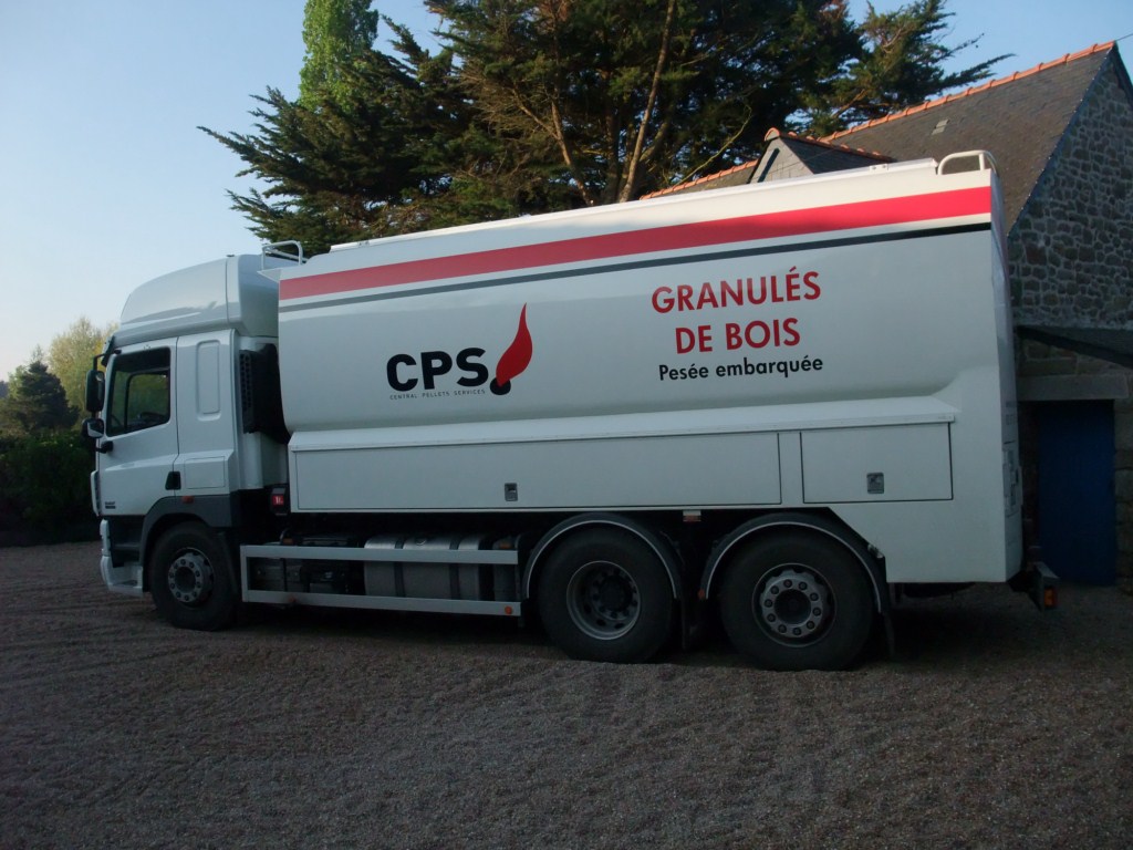

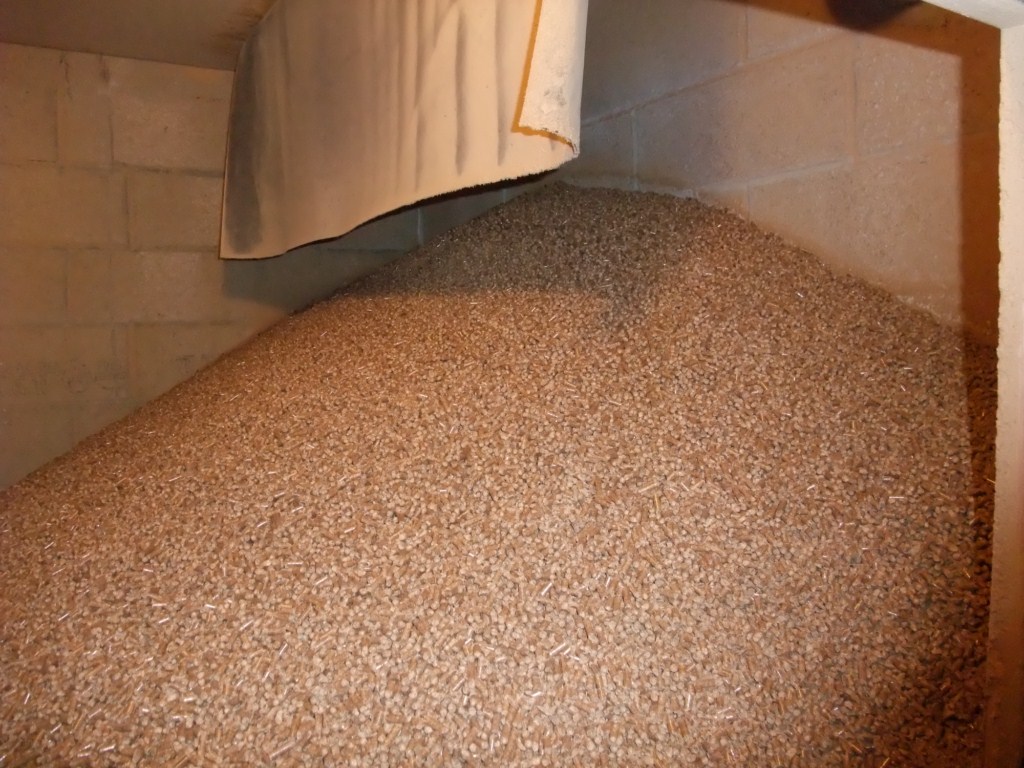

Pellets provide a very clean way of heating a house. No logs to carry to the fire place, no smell of oil, very small amount of ashes (maker claims 95% efficiency and I empty the ash container once every fortnight). No limit to the size of furnace you install, very efficient hot water production. The figures vary from one country to another, but in Europe the cost is less than with oil, much less than propane and much, much less than electricity. Pellets can be bought in bulk (cheaper than bags) and blown into your silo.

I have never heard of bulk pellets here in the US. I go to Hearth.com which is a fireplace/stove site and never heard of that? It may be a Euro thing? After all many of the pellets we make here end up in Europe i have heard. I dont burn them so i dont keep to close of tabs on it but would of thought i would of read about it before if it was availible here. As far as our exports go i have heard we export a good but because of our endless wood supply,and the high cost of energy over there. Also im a forester and we always look at it as an extra market if it would ever take hold and more facilities would be built to manufacture pellets.

Also, unlike Europe, most folks that use pellets for heat use a freestanding stove. There are a handful of furnaces available that use ductwork but they are really the exception. What really is lacking in the US is pellet boilers. I have never heard of one installed in the US. I really think that Europe is ahead of us on utilizing this energy source that is so available in our own backyard.
I have an 1800 SF garage with radiant tubes in the slab. I need to heat the water somehow and a pellet boiler would be the cheapest way to do it on a $/btu basis. If only there was a pellet boiler market here.
We don't have bulk pellet delivery available in my area. That pellet pumping truck in the photo is expensive and I'd bet the largest reason. Also, since we use stoves, it is easier to dump a 40 lb sack of pellets than to try and fill a bucket from a heap and then dump that bucket into the stove. I suspect in Europe that there is some sort of auger system to supply the boilers from the silo automatically.
