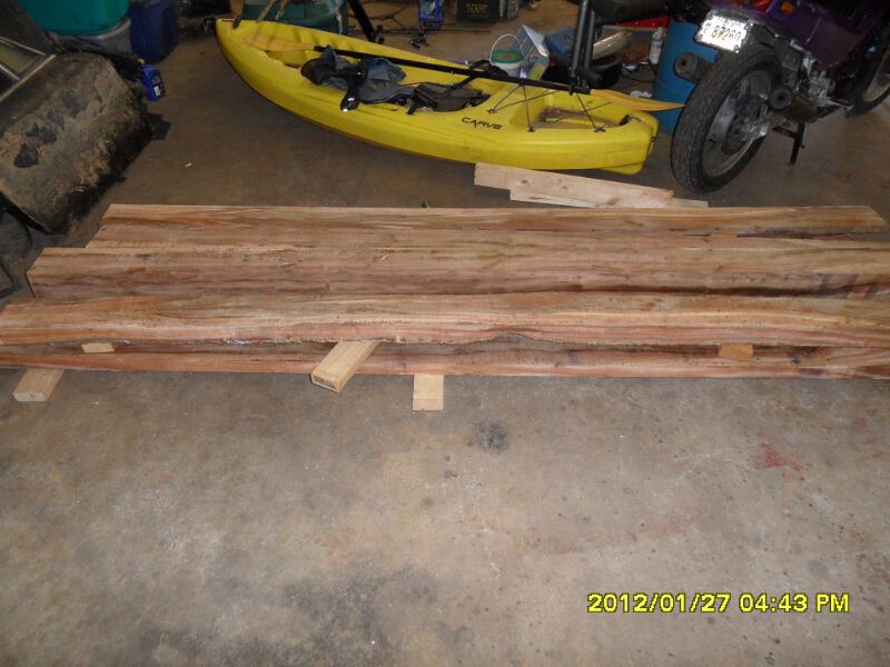

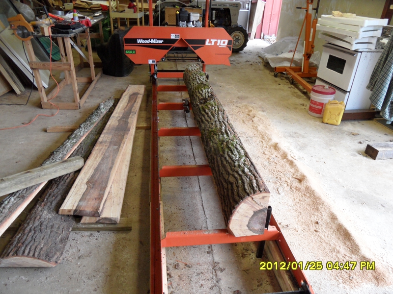

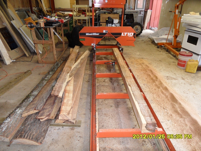

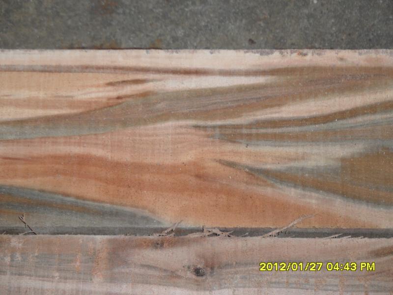

Here is a fuel price calculator. Wood is the cheapest for me, I have electric baseboard heat. Wood is a lot of work, I don't mind it though good reason to get outside and do some exercise. I have 40 acres of mostly poplar, I do cut some; but also get wood in logger lengths (last load 10 cords for $700 for red and white oak).
With that much acreage if you have any use for lumber you should investigate getting a small sawmill.
They generate a LOT of slabs, which burn well.
It's still a lot of work AND exercise, but it sure is pretty after I go thru the process of getting a tree to lay down and split up into lumber.
