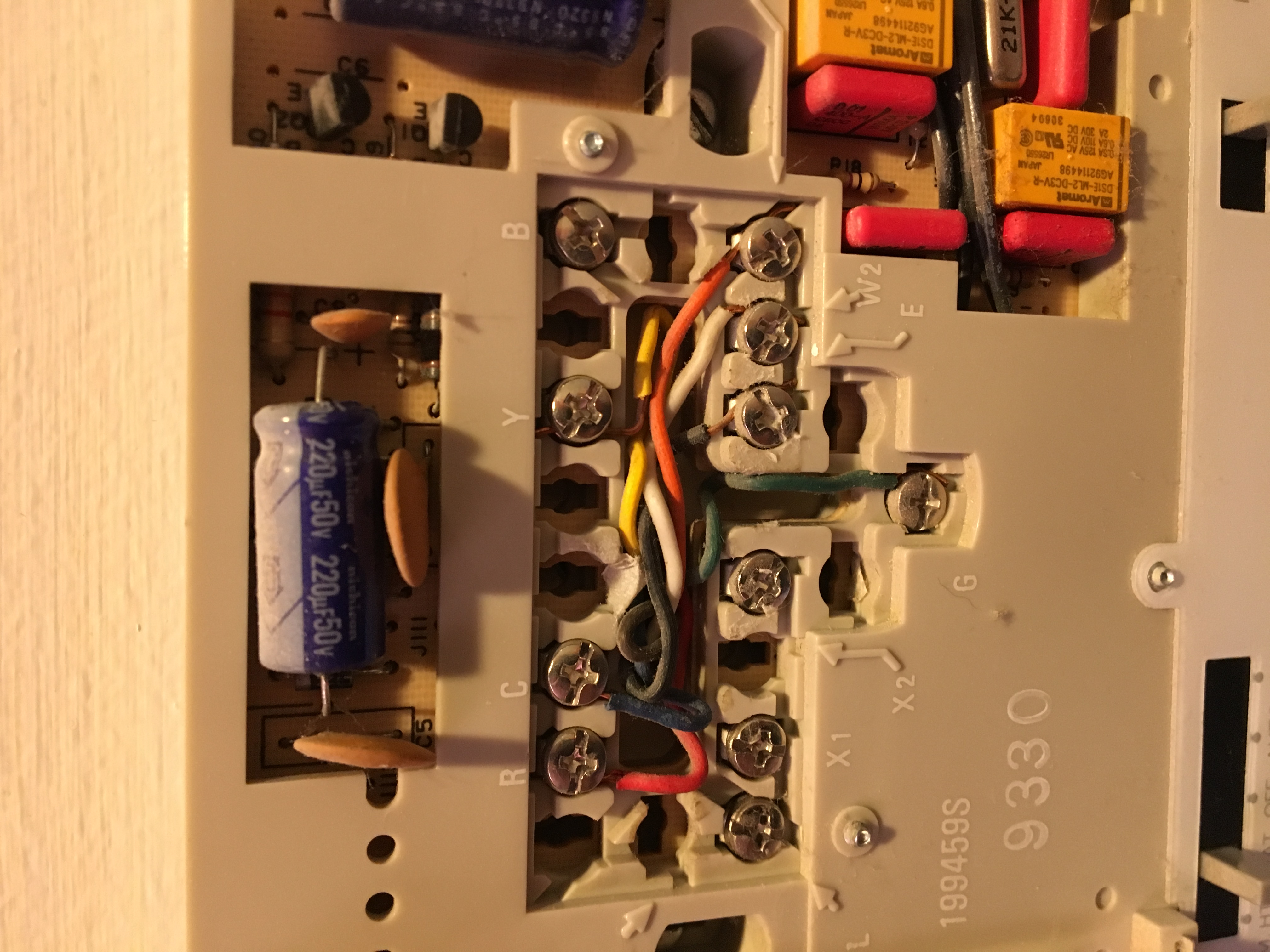

Okay, I did some experimenting. My furnace has a 60A breaker and a 30A breaker. I assumed the 60A was blower, plus stage 1 heat and the 30A was stage 2 heat. I also have a 30A breaker marked for the Heat Pump, I assumed for the outdoor unit. I ran the Tstat up 5 degrees to where aux heat was called for as indicated by an LED on the Tstat and using the power company meter as my gauge, the wheel completed a spin in 4.25 seconds. I turned off the 30A breaker for the furnace assumed to be a second stage of elec heat and the wheel completed a spin in 5.38 seconds. Improvement, but not a lot. I then went inside, cycled the Tstat down and back up 1 above room temp. At this point aux heat was not called for by the Tstat. The wheel on the meter then completed a spin in 17.78 seconds! Big improvement! I turned down the Tstat and checked the meter again. Barely turning, not worth timing.
Is there a wire at the Tstat that disables aux heat?
EDIT. I guessed W2 and appear to be correct. Heat pump operates when aux heat is called for and my meter is still spinning at 17.98 seconds. So I will see how this goes. Wifey saw me at the Tstat and I asssured her she could still change the set point and that I was just trying to save money. She is ill now so I want her to be comfortable, I just need to keep my elec hill under control.
I think you will find the 60 amp breaker IS the aux heat. Should be labeled on the panel but try turning that one off and see if the heat pump/AC still works.
The E terminal at the thermostat should be the emergency heat.
