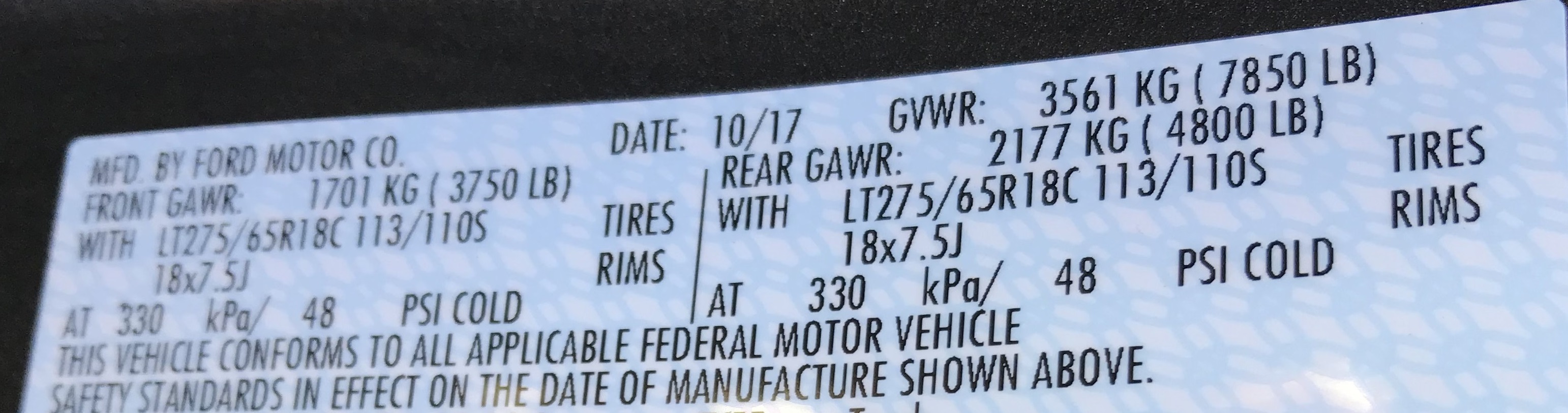

Quick update after a pause in my truck search...
I finally found a 2018 F150 HD on the lot that was a reasonable drive from me ~45miles and optioned appropriately.
My intent was only to check it out / drive it etc. so that I knew what I was getting into before eventually ordering. I loved the ride. It was certainly a firmer ride than any other 1/2 ton I've been in but not jarring in any way. I ran it on highway, pot holes, wash board and some gravel. It was quiet, smooth, no vibrations, no roll in corners and got good fuel mileage on my test loop with the 3.73 rear (at least better than my Jeep GC).
Of course, afterwards they wanted to talk numbers. They asked me what they had to do to make the sale. So I gave them a number that was $2,000 - $3,000 South of what other dealers were willing to do if I ordered a truck. I knew full well that they wouldn't go for it...
I was wrong! I think I'm buying a truck now :laughing:
Seeing the truck in person allowed me to check all the important numbers - which are similar to my old 1999.5 F250 PSD.
Payload right at 2399 (2,450 for 1999 PSD). Hitch rated at 12,200 / 1,220 weight distributing and 5,000 / 500 weight carrying (10,000 / 1,000 WD and 5,000 / 500 WC for 1999 PSD). Curb weigh is only 900 pounds less than the 1999.5 PSD and much of that difference must be the diesel engine.
I've attached pictures of the stickers. The 2399 payload is for crew cab 4x4 HD payload, 3.5EB, 301A, running boards, TT mirrors, Tailgate step, FX4, LED box lights, remote start, Sync 3.

I have a 2013 F150 HD, and what stood out from that sticker is the difference in tires and PSI. Mine came with 245-75-17E tires with a sticker PSI of 55 front and 60 rear. I see yours are 18C and only 48PSI. Not that mine rides rough, but your tires must give you a softer ride for sure.
   / HD F-150 or 3/4 ton truck? #300
Mine is a 7040 GVR rated 2017. I think the door jamb sticker is even less for the tire psi, maybe 35 psi. I think you will enjoy it, I really like mine. Post up a couple of pics if you get the chance.
