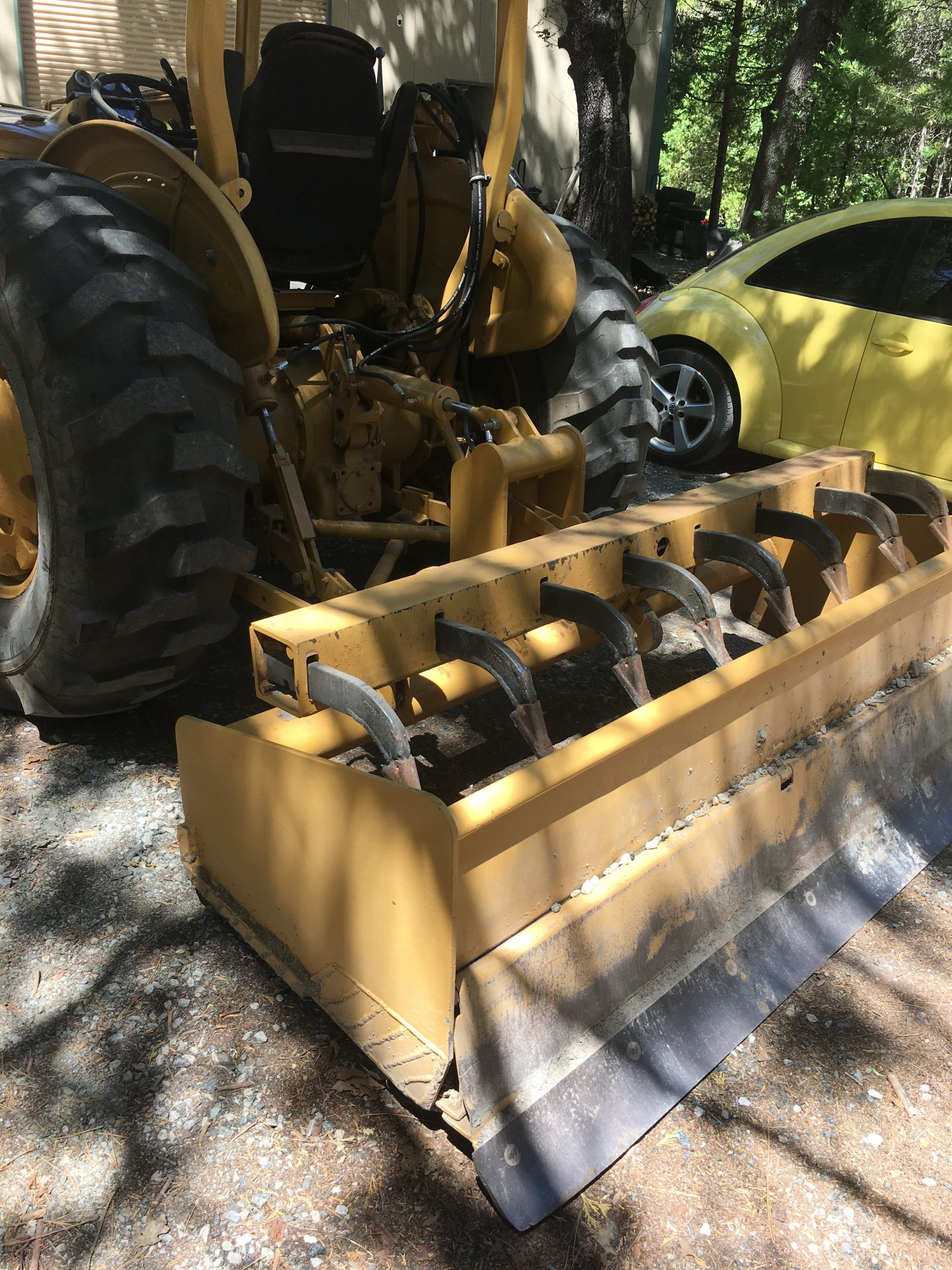

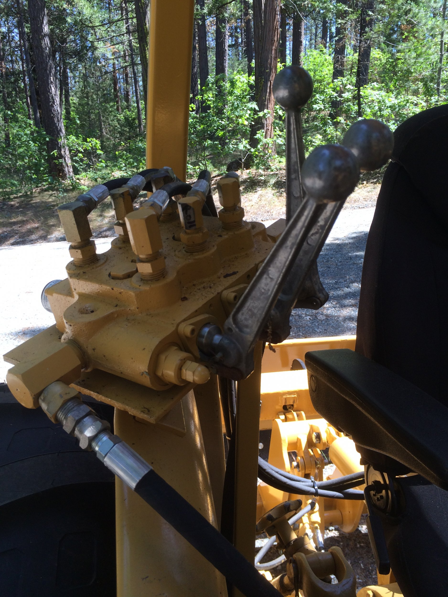

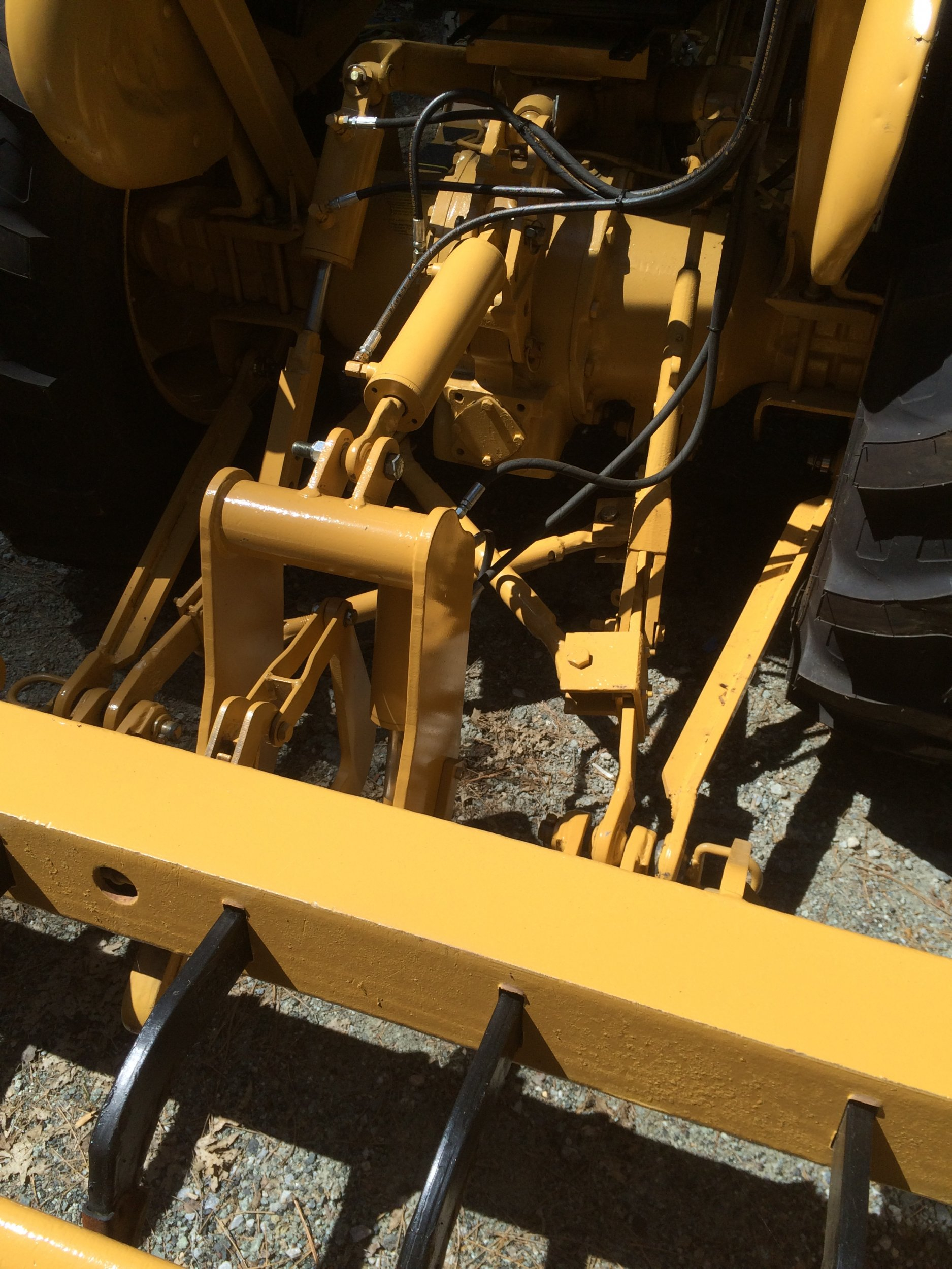

I have used Gannon boxes for 40 years in my business, they are pretty good. I had several Case 570lxt and older and newer. For my home use I restored this old Gannon mounted on Ford 445a.
I like wheel weights plus liquid filled tires ( beet juice these days). Once you put the box down the back is pretty light weight.
You can always make your own valve arrangement. The offset lever is the ripper. I am also going to make linkage for the side tilt so the lever swings left and right. Just to different.

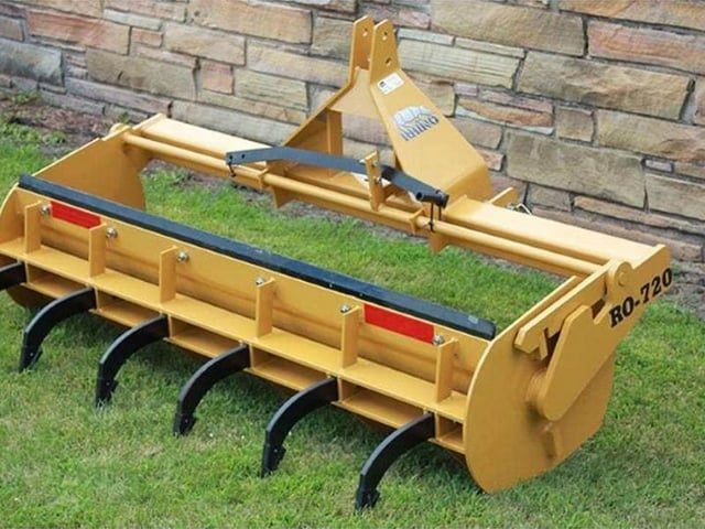

I looked into roll over BBs after seeing it here and think that's what I'd like but those babies are expensive! And it seems like no one really makes them anymore. I don't understand why unless it's that the costs are just too high for most of the market.

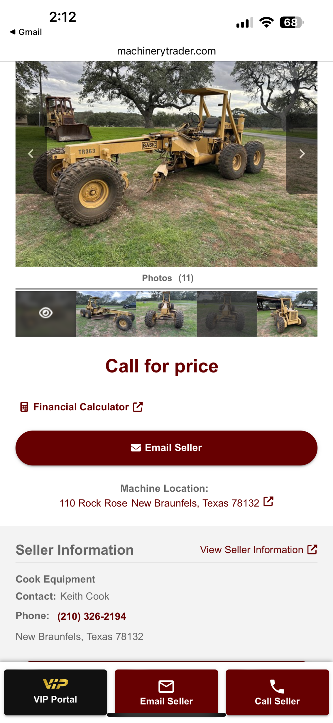

For that much road this is the ticket. Probably can get a decent price on this one. My road is only a mile and I just bought a Champion 720a series 3. Keep in mind that grading requires proper moisture and compaction.
/ HD box blade? #40
I'm not I'd be able to pull that with my tractor. :)
You don’t have to it’s self propelled. My time is valuable to me, with one of those it’s much faster and cleans ditches better. When you have to re-establish the crown it is so fast. I still have my Gannon scraper box tractor for certain things where the grader doesn’t fit.
