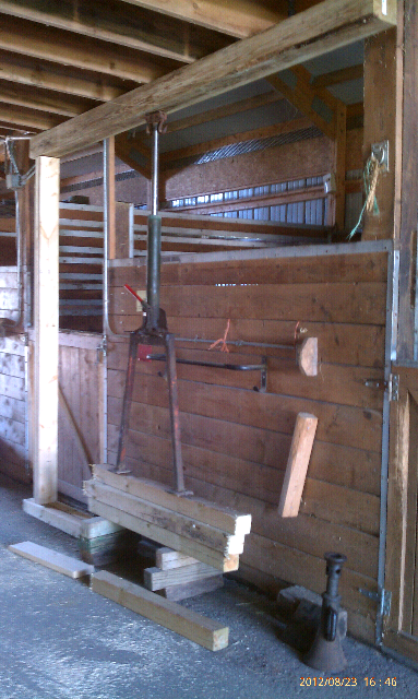

So you are saying that YES they were nailed that way??? The length of the diagonal nails is what is important in that representation. You are basically "toe-nailing" the joist to the header with the hanger being a guide for that toe-nail (as well as adding strength to the connection). FAR too many times, I see shorter nails used because people think that the hanger is all that is needed to make the connection. But the criss-crossed toe nails are VERY important.
If you look at the end of the joist that pulled out, you should see about an inch or more of nail sticking out of the end that should have been nailed into the header. Are you seeing this?

I understand what you're saying, but I didn't look that close. The nails might have been of appropriate length but I can't say one way or the other. But it wouldn't really surprise me if the nails were wrong. There were other stupid things done. The hangers were shorter than I think should have been used.
As other's here have stated, I sure wouldn't use hangers. I would have used a much stronger carrier system bolted to the posts and have placed the joists on top of the carriers. I probably won't be back there for a week or two.

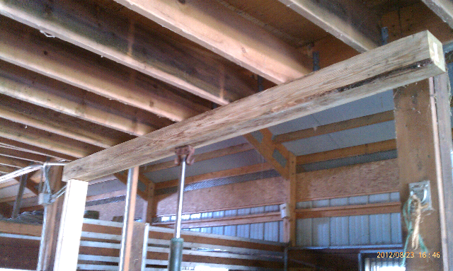

but I would of rented the larger Bobcat series where one is protected by sudden failure of joists if they suddenly failed
while it placed beam in place to use full length joist jacks with screw jack on top.
As others said - jacking joists up 1/4" at a time per day lets building members to slowly absorb the change.
4 post jacks in 8 foot span until level.
I've recovered similar damage to homes like this from flooding long term damage.
1/4" steel 6" x 4" steel angle could be altered in for joists to sit on - trimming ends of joists to fit the steel angle in.
I'd still remove the hey load to half height. So building can recover from extreme pressures.
Seeing those joist hangers as the only support - was scary -

Perhaps the best way is to use several basement support
jacks (the type that you use to support an open span in a
basement to support the upper floor joists at the outer edges
and using a double layer of two by sixes along the entire length
on both sides.
This is not safe condition in any case as the entire floor could fall in
on one side dumping all the hay and possibly causing harm to a horse
or a person.
The time consuming part will be digging holes for sonotubes to pour concrete
to support the posts to support the joists at the ends.

The problem is not a lack of strength in the vertical members, it is a lack of support in between them. Probably bolting a pair of 2x12s that are glued and screwed together with a piece of 3/4" ply in the middle to the uprights right under the joists would do the trick.

Wow, interesting thread. Wish I had found it sooner. The Amish barn builder will get it right, for sure. I'm in the middle of building my barn so barn threads are always good-reads. It's sort of late to the party, but that whole loft looks underbuilt for the amount of hay (6-7 bales high at the peak) your daughter put in there. I know it's been stated earlier in the thread, but I like calcs, so here goes:
By my calculations, 1 bale is around 18" x 36" floor area & 50-60 lbs --> 60 lbs/4.5 ft2 = 13 lbs/ft2.
At 6 bales high that's 80 lbs/ft2 live load.
Total load = live load + dead load (average 20 lbs/ft2) = ~100 lbs/ft2.
I can totally understand why the 2x10's supporting the loft joists bowed out under that load. The loft decking probably kept them from spreading on the top half, but on the bottom half, where the joist hangers are, the 2x10's just twisted laterally. It's amazing the whole thing was still supported by that conduit and the decking.
On the barn I'm building, I designed for "only" 70 lbs/ft2 in the loft and I used 6x12 glue-lam girders to support 12" wood I-beams (BCI's) 16"OC. The girders are resting on vertically oriented 2x6's bolted to the posts with 3/4" bolts. (True, I did use metal hangers for the individual BCI's.) Example 2/3 down the page:
