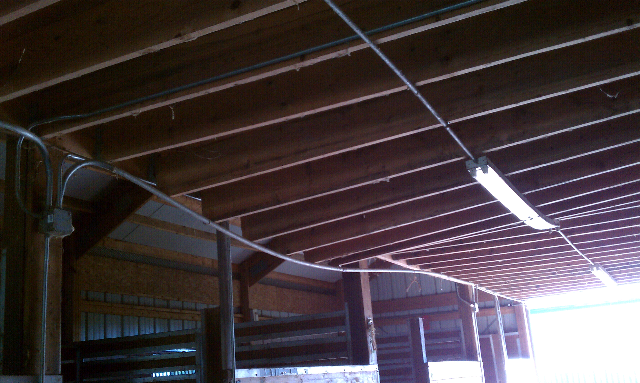

Here's a pic. The loft is independent of the trusses. It is built with doubled 2x12s nailed to the aisleway posts. The posts are laminated tripled 2x6s, 12 foot on centers. The loft floor joists appear to be 2x12s 16" on center, 12' long. The floor joists are fastened with hoist hangers.
The failure is about in the middle and spans one 12' section between posts. It looks like the only thing holding that section up is the conduit and maybe some lateral support of the now angle joists on the beam.

If you can, take a few more pictures, specifically the rim (the doubled up edge)
and all posts. ALSO, the floor above, take pictures of the floor sheathing and how
it was nailed, or was it nailed? ALSO, at the caved area take a close up of an end
of a joist and a hanger. How many nails and what kind of nails were used at each end?
Are the posts on cement or just in dirt? If you can change the camera
settings to large format too.
Are those 2x12's on 16" centers?
It almost looks like the rim bowed out.

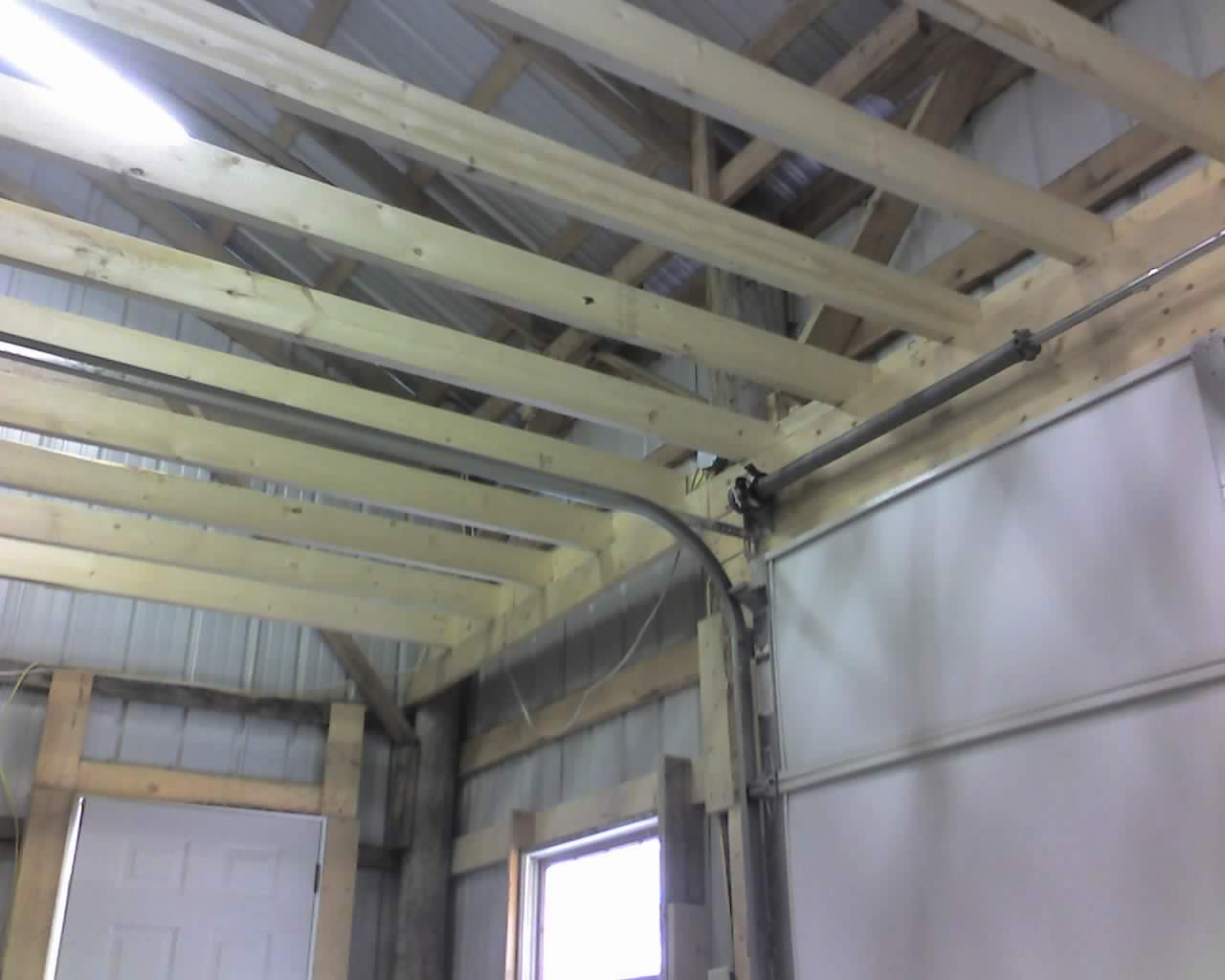

I know it is hard to see in this picture, and it isnt exactally the same, but this is what I am talking about. (setting the joists on a ledger/header board) joists.jpg
I know I didnt use joist hangers either, but this floor dont need to hold up and significant weight either. But notice there is a header the joist is setting on, AS WELL AS one that it is nailed to on the end (where you would use a joist hanger).
If this loft were built that way, there is no doubt in my mind (provided the posts are up to par) that it would hold the hay just fine.

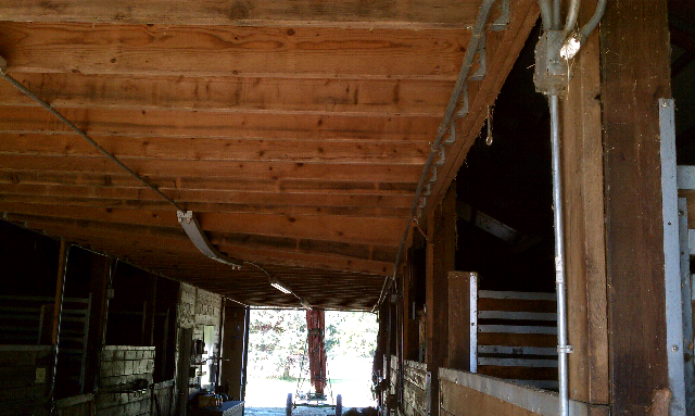

The barn is about 36x72. The hay is stacked to the peak across 48'x12'. She was going to fill the other 24' x 12' area as well, but that's not going to happen now.
We are going to build some temporary support under the sagging area and take the hay out. Then we will get someone in to fix it.
The doublers are not bolted to the posts, just nailed as far as I can tell. The plywood floor is nailed to the joists. It appears that the doublers are bowing down in the middle of some spans and splayed out which probably pulled the joist hangers away from the joists.

I bet the hangers are screwed instead of nailed

Hay has been stored there before, but maybe not stacked as high and dense as this. The owner knows that she has been putting hay there. I don't know if specific permission was given but he didn't tell her to stop doing that.
I agree that I wouldn't build it that way either.

I would say that it is a combination of improper technique, and insufficent header board.
I dont have time to play with numbers right now, but at first glance, spanning 12', there should probabally be 4 2x12's for the headers for that kind of load, and PROPERLY fastened.
It also appears that the joist hangers arent the right size. If those are indeed 2x12's, those look like 2x8 hangers, probaballt tor short of a nail (they are supposed to criss-cross and tie into the header), and not that it matters and didnt cause the failure, but it dont look like the little tangs of the hanger were hammered into the header.
12' x 48' is 576 sq ft. and if your estimate @ 60#/bale is accurate, that is under 80PSF. The joists should carry that just fine. But as you are finding out, everything else ALSO has to be adequite to carry the load. If the header or posts goes, you could have the strongest floor in the world but it wont matter.
