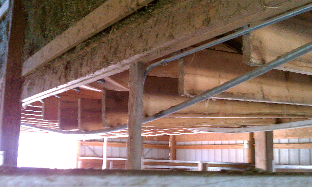

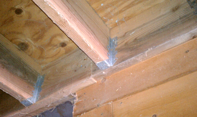

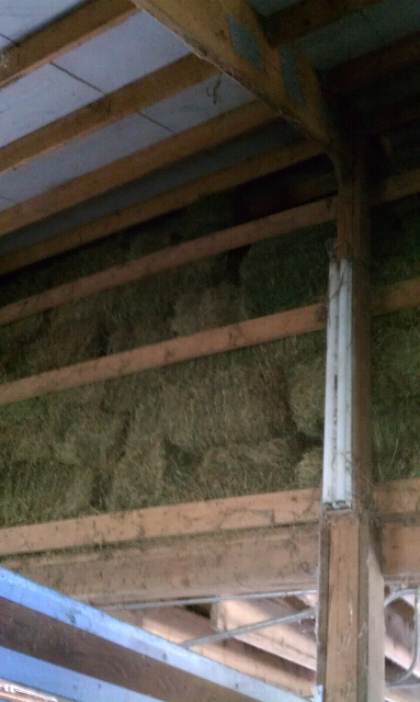

I would try to get rid of the weight without ever being under the failed area. It could suddenly collapse without notice since the connectors are already failing. The area below the sagging joists is extremely dangerous and not worth losing a life. After the weight is out, the failure can be evaluated and corrected.
/ Hayloft is Crashing Down! Help!
#22

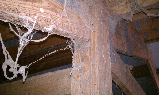

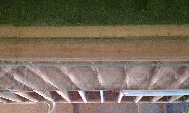

Correction. The rim is a doubled 2x10, the joists are 2x10s, 16 o.c.
What I see that may not show well in pics, are the rim is bowing down in the middle and splaying out.
I'm a little reluctant to put pressure trying to shore it up for fear the remaining structure comes more loose or fails.
My plan is to build support first on the opposite side that has bowed down, using a 14 foot 4x4 under the joists, supported by 3, 4x4s, one at each end and one in the middle, with a 2x4bottom plate laid on the black top aisle floor. Then build the same on the other end where the joists tore loose, jacking the 4x4 up with a barn jack. Maybe not jack them all up level, but get the middle 4 or so joists supported flat by the 4x4. Then support the 4x4 temporary beam with 4x4s .
Then add cross bracing. Then go up in the loft and take some or all the hay out, until permanent repairs can be done.
#23
If I remove the weight first, what happens if it crashes while I'm up there moving hay. I could get crushed in that process too. I guess I would stand a better chance than if it collapsed while shoring of up.

2 x 10s @ 16" c/c do not support the kind of weight that is being placed up there. That is a typical framing for a house. Probably could double the # of joists (8" spacing) but you have to have adequate support beams and columns to carry the loads. Talk with a (gulp) engineer...a real one. ;)

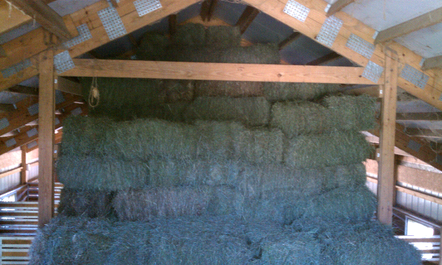

Them being 2x10's changings things a bit. (well, it dont really change your plan of attack for correcting the issue). But 2x10's on 16" centers and spanning 12' is only good for about 60psf. So it does indeed look like it was overloaded for how it was built. But again, this is all based on the "estimated" weight of the bale. IF off just a tad, say if they really are 65 or 70#, that is huge with that kind fo volume.

You are right that thing could blow out the sides like crumpling a pop can. So be very careful in there as you have mentioned. Shoring up and spanning the beams that are bowed would be first order of business before trying to remove some of the hay. Myself would almost be tempted to get a decent tractor in there and raise the bucket up to hold the beams then yank out some of the hay.. which is still pretty risky..

Those bales are probably alot closer to 50 lbs, and not properly stacked. Odds are pretty good that the loft coming apart was good thing since they have to unload and restack. Hay stacked that tightly has led to more than one suspected barn fire.
