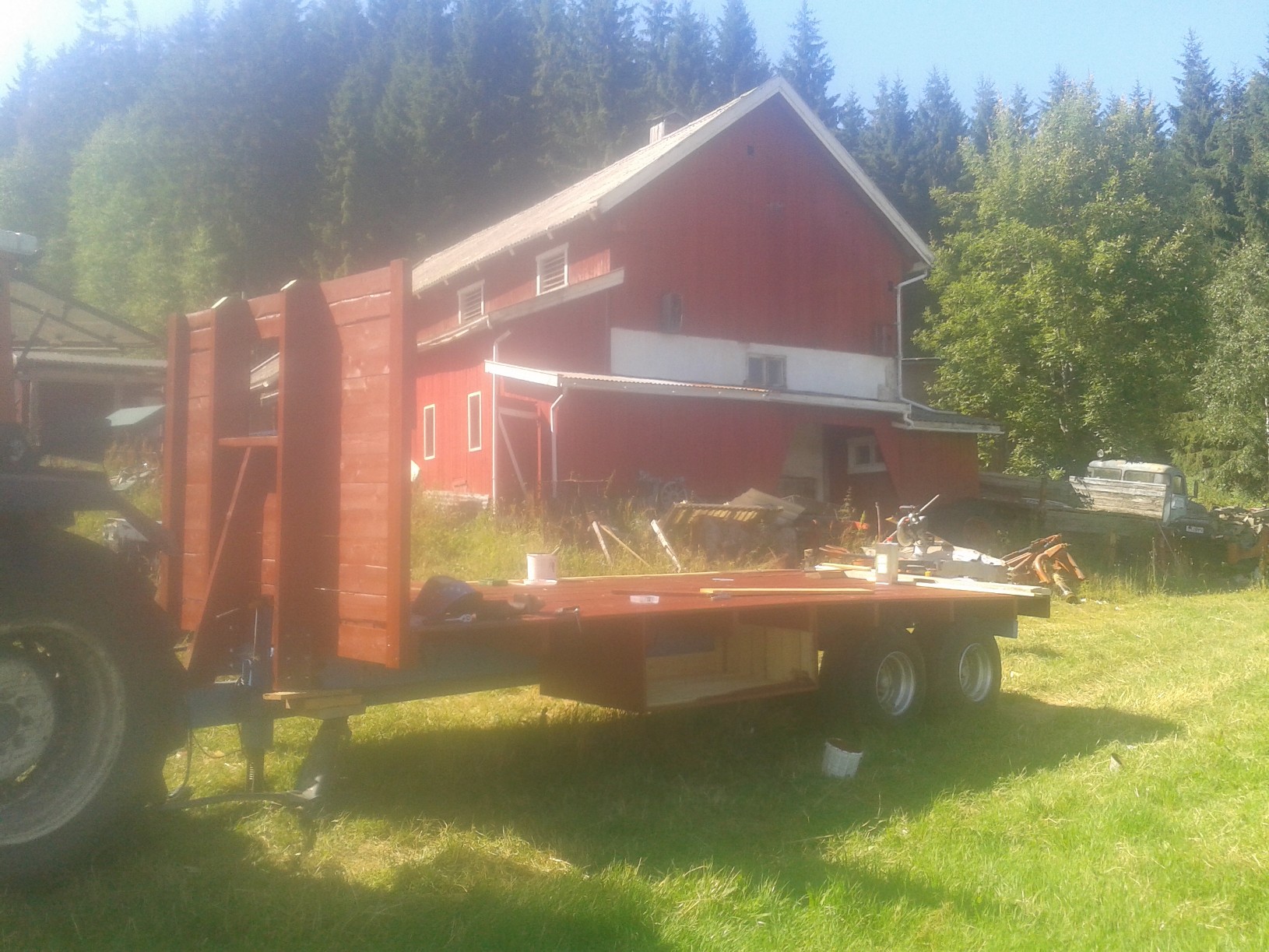

Pretty heavy duty Tor! What will go in the box along the underside of the deck?
Storage for straps to tie down the load. Frame is built for 14 metric tons
