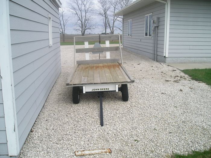

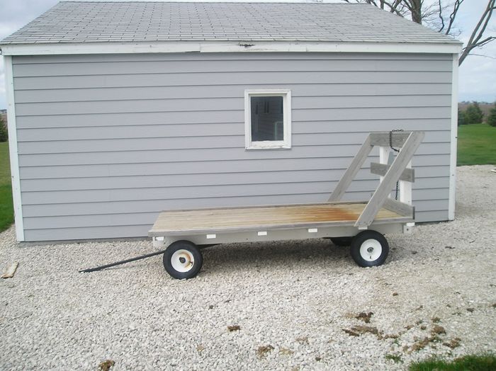

   / hay wagon floor build
that seems very simple to make, but would it be strong enough on the ends of the 2x6's?
the only reason that I questioned the strength is because I saw these pictures from another thread that looks a lot more complicated, and didn't know if there were any big advantages to that slightly more complicated design.
   / hay wagon floor build #8
We used to build them that way about 15-20 years ago. Personal preference, I guess? Ken Sweet

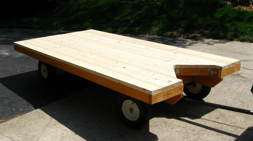

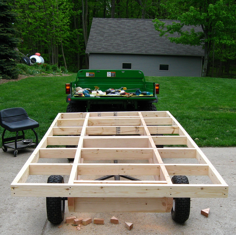

   / hay wagon floor build #9
That is the same running gear that I bought years ago. I used a 9 foot long 2X6 for the runners on mine, then laid 54 inch 2X4 stretchers across them and 5/4 decking for a floor.
I've seen the floor boards laid vertical and horizontal, is it only personal preference or is one way stronger than the other?
#11
how did you anchor the 2x6's to the frame?
   / hay wagon floor build #12
There was a tab standing up with a hole drilled in it, welded to each corner just a few inches away from each tire. I had to use a 2X6 on edge to get enough height for the floor to clear the tires.
Your question about which way to run the floor boards, I guess it would be mostly personal preference with this size of wagon. I ran mine front to back but most of the hayracks I remember as a kid the floor ran side to side. They let more of the hay chaff fall through the cracks making the floor not as slick to walk on.
