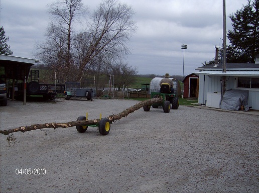

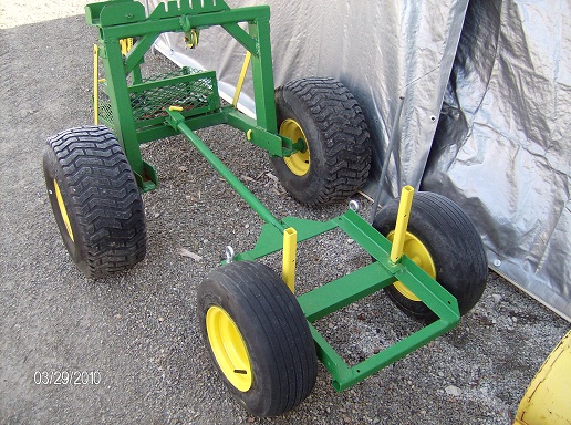

With limited time to skid logs get them cut and staged next to the trail while its wet then when it freezes all you have to do is haul. Also when my great uncles used to have work skidding they would pull a log crosswise behind them and it would pack the snow down and after a day or two in cold weather it would make the snow hard enough to haul on.
Coboy Billy, that old Farmall Cub looks real bad azz with the wide rears. :thumbsup:http://photos.cubfest.com/albums/userpics/10036/IMG_0557.JPG
What size are those rears - are they on the sock rims? Wouldn't mind having wider rears on mine...
Thanks Easygo
Thats a 1957 farmall 130 and one of my favorite tractors. But I do have a cub too.
Howdy Code54
Those are 14.9x24 rears and its on 15" rims but it would have worked better on 13" rims. I have another farmall 130 with 11.4x24 and a 100 with 12.4x24 on stock rears. The 12.4x24's seem to be the best for me. On a cub 9.4x24 is as large as you want to go.
That wagon was a old grain wagon I got for $100. I picked up a newer wagon for $300 and built racks for hauling logs but I had to use a bigger tractor while the 130 would haul it it just did not have enough weight and brakes to do so safely.
Billy

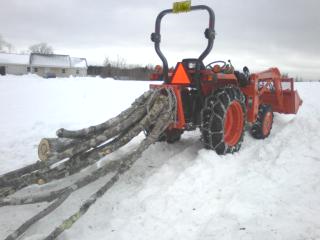

I talked to the sawyer in Maine, and he says frozen ground is very good, but frozen with some snow is even better, as far a dealing with mud on the logs. A woodcutter friend who uses horses is suggesting I find a way to use a Farmi winch, maybe rent one, as they sure make twitching out the logs a lot easier.
Recalling how old timers moved houses with rollers or how boatbuilders launch huge vessels on a greased track, this log moving work I have to do also comes down to friction. If there is limited friction as with the roller or the grease, the object moves easily like Cowboy's wagon. There is an Ag fair in Maine called Common Ground, and their woodlot is managed with a wagon, pulled by a tractor, and the wagon has a loader. Another good rig.

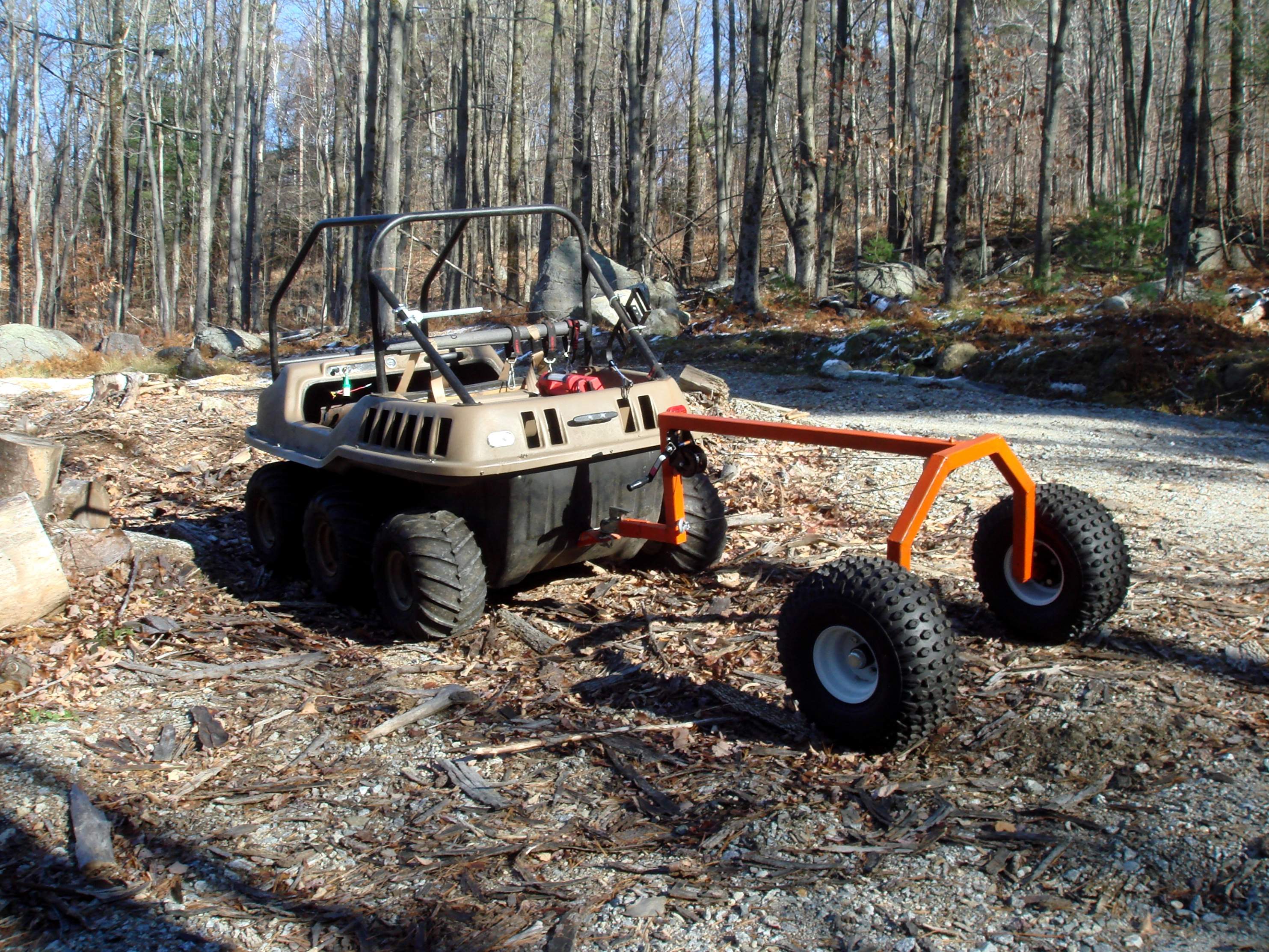

A little off topic, but since you bring it up - The Plant Manager & I took a drive in 2010 to go see the MOFGA / Common Ground event. Had a great time. Really enjoyed watching a horse drawn sickle bar mower and a horse drawn potato harvester. They also had a crew demonstrating how to hew beams from logs - lots of fun!

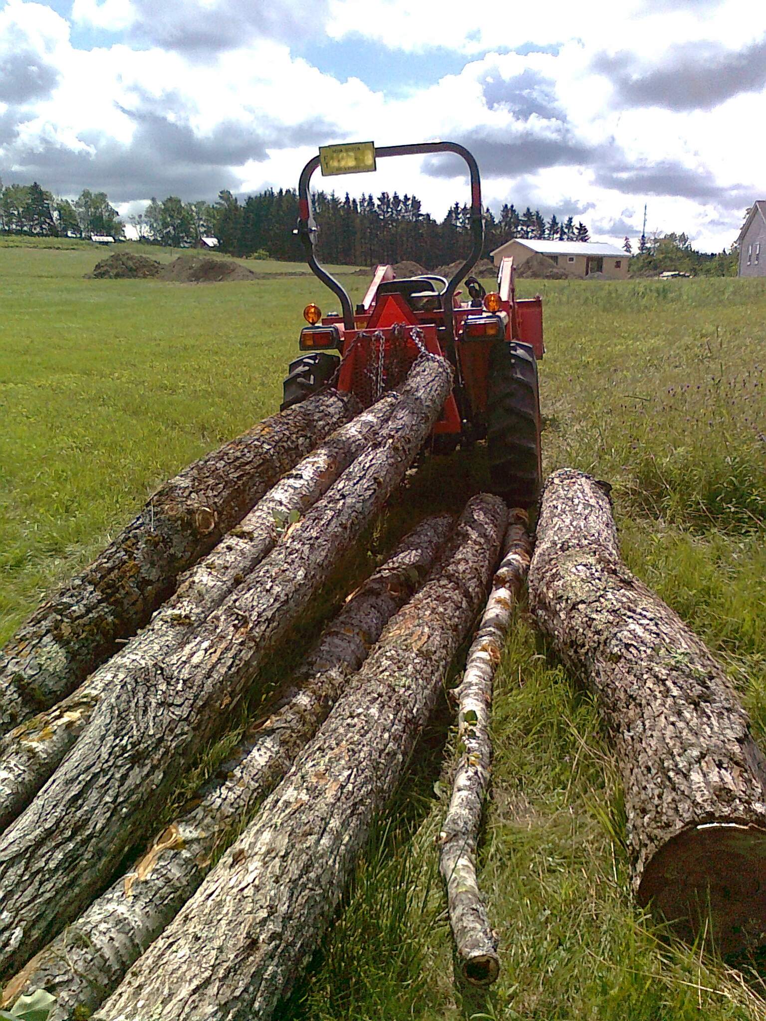

I used my BX23 to help neighbor clear his lot. Mixed hard and soft wood. Biggest log moved was a hemlock about 21" at butt and 20+ ft long. Set tractor and used backhoe to manuver logs over stumps and pull them up to where they could be twitched to bucking area. If I lost traction I'd drop the log pull ahead tractor length plus 2/3 ft set up and pull log up with backhoe. Kept bucket 1/2 full of dirt as counter weight.:D

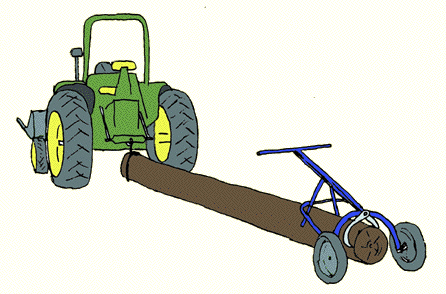

"A quick hitch could be used to lift, secure and control the butt end of a log. Cat 1 QH is 27" wide so your logs would fit nicely.
Then place a two or four wheeled fat tire dolly toward the middle of the log. Probably would have to be secured with chain and binder. Then tow away."
I came across this image on a logging website... and Logrite has a variation in a video with a larger arch up front and a smaller arch at the rear of the log.
My guess is that this approach might work fine but I would be careful to chain up the log so it does not roll.

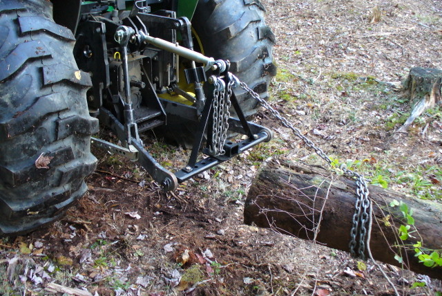

I have an older JD855, 24hp, hydro, turfs, and only weighs about a ton.
When I skidded a bunch of timber the last two falls, I used the trailer moving receiver hitch I built to bolt to a 3pt draw bar. I moved timber the size you mentioned with no problem.
I backed up tight to the log, and picked up the end with the chain hooked to the top of the arm the top link hooked to. Once off the ground, I chained the log up close to the draw bar. That is the chain on the top link arm only lifted, and the chain on the draw bar pulled.
There was enough slack in the pulling chain that the log rode a few inches behind the draw bar so turning wasn't a problem. And yes, it was a little more time consuming to do hook ups and unhooks..........
A factory receiver hitch adapter cost something like $200 and up. I think I have less than $40 in my attachment, including paint........
Good luck with that lottery
Here's my hitch ala Wyobuckaroo & 300UGUY (sorry for the blurry image):

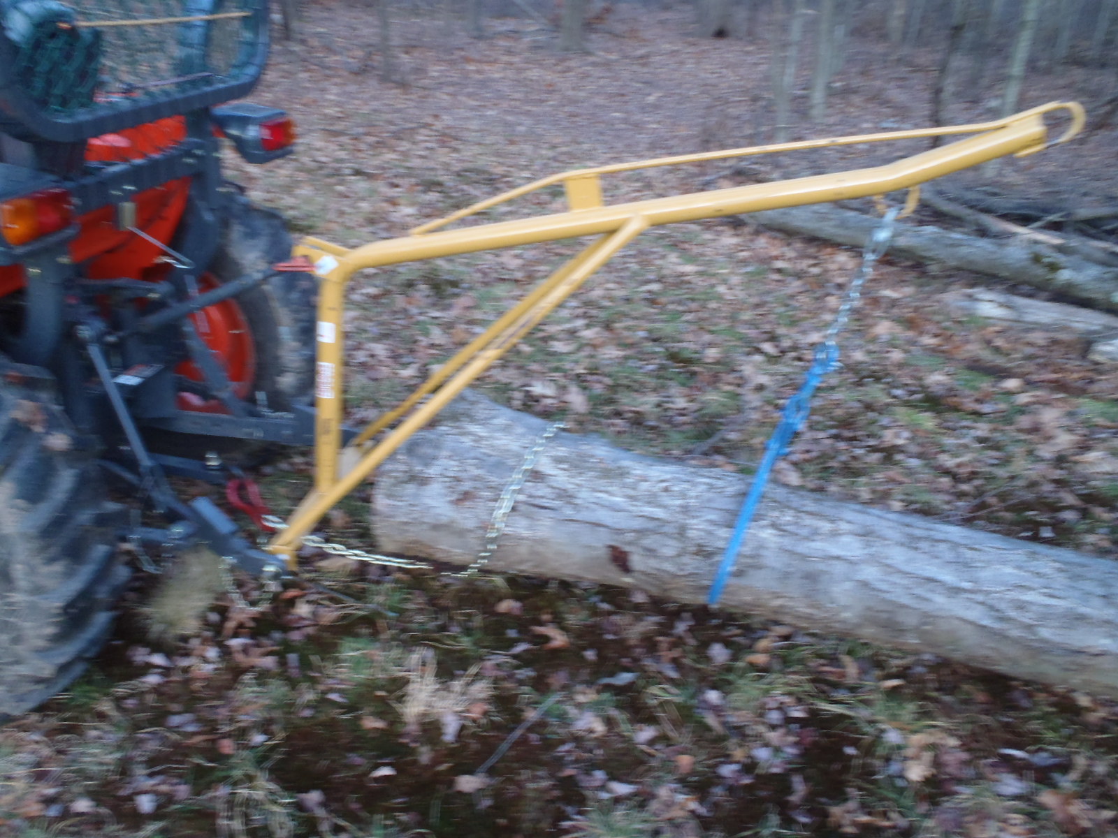

Easygo's idea is probably the most economical.

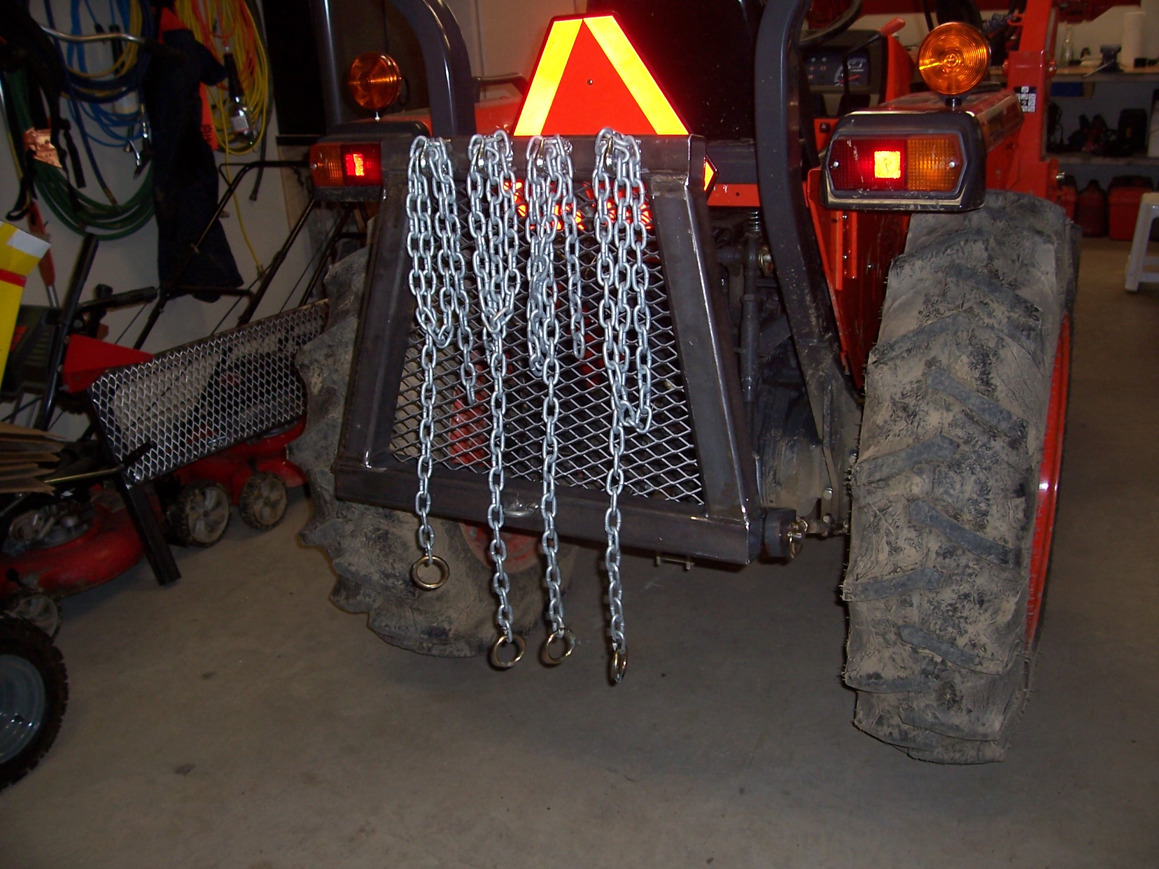

The photo shows a rig that I made that goes a step further. I bought a 3 Pt drawbar from Tractor Supply, a Drawbar Stabilizer from Northern Tool, some flat bar, and a pair of grab hooks from a hardware store. I have mostly used it for waste logs that were smaller than the one hooked up in the photo. If I were to haul anything bigger, I would be sure to carry low, and to have it hitched such that the drawbar would stop it from coming forward.
Another benefit to the Drawbar Stabilizer is that it includes a 2" receiver. I put a ball mount into it when I want to move my utility trailer around with the tractor.
I bought my used tractor with a backhoe on it. I got the 3PT arms and all except the top link (which I replaced from Tractor Supply). However, I did not get the original low drawbar. I may see If I can get one made someday.
Go carefully, and you should be safe.
