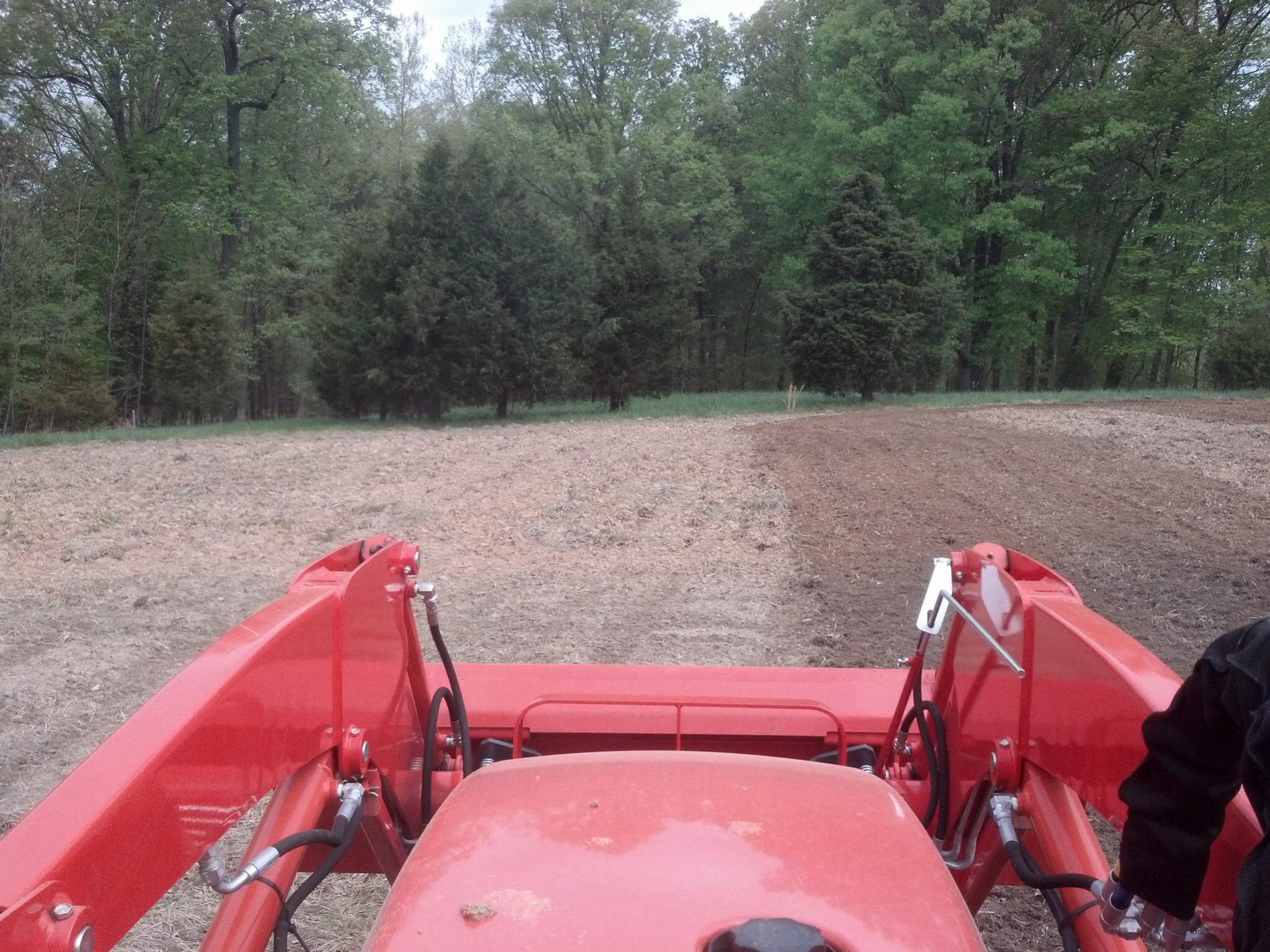

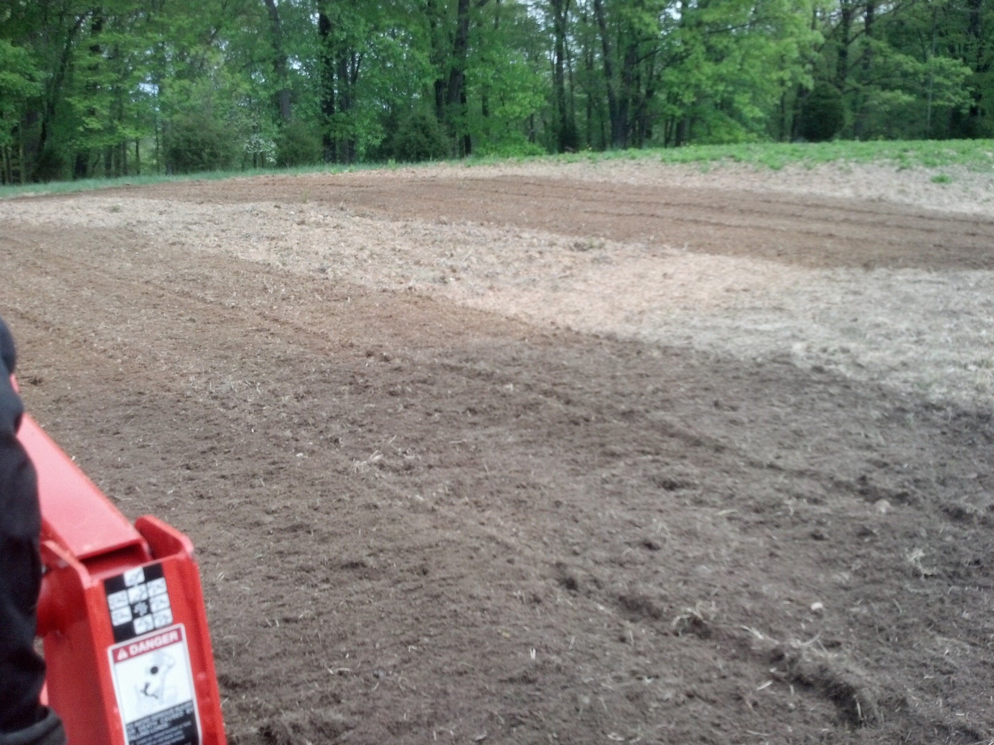

The photos below are my tractor with 72" tiller and food plot before planting. We have rocky soil with most rocks baseball size or smaller. My food plot pictured had half a dozen rocks softball sized or a bit bigger along with smaller rocks.
I'm an advocate for a tiller. I've used tillage tools, plows and harrows to prepare tobacco and corn land as well as gardens and food plots. The PTO powered rotary tiller is by far my choice for garden and food plots (I don't raise tobacco or corn anymore). Mine has a slip clutch that I maintain and I keep a few spare tines around at $7 a piece. In the four years I've owned the tiller, I've replaced six tines and occasionally replace broken bolts that hold the tines in place.
Fuel usage for preparation including plowing and disc harrowing is slightly more than preparing a plot with a tiller in my estimation but time is cut in half or less using a tiller.
The only drawback to the tiller is I have run across some soils, once tilled and rained on, turn into a fairly hard packed seed bed.
