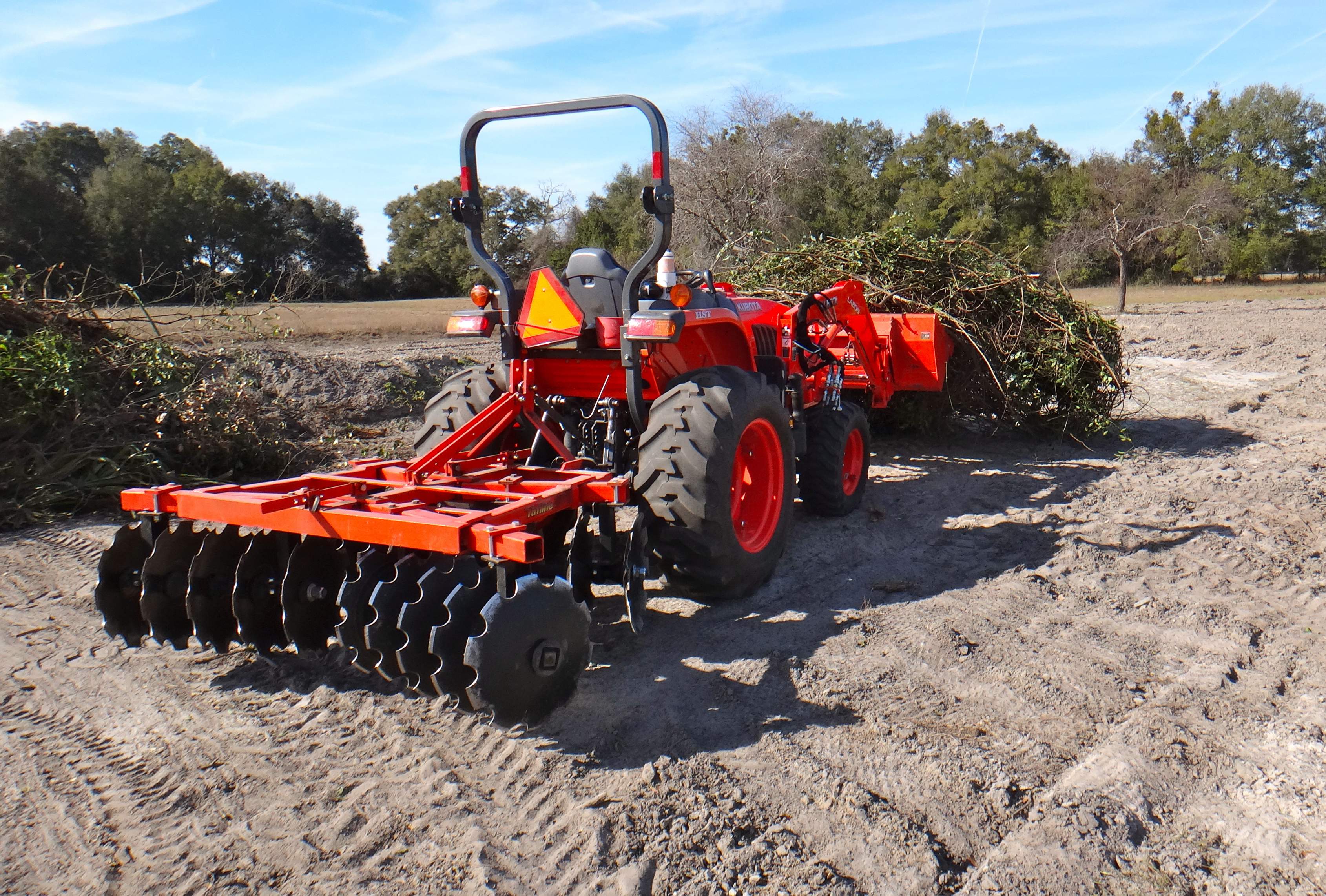

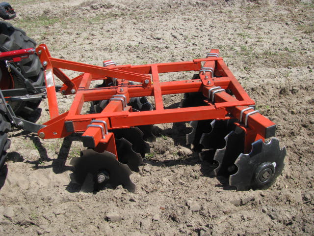

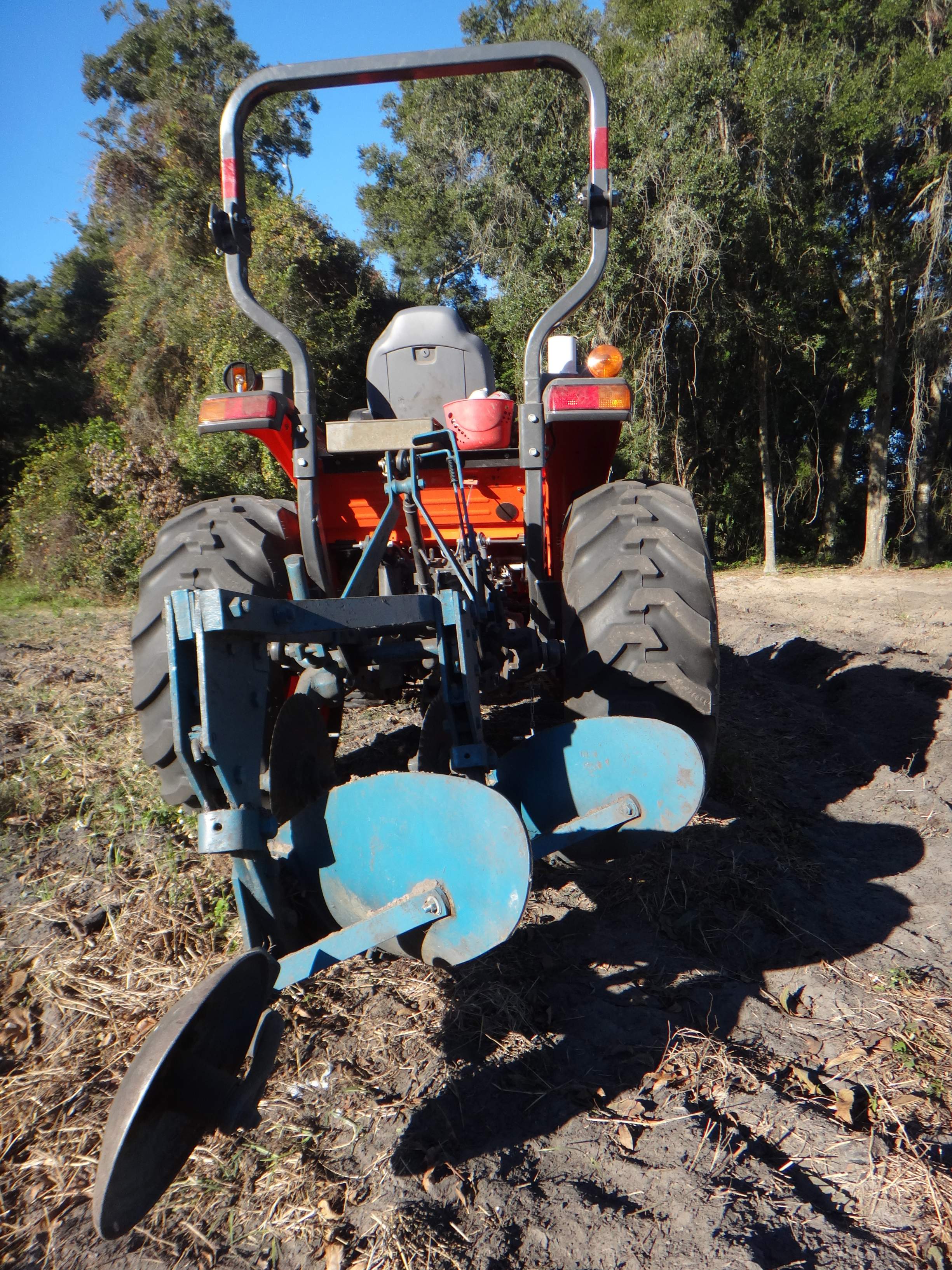

I own both a medium-duty Howse 16/18", 587 pound DH ($1,100 new) [37 pounds per pan] and a robust Monroe Tufline 18/20", 915 pounds, ($2,400 new)[50 pounds per pan]. It takes plenty of throttle for my 37-hp, 5,400 pound Kubota tractor-loader to pull the Monroe Tufline in a second pass.
Disc Harrows with 9" spacing between pans cut better; better for food plots, better for firebreaks.
"Finishing" Disc Harrows have 7-1/2" spacing between pans smooth plow furrows better, mix shallower, pull easier. Unusually, my Monroe Tufline has 9" spacing front, 7-1/2" spacing rear.
Disc Harrows tend to roll over rocks. That said, pans on 20" DH tend to be thicker, heavier, stronger than pans on an 18" Disc Harrow. It is not common, but people do break or deform pans sometimes. I never have.
I have never calculated but I doubt a 72" Disc Harrow has fewer parts, or very many fewer parts, than a 72" roto-tiller, less the roto-tiller's PTO shaft.
Photo #2 Howse 16/18
Photo #3 Monroe Tufline 18/20

While many Disc owners seldom or never vary gang angles, I use my DHs for a variety of tasks and find relatively rapid lever adjustment of gang angles on my Tufline 18/20 a worthwhile "premium" feature.
MONROE TUFLINE: Agriculture TH Series Tandem Discs - Monroe Tufline
Brown Manufacturing makes Discs even heavier, with an even faster lever adjustment, but too heavy for my Kubota L3560.
BDH Disc Harrows | Brown Manufacturing | 800-633-8909
I ogled Monroe Tufline and Brown implements at 2012 and 2014 Sunbelt Ag Expo in Moultrie, Georgia. It took me two years to convince myself to spend for the Tufline, influence by purchase of Kubota L3560. TUFLINE IS WELL THOUGHT OUT AND ROBUST. Paint could be better.
