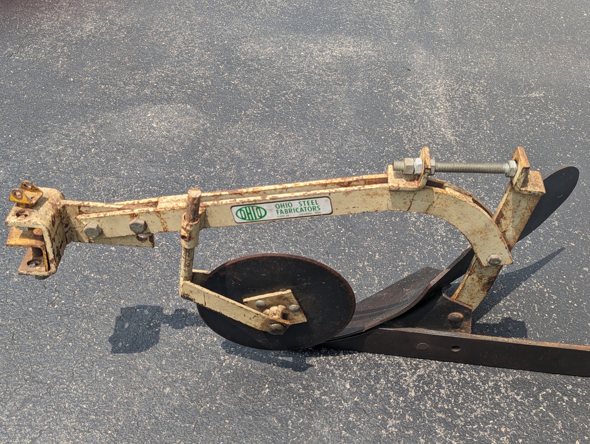

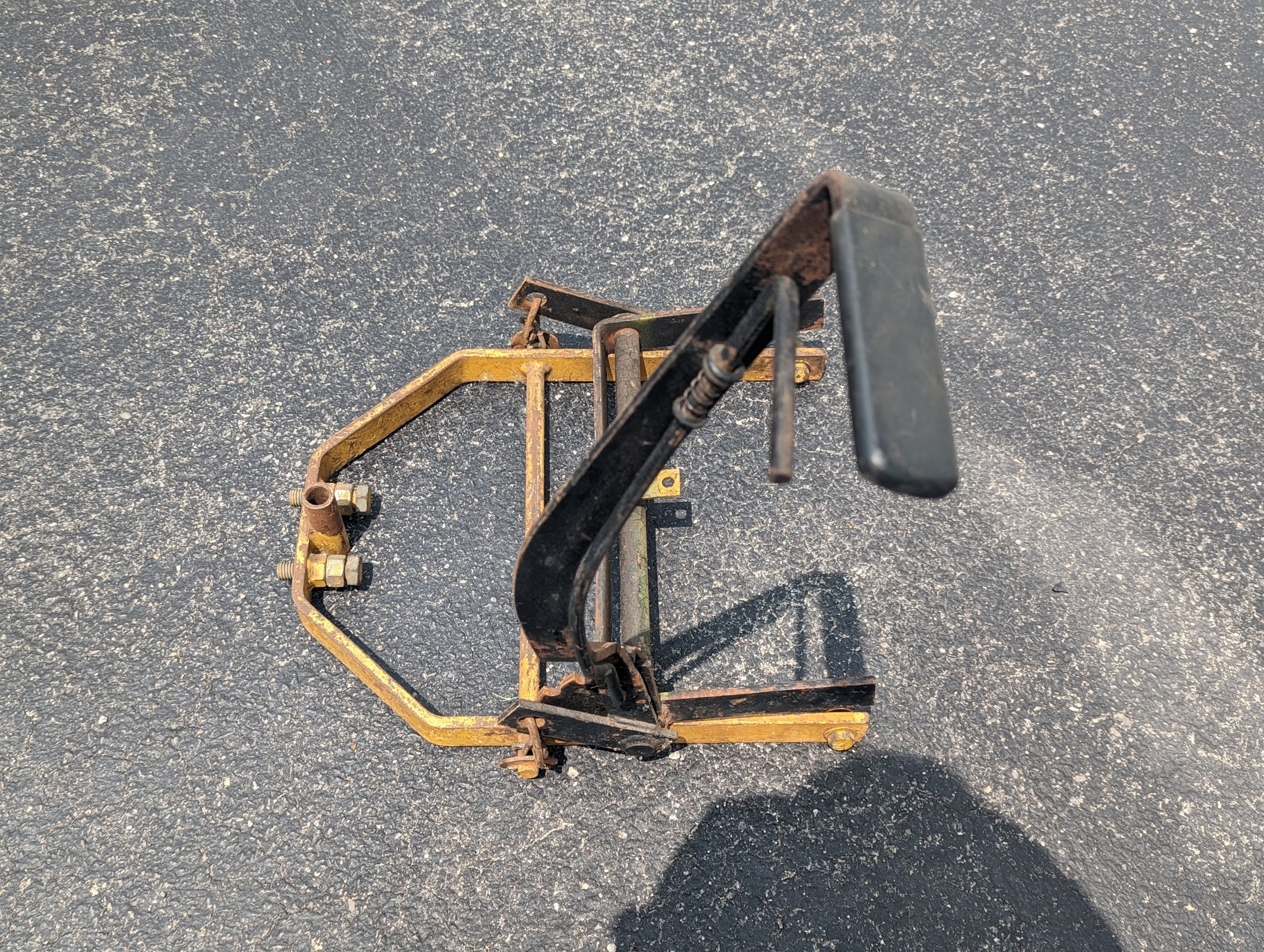

I might have just what you’re looking for! And I’ll give you a great price on it if you’re interested.
