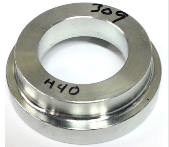

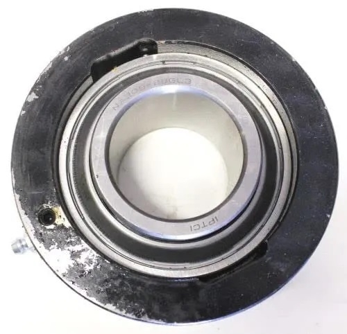

I've found a few possible options, but I'm not sure if they'll fit me.
IPTCI NA209-28L3
UC 208-24
ZUC 208-24
I'm confused because they have support screws. The videos I found on YouTube didn't have them. The image below shows their photos.
It's difficult for me to determine the exact size because I don't have the housing or the old bearing
  • 21-mm_-sharikovyy-s-kruglym-otverstiem-na-val-38_1-mm_-sfericheskoe-naruzhnoe-koltso.-Artikul-...jpg
/ Harley rake repair #4
UC 208-24
ZUC 208-24
These are 1-1/2", not 1-3/4". 208 is 1-1/2", 209 is 1-3/4".
The 209 series is a common spherical bearing and is used on discs, and many other applications. The Timken part number would be GW209PPB2 for a greasable triple lip seal bearing.
It appears that the M6574 is a spherical bearing with a round housing that is held in by a P015309 lock collar. The P015309 lock collar has some o-rings on it was well. This make me think it is more of a spacer that is also a sealing surface. So a bearing with a lock collar will most likely not work for you.
I do not see where the round housing is a off the shelf part. It might be a custom unit from Harley. I know that this did not help with finding the replacement housing. Keep us posted on what you end up doing.
Here's my current plan. Today I opened up the mechanism on my Woods rake (the main assembly is practically a twin to the Harley version) for the tractor. I assumed it had the 1.75" bearing I needed, so I wanted to check the part number and housing dimensions. It turned out there was a 1.5" bearing installed. However, I studied the assembly and checked for any missing parts. I've ordered an NA209-28 bearing (with metal shields — we don't have other decent options available locally). When it arrives, we'll machine a new housing for it. I also still have the worn P015309. We plan to restore it to its original dimensions. In the end, I hope I'll be able to get everything assembled!))
