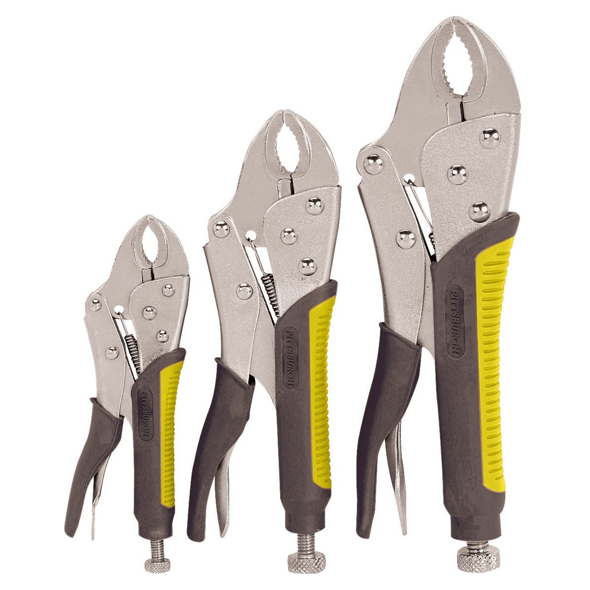

I also have this set of locking pliers....
The bigger two are sort of OK, but the little one actually bends if I squeeze it with my hands. Again, kinda junky.

4 out of 5 of the pliers work great. And two out of three of the locking pliers work just OK. So on average, they are still above the "sucks" level for the price.
