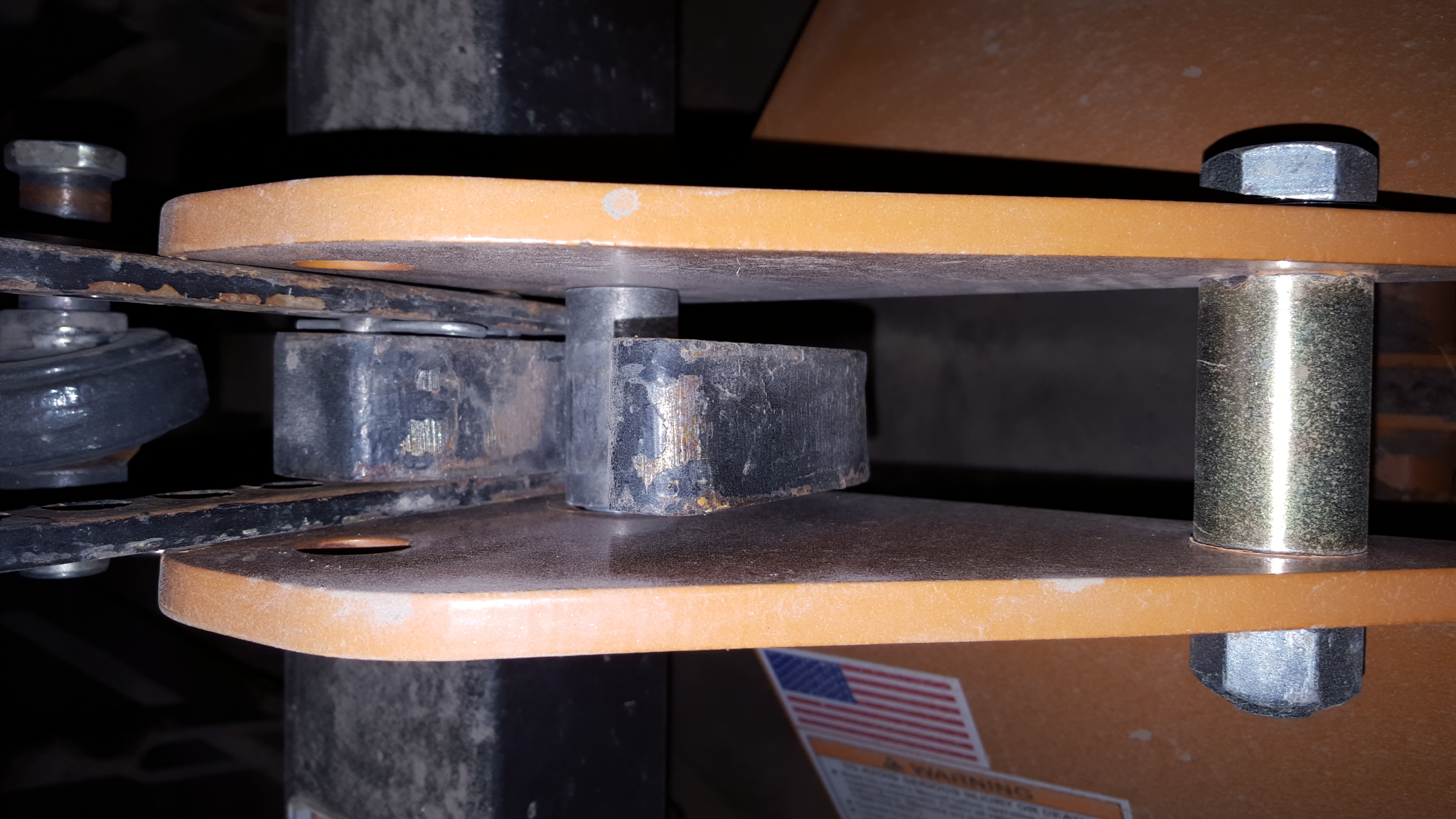

Another poster mentioned mods that you might want to make. A couple of years ago I made the mod that one of our members came up with to replace the bolt holding the adjustable top hook with a pin that is flush with the outer walls of its bracket. Prevents interference that the head and nut on the factory-supplied bolt can cause with some implements. See pic:
