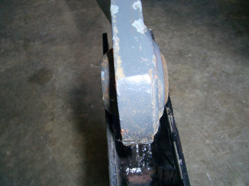

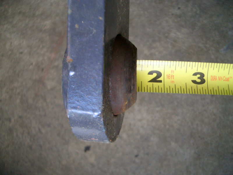

I just tried out the hitch on my brush hog. I need an extra 1/2 inch in width to fit the hog. Has any one tried to spread the arms using a hydraulic jack or similar device? It does not appear appear that a minor tweaking of the width would damage the hitch or cause the release mechanism to malfunction. Any opinions on this.
/ Harbor Freight 3-point quick hitch #278
I had to spread mine about 1/2" also. I used a floor jack and a short length of 4x4 post. It was very easy to do. The results are OK, but not great. It is wide enough, and still functions OK, but it definitely distorted the lower portion of the frame, so it looks a little funny. Still works fine. Go slow and spread only as much as you need to. If I can ever get the adapter, or something like it, it will be fine for my box blade and rear blade attachments.
