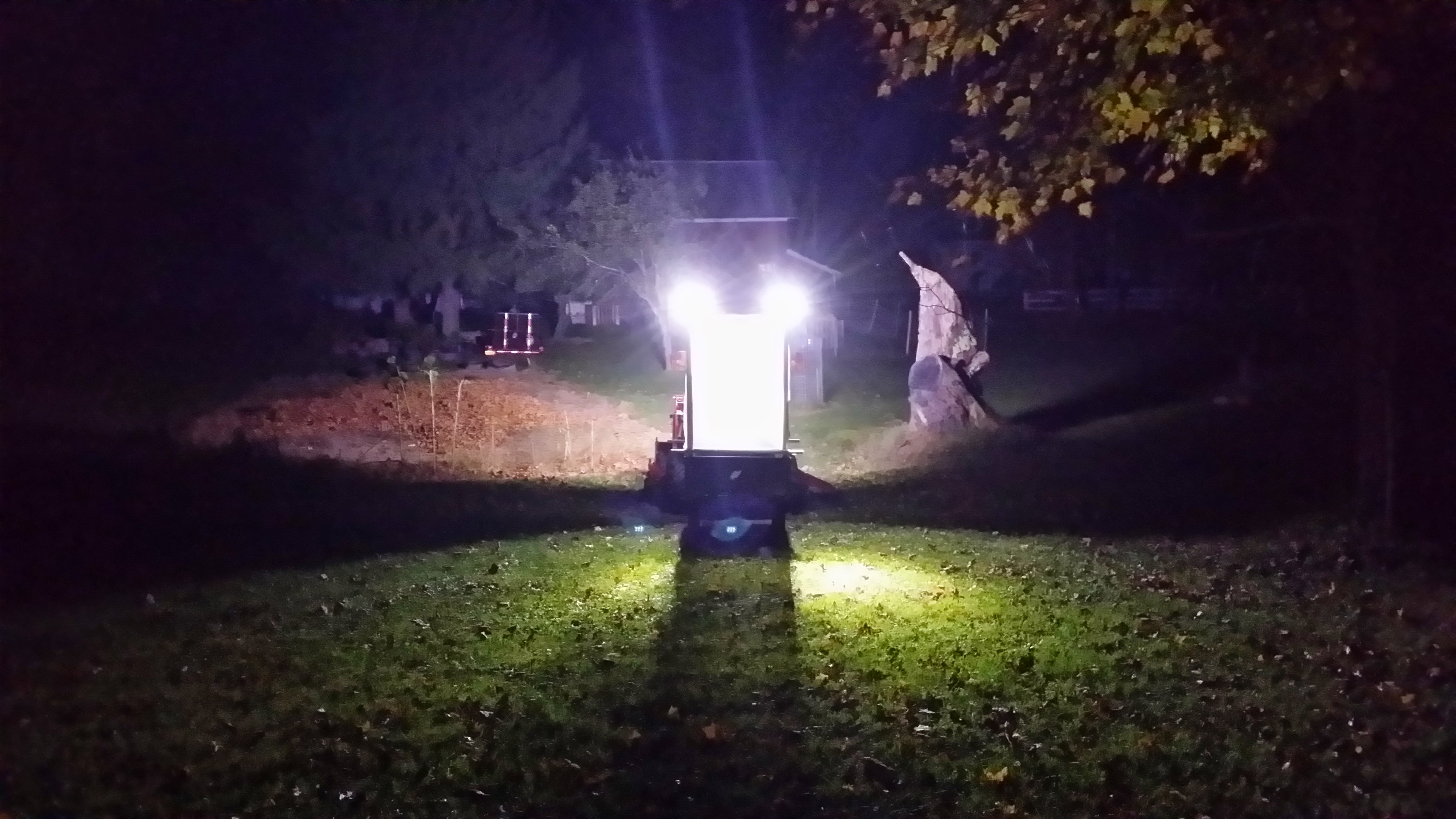

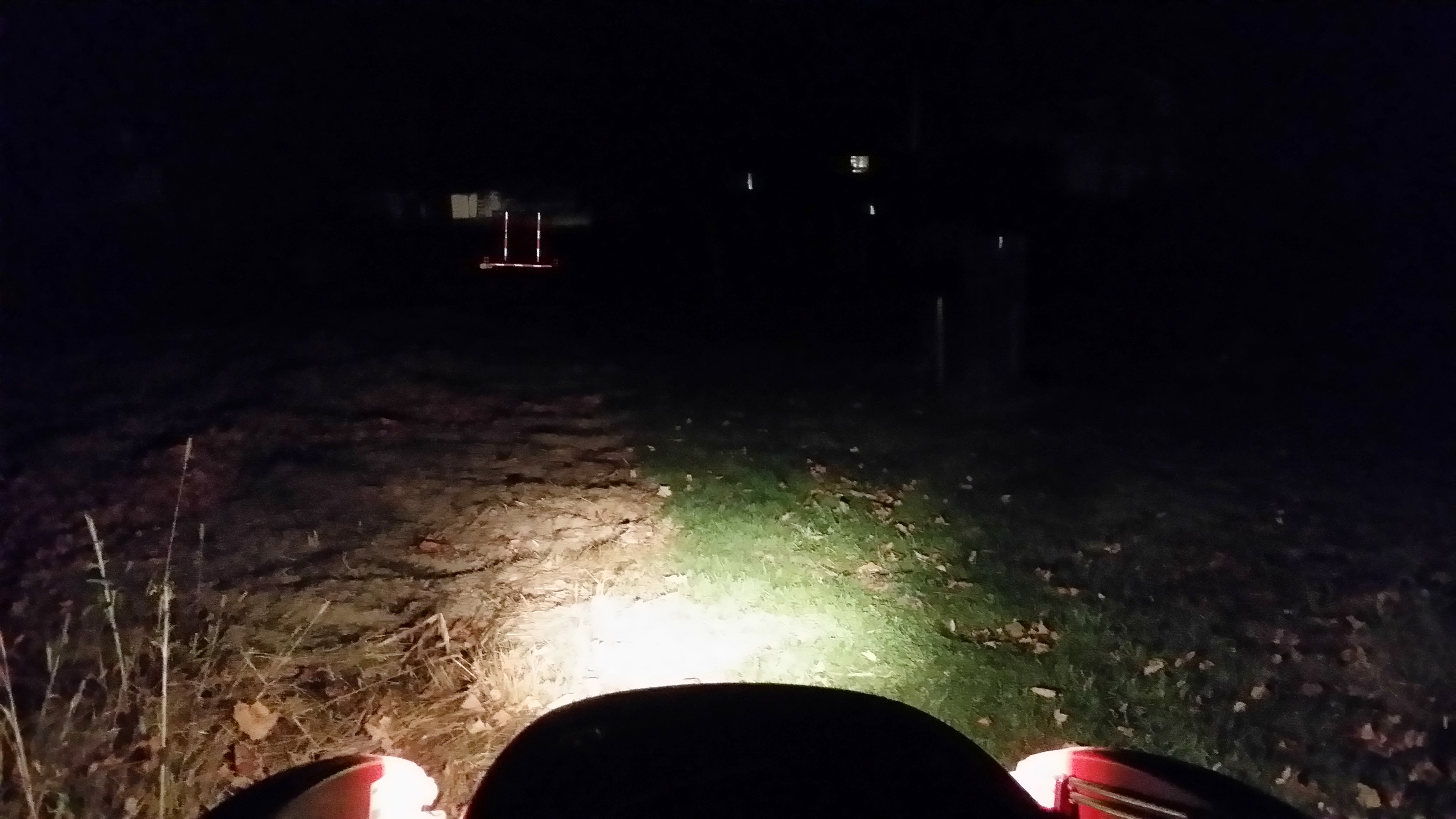

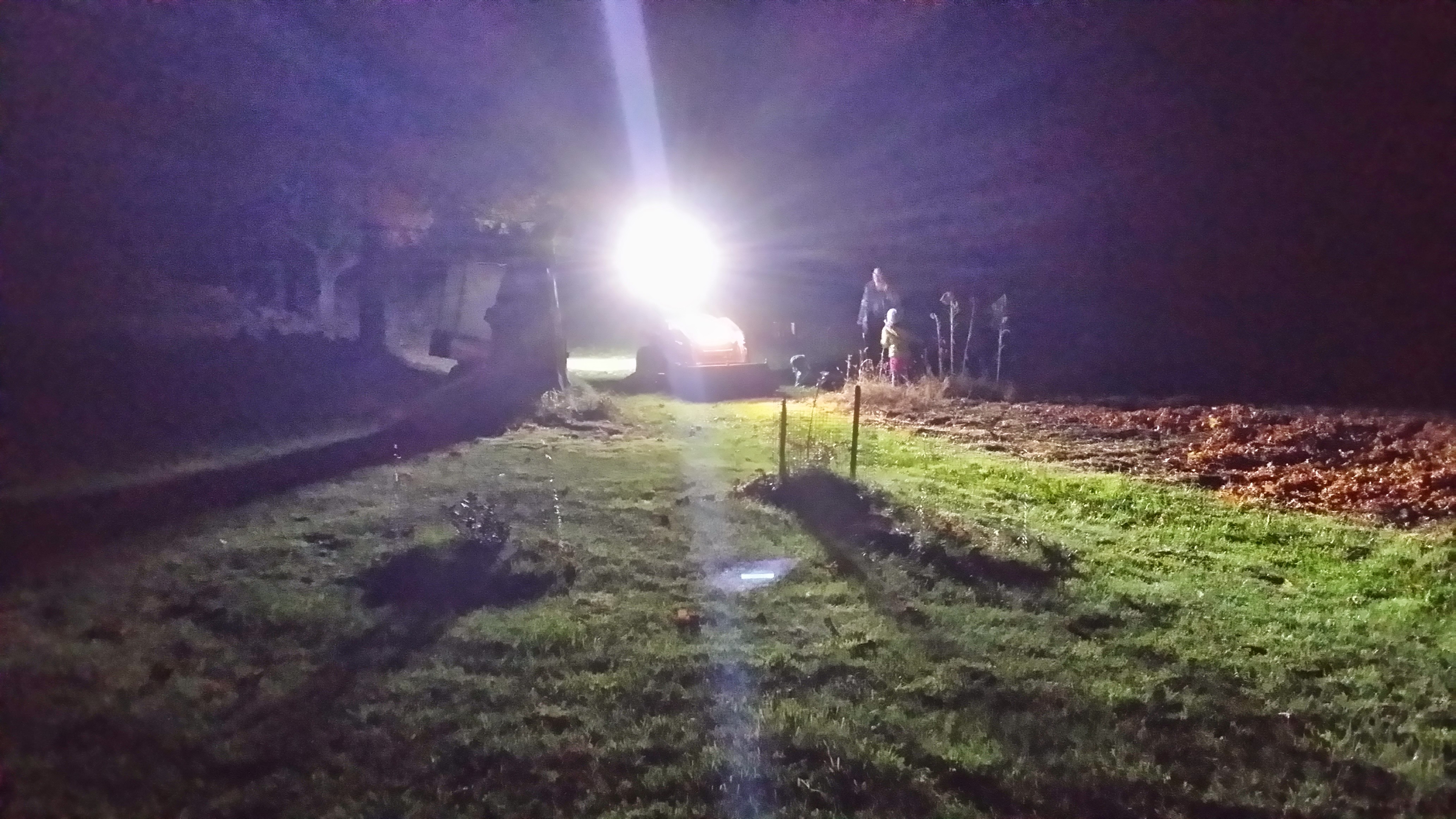

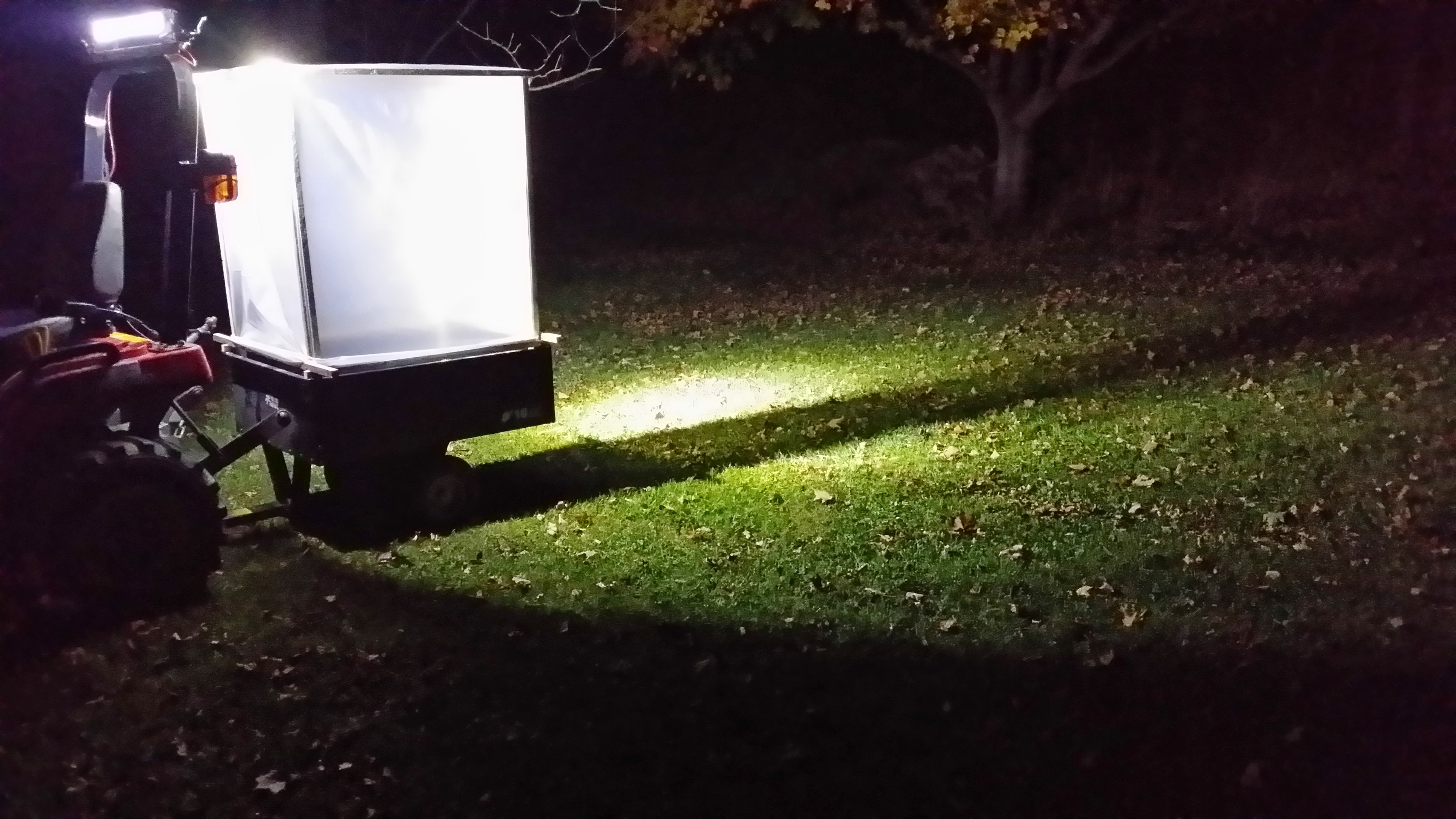

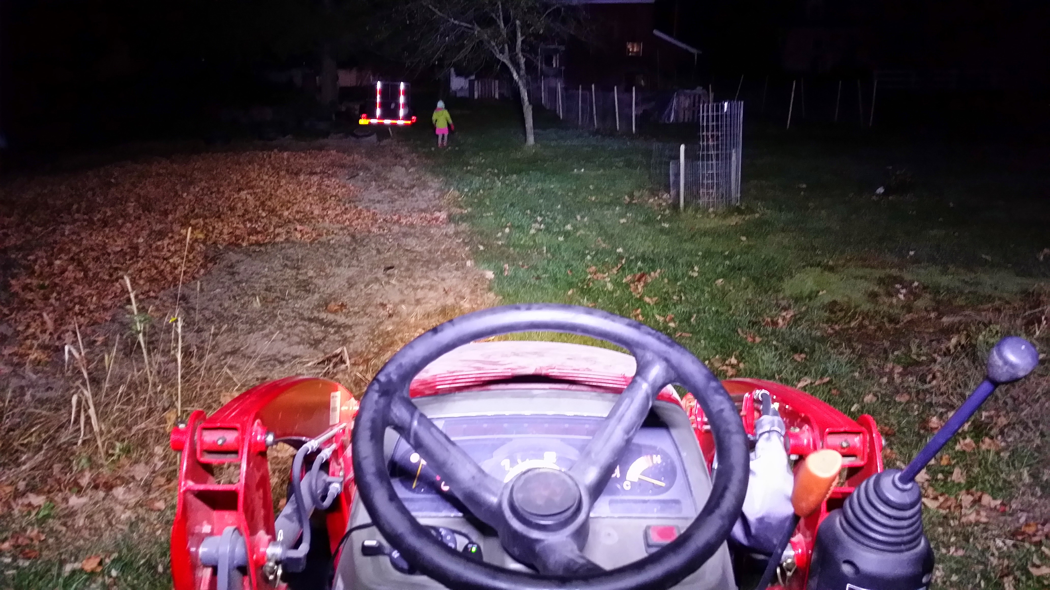

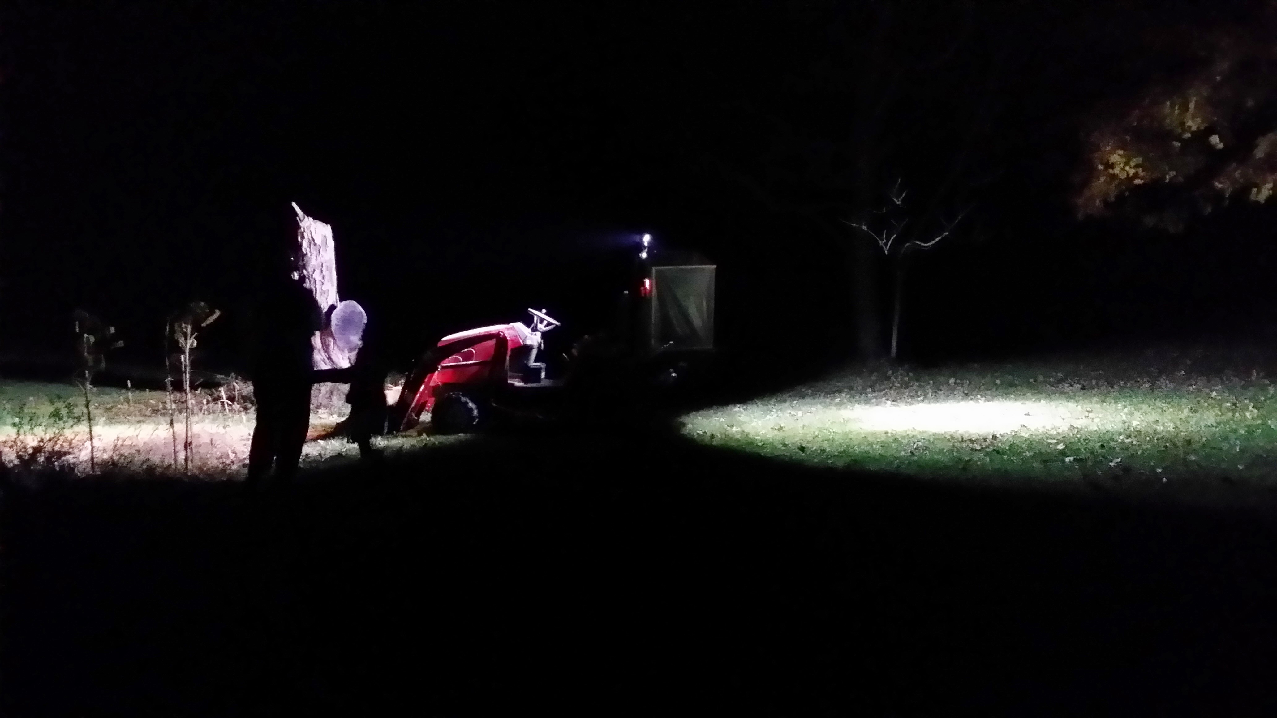

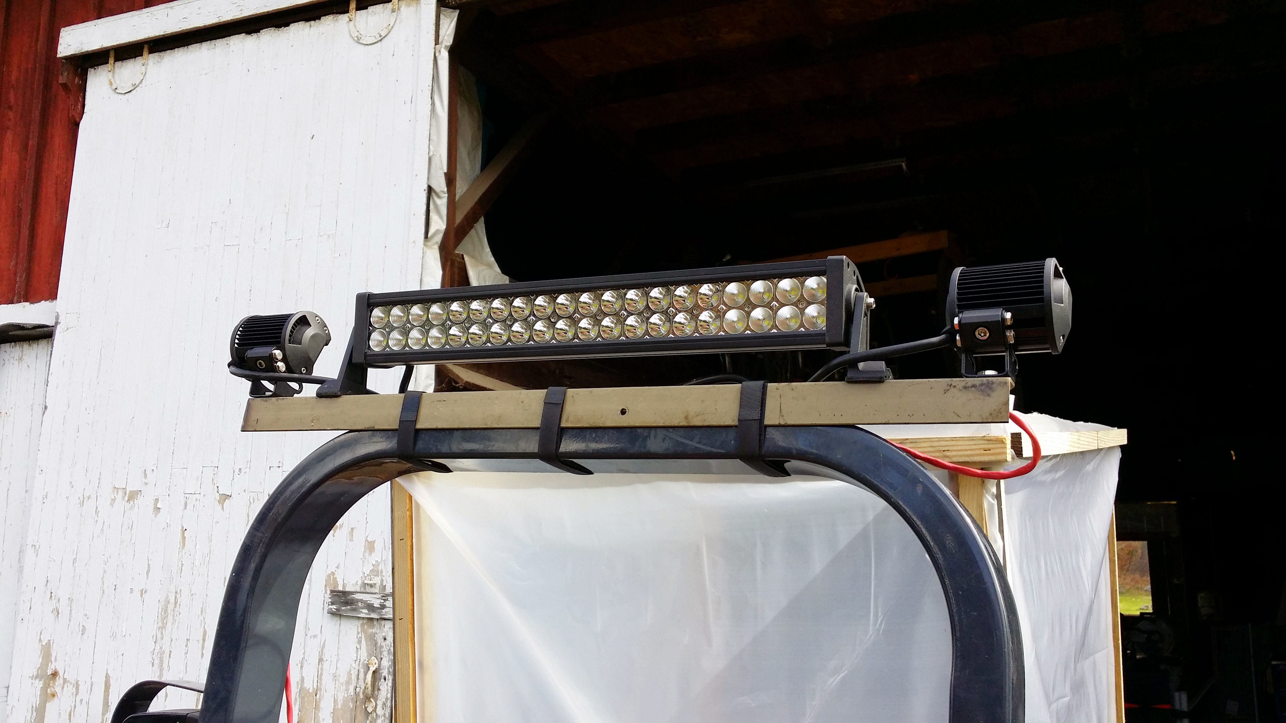

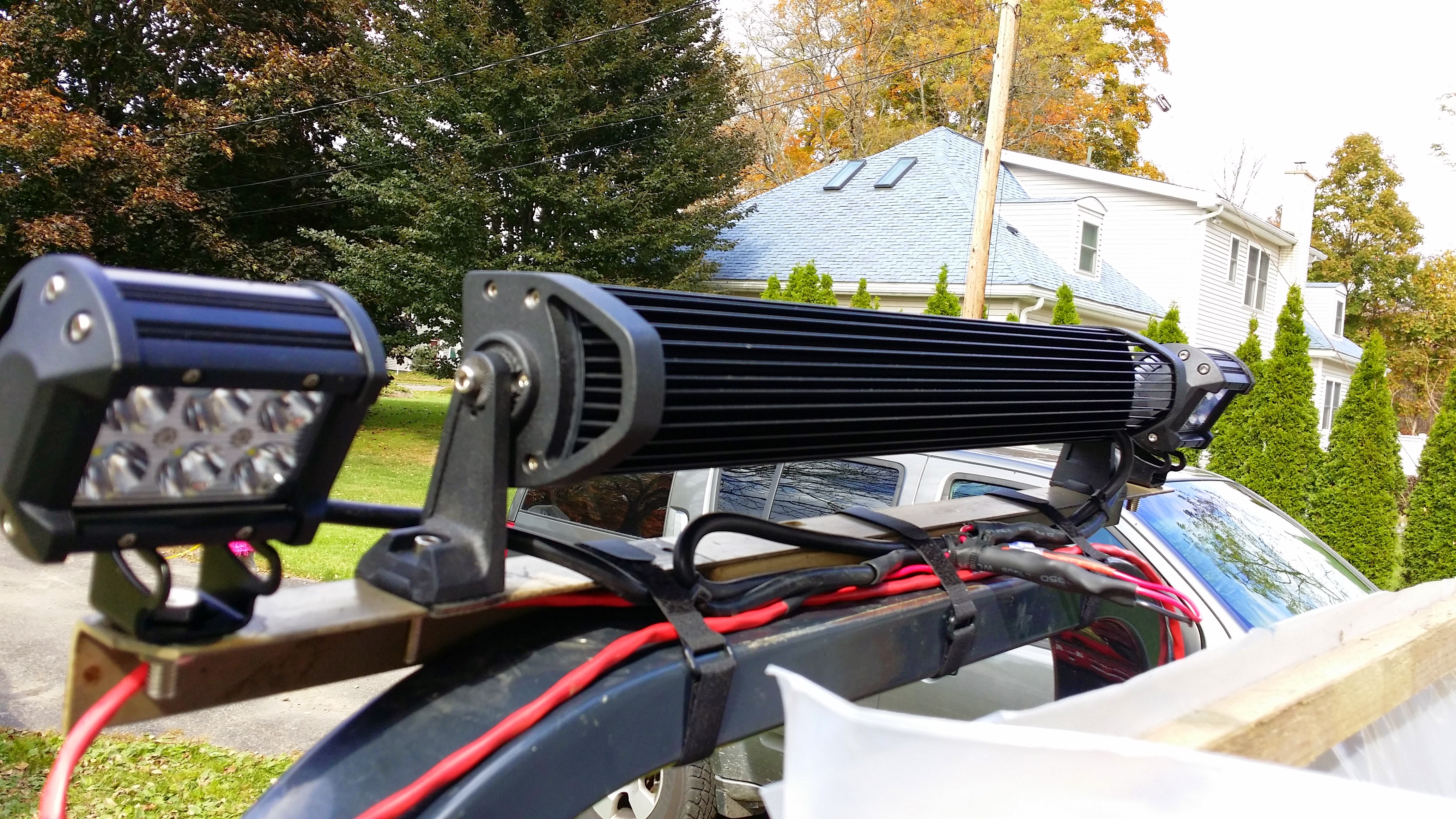

I went with a 20" (I think) LED bar for the front and 2 4" square pod lights for the rear. All mounted to a piece of angle iron for now until I decide if I want a roof or cab. The nice part of mounting them on the ROPS is the factory headlights on my GC2600 are useless unless the loader is on the ground, or 5ft in the air as it blocks them at travel height. They also provide good light all the way around the tractor.
