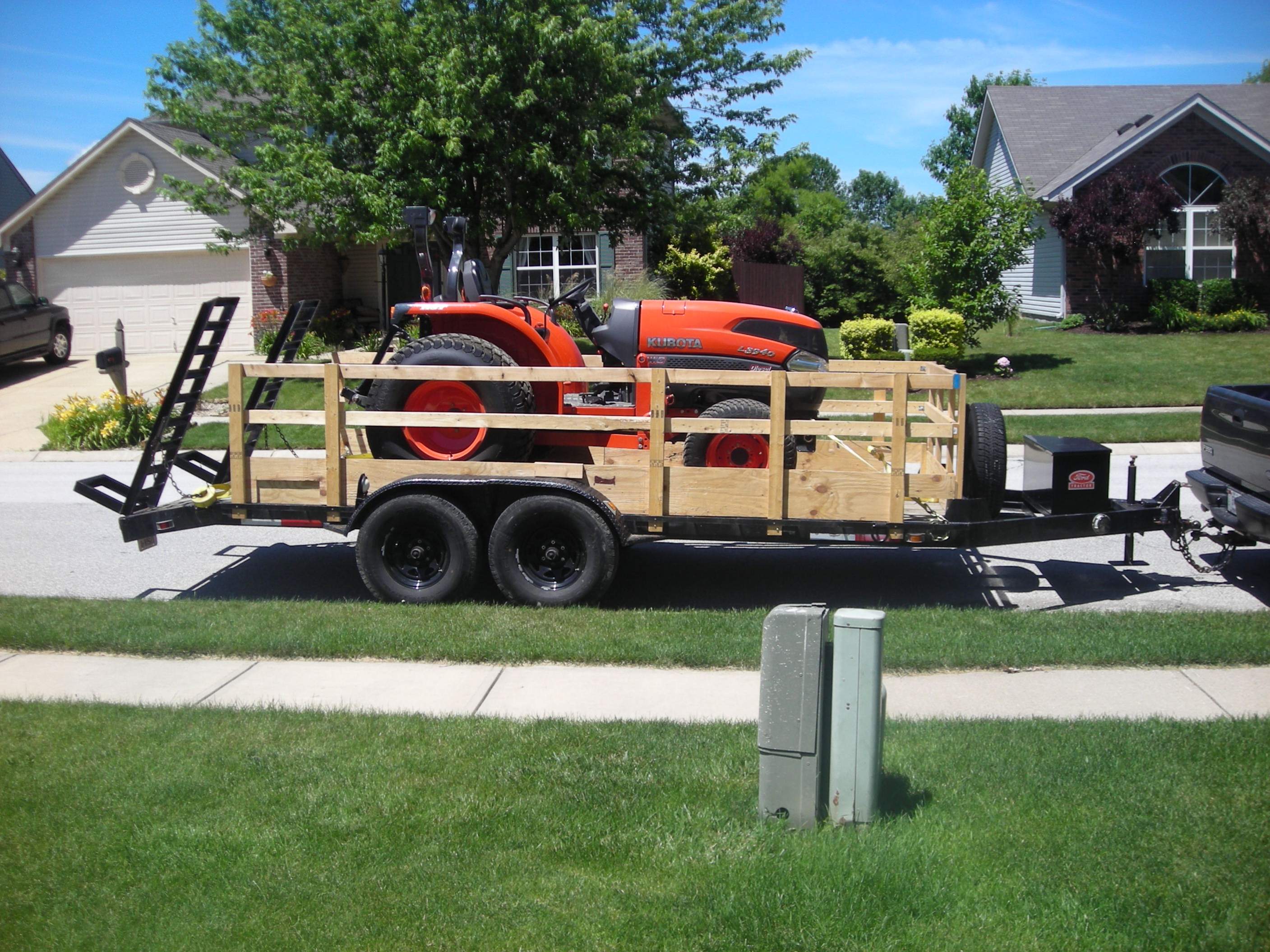

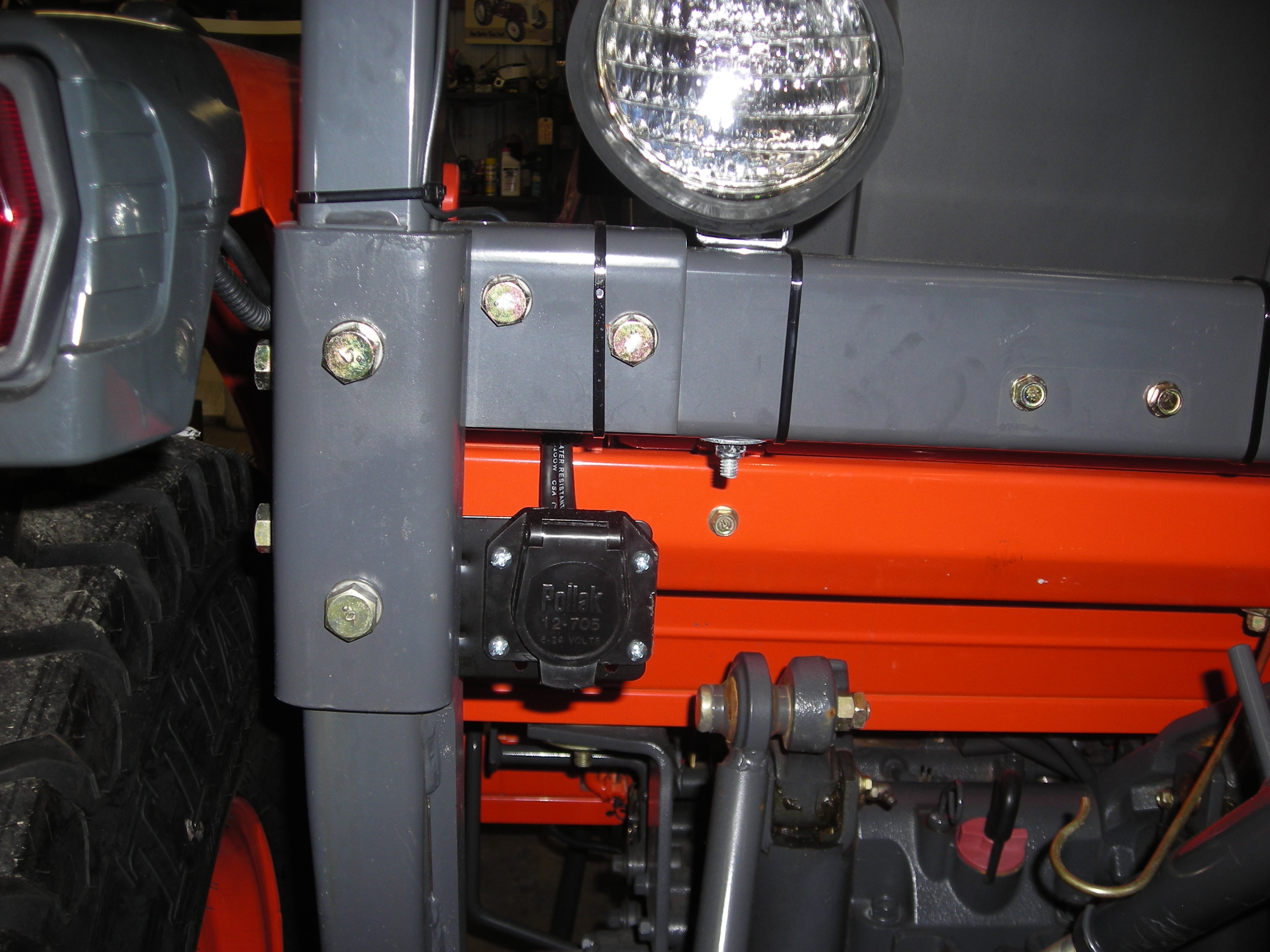

I have done hayrides with this tractor and trailer. I built the wooden sides just for this purose. I wired the tractor lights into the trailer so all running lights and flashers are on. With this size tractor, I did not see the need to hook up electric brakes, but it would not be too difficult to do. Keep a couple adults in the back to chaparone and all should have a good time. Philip.
