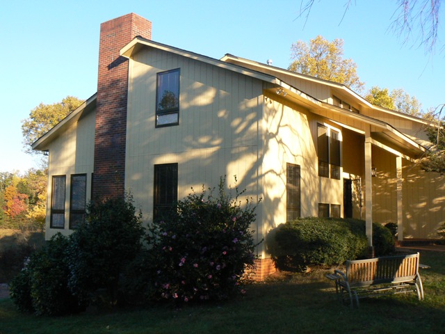

Having gutters being put on the house for the first time (house built late eighties, been here three years now).
House sits on a slope.
I'm going to have five drain spouts coming down on the side of the house (two in back, three in front).
The roof is large, and I realize that now I will be concentrating all of that rain run off in certain areas (coming down those down spouts, and where it comes down from the spouts, it will want to run down hill on the side of the house.
Worried about what erosion (sp?) may occur, perhaps heavy depending on the rain.
First thought was to tie the spouts into some buried PVC and just run it down hill to the back of the property. However, after thinking about it, I have a LP line buried on the left side of the house, and more than a couple of electrical and water lines buried on the right side of the house (I didn't put them there, but through trial and error, I know the general area and had to access one water line). This may be a big problem with trying to burry anything now going on the side of the house to the back.
However, we already use a water barrel (Jacks Rain Barrels from my wifes home state of Vermont). This got me to thinking.
Could I place a rain barrel (55 gallon) under each spout? The rain barrel has the 5/8 hose fitting to connect a garden hose to. What I was thinking was that if I was getting a VERY heavy rain, I could just tie a garden hose to all of the rain barrels and run the hose to the back of the house, may be a little more than I want to spend for the hoses and barrels, but probably less expensive than rental and time and trying to avoid any mistakes digging (and perhaps still hitting something anyway)
What I don't know is if I'm wasting my time.
All of the water run off lines that I may put on the barrels (via hose) will be run off gravity going down hill, no problem. However, since I don't know how much water I can get with those five spouts, I was wondering if I get a heavy rain if the water barrels will just fill up to quick and that the hose will not be able to drain the water barrel quick enough, and the barrel will just overflow with water anyway and I still may have a drainage issue to deal with in heavy rains.
Wife would like the gutters. Have had issues with some of the siding and fascia without them (gutters) over the three years we've been here.
Picture is from the front left side of the house. One down spout coming down on the left front corner of the house, another on the left post that supports the overhead roof over the door, and another on the right side of the house next to the garage (which you can't see). The other two spouts will be on both corners of the house in the back. Hard to tell from the picture, but from the corner of the house, starts to slope on a pretty good angle going down the back.
Keep in mind, the hoses wouldn't be kept on the barrels, only put on the barrels if we were supposed to get a good steady downpour to help drain the barrels.
Any thoughts or suggestions?
Am I wasting my time in my thinking?
Any advice?
Thanks.

/ gutters / rain run off? #2
Some quick mental calculations. As I recall, there are about 7.5 gallons in a cubic foot. 1" of rain on 1000 square feet of roof would then yield approximately 625 gallons. You can use these estimates to decide whether 55 gallon drums are practical for rain gathering. I decided they were impractical for me.

/ gutters / rain run off? #5
I don't think a garden hose, or even several of them, will be able to handle the water overflow. I think that even a light rain will overwhelm them and the barrels will be overflowing rather quickly, and create a wet area next to your house that will just start some new issue down the road.
The piping would be ideal. You can always tie them togehter with four in lines and then just dig one ditch in the front and back for a 6 inch line. You also don't need to be all that deep since it's a lawn and not a road that you will be driving acros. Mine are just 6 inches deep right next to my house and I run over them on a regular basis with my 4,000 pound CUT all the time.
Another option is to spread out the water as it comes out the downspout and then just let it run across yoru lawn. Gravel is great for this as it slows down the water and spreads it out. It's the same principle as rip-rap on lakes and rivers. It will stop the erosion. You just need to make it big enough to handle the water. Of course the downside is that it might not be attractive unless you do it all around the house, or make a garden type area of it.

/ gutters / rain run off? #6
As said, piping is the only way to go. Honestly, would you go out every single time it rains to set up temporary hoses? And then go out again to remove them? Each time it rains?
The PVC pipes only need to be a few inches deep going across the yard. Run everything from the right side of the house around the foundation and tie them into a bigger pipe on the left side for the actual buried run out to a ditch. You have plenty of vegetation around your house to effectively hide the black pipe above ground - especially with a little mulch thrown on top. Then just bury what needs to go over the yard. It's simple, cheap, and effective. One day of work and you'll never have to worry about it again...

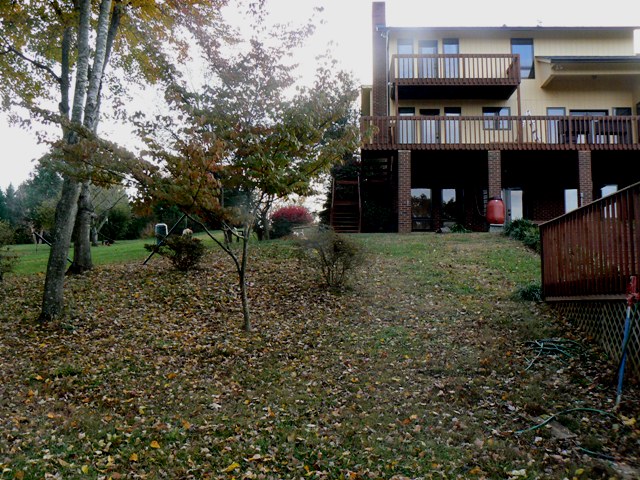

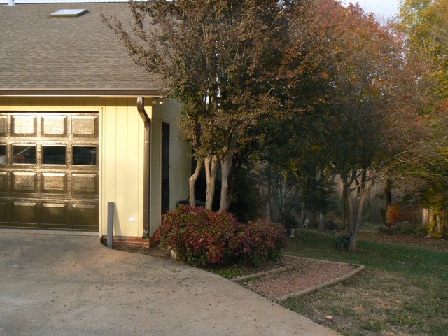

A picture is worth a thousand words. This is the biggest problem, however a question which may make it the easiest down spout to with labor wise.
The first pic is of the front right side of the house that has the most roof surface area, which will also get the most water. Going down that hill is those buried lines and trees. You'll notice that I put in a gravel walkway to the steps to a side door I put in on the garage. This was because this area got to muddy always using the stairs during heavy rains.
If you notice, the spout comes off right in front of our driveway. Well, for the last 18 years, the rain has just been coming off the roof and falling on the driveway (causing some issues that wanted my wife to get the gutters). The guy who did the work left me numerous pieces and elbows for me to work with the downspout termination. Well, this again may be a stupid idea, but what about running a 3 section right back out onto the driveway? Or would the concentrated area of water run off cause me more issues to deal with? I'm figuring if this is where the water was going anyway
Or I could just fill in the area with stone (between the driveway and house) and work my way down the side of the house.
The second pic is standing behind the house looking up to the driveway. This gives you an idea of what I'm looking at. You can also notice another drain spout on the left top corner of the house, with the downspout coming literally right behind the stairs up to the second deck.
I might add it will almost be impossible (IE money not worth it) to tie more than two drain spouts together. I have the driveway in front of the house, and I have deck steps in the back of the house that goes all the way to another deck.
Dosen't look like we'll be having any real major rain, so I have time, but again, since you may have a better idea now, and more suggestions?
And yes Dan, if it were up to me, I probably of wouldnn't have gotten the gutters; however this was a no brainer for my wife, so now we have them :)
Thanks.

/ gutters / rain run off? #11
Drain lines are not like supply lines. You always need to go as big as possible. I think that you will regret using a 3 inch line if you go that rought. If you want to use PVC, you can used thinwall for drain lines and save some money.
I would just use the corrugated rolls to really save some money. If you keep the pipe attached to your downspouts, and screens over the tops of the downspouts, you won't have to worrry about them ever plugging up. At $30 for a 100 foot roll, you won't find anything cheaper for the 4 inch lines. The six inch line is quite a bit more, but still a bargain compared to anything else in that size range!!!
I've been told, but can't prove this, but for every half inch that you increase the size of your pipe diamater, you increase the amount of water that will flow through it by 2 1/2 times.
As for digging the trench, sometimes it's harder thinking about it then just doing it. I just dug one through some trees, along a flower bed and uphill t my house for my hot tub. I dug it by hand in hard clay and waited until the last minute to dig it. It wasn't very much fun, and a few times I thought about not doing it, but that wasn't really an option. I stuck with it and eventually it got done.

/ gutters / rain run off? #12
The corrugated black stuff is pretty easy to work with, but if you bury any joints be sure they are not at a low spot and try to make them as water tight as possible. That's not easy with the corrugated pipe. At our last house, the previous owner had buried the corrugated pipe to carry off the rain water, but he had a joint in a low spot near the house and most of the water came out there causing water to get into the basement. Major headache. At my present house, the water drains into solid pvc except where I just had some foundation work done. The foundation people used the corrugated pipe to re-connect two drains they had to remove to do their work. That leads to solid pvc and I'll end up digging it all up because I'm sure there's no way the connections are water tight, and of course the six inch pvc they go to doesn't have much pitch to it. I'm pretty sure water comes out at the connections during heavy rains, and might even pool in the line all the time. I should have been there when they were doing that work, but I had to go earn the money to pay for it.

/ gutters / rain run off? #14
Go for the bigger pipe.
With back problems why not make a level run on the surface for the pipe. Then backfill over it and smooth it out. Might be easier than digging.:D
