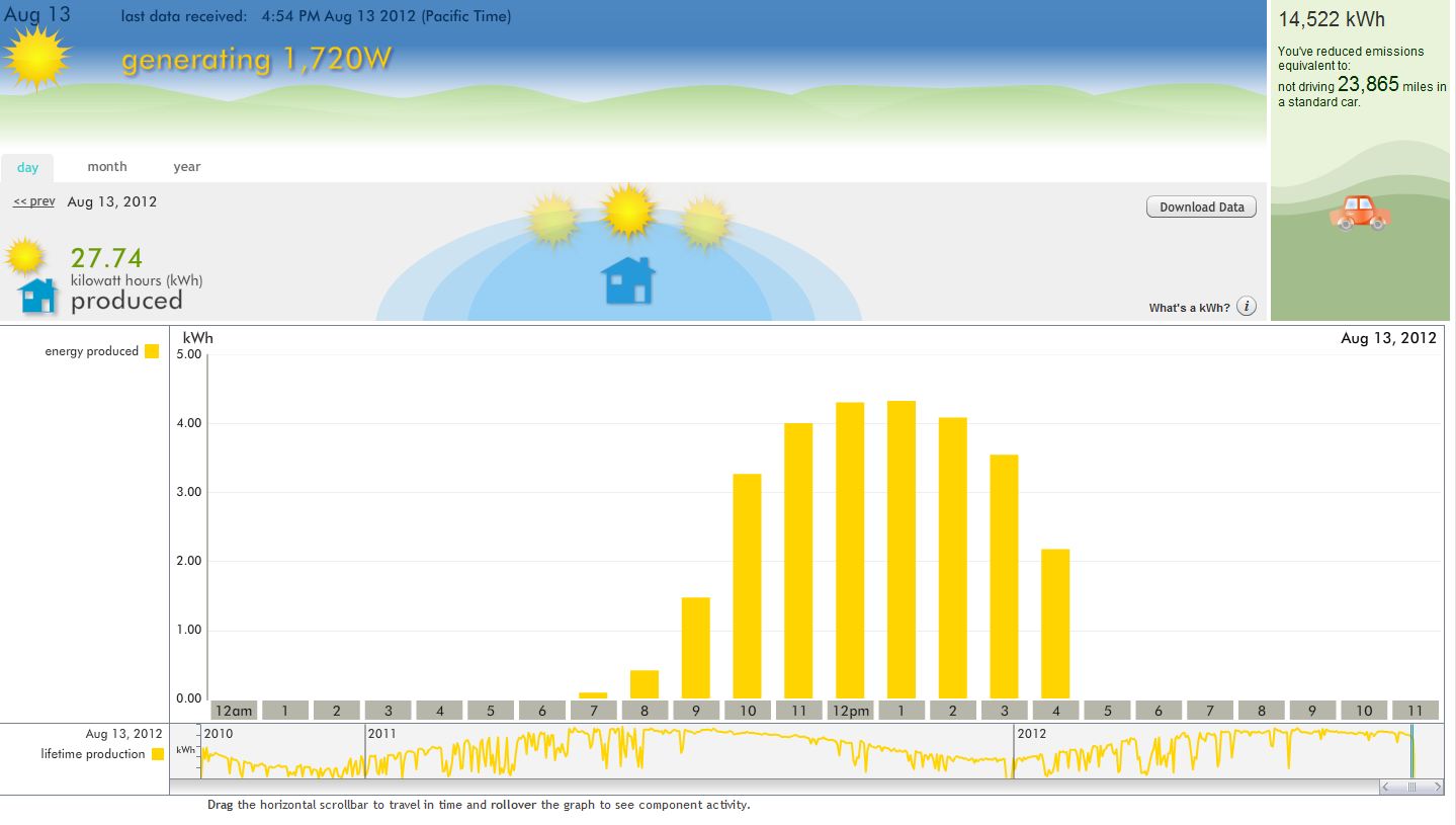

We have been bumping 32KWh for the last three months. Our 5KW system, has us hitting net zero for the year. We're an all electric house, but do a lot of heating in the winter, with a wood stove.View attachment 276782
I have seen hinted, that many are comparing just todays electricity rates for the payback. Electricity rates keep rising, so the payback times shortens.
Glad to hear your system is doing well. I didn't opt for any PC or Web interface, your display is nice though.

Ya, I snip snapshots and send them to other work team members; I am involved in Energy Star test and development for a large chip maker. We're always doing some test or another on PC's to see if they comply with Energy Star 5.2 for computers. I'm the most energy compliant member on the team! :D
Our setup is 5KW. I bump 4800-4900 frequently. We have a 6KW inverter. It was only about $200 extra. We'll add another 1000W of panels in the future. I need to wash my panels; I have got pretty close to full capacity with clean panels this time of year.
