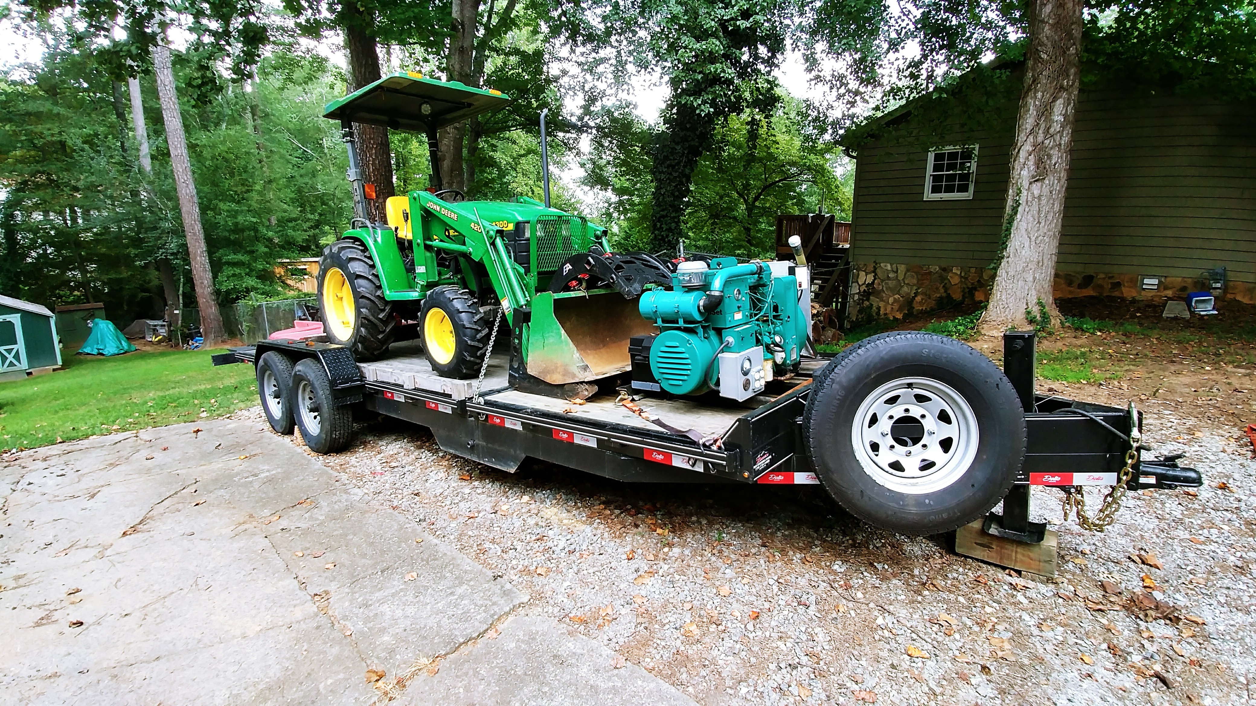

I have a 22 gravity tilt trailer I use for my tractor, implements, etc. 16 tilt, and a 6 fixes section in front.
Works well for most things I transport. It has a cylinder installed under the tilt bed that dampens the up and down actions. Recently bought a Ram 3500 truck and thought I would haul it home on the trailer, but found that the weight of the truck brought the tilt section down before the rear wheels even got on the ramps. Thought a little about backing it on, but trailer deck is only 84 wide and just made other arrangements.
Question is, what would be required to control that cylinder in an up or down position? Could it be done with a simple valve setup, or am I going to need some kind of pump?
Any ideas welcomed !

I have a trailer very similar to this. It has a valve just to the rear of the locking latch. It also has a very small reservoir for excess fluid.
/ Gravity Tilt Convert to Hydraulic Controlled #3
Yes and it shouldn't be too difficult, might even be able to use the existing cylinder. Need a pump with double acting controls, some hose, a good deep cycle battery and possibly a double acting cylinder if the existing one can't be converted.
I'm surprised yours doesn't have a way to lock the deck in the up position with the hydraulics, all the gravity tilts I've looked at have that ability. What brand is yours?

All the gravity tilt trailers I’ve seen had a valve to lock the cylinder in place and a lever to lock the deck at the bottom.
/ Gravity Tilt Convert to Hydraulic Controlled #11
My gravity tilt trailer has a valve that you open or close to control the bed. You can close the valve with the bed tilted down and the bed will stay put no matter how much weight you have on the deck. That was one of the issues I investigated before I got the trailer. My trailer has two hydraulic rams and the fluid just goes from one ram to the other with the valve in between. A simple design.

Talked with the manufacturer today and they said I could just attach a remote ball valve connected to lines at each end of the cylinder and control where it is positioned. So just need to rig it up and mount it along the rail where the locking mechanism is located.

It's already a functional system so I don't think he needs to do anything other then add the valve. I'm guessing they just used a fixed orifice to control the drop rate as opposed to an adjustable valve.

Yeah, I’m not sure how the cylinder works now, maybe just moving fluid from the gland end to the piston end. No hoses on it, ports are plugged. Factory just said get a couple of 3/8” hoses, and a ball valve to connect them. Have to unload the tractor tomorrow and see what’s up.

No, it’s a double acting cylinder, according to the builder. Could be used on a dump trailer with supporting brackets.
/ Gravity Tilt Convert to Hydraulic Controlled #18
Without any external setup though it sounds like it might just use air to dampen, unless there's internal valving which I doubt (and could cause a complication for adding a valve).
