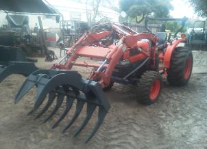

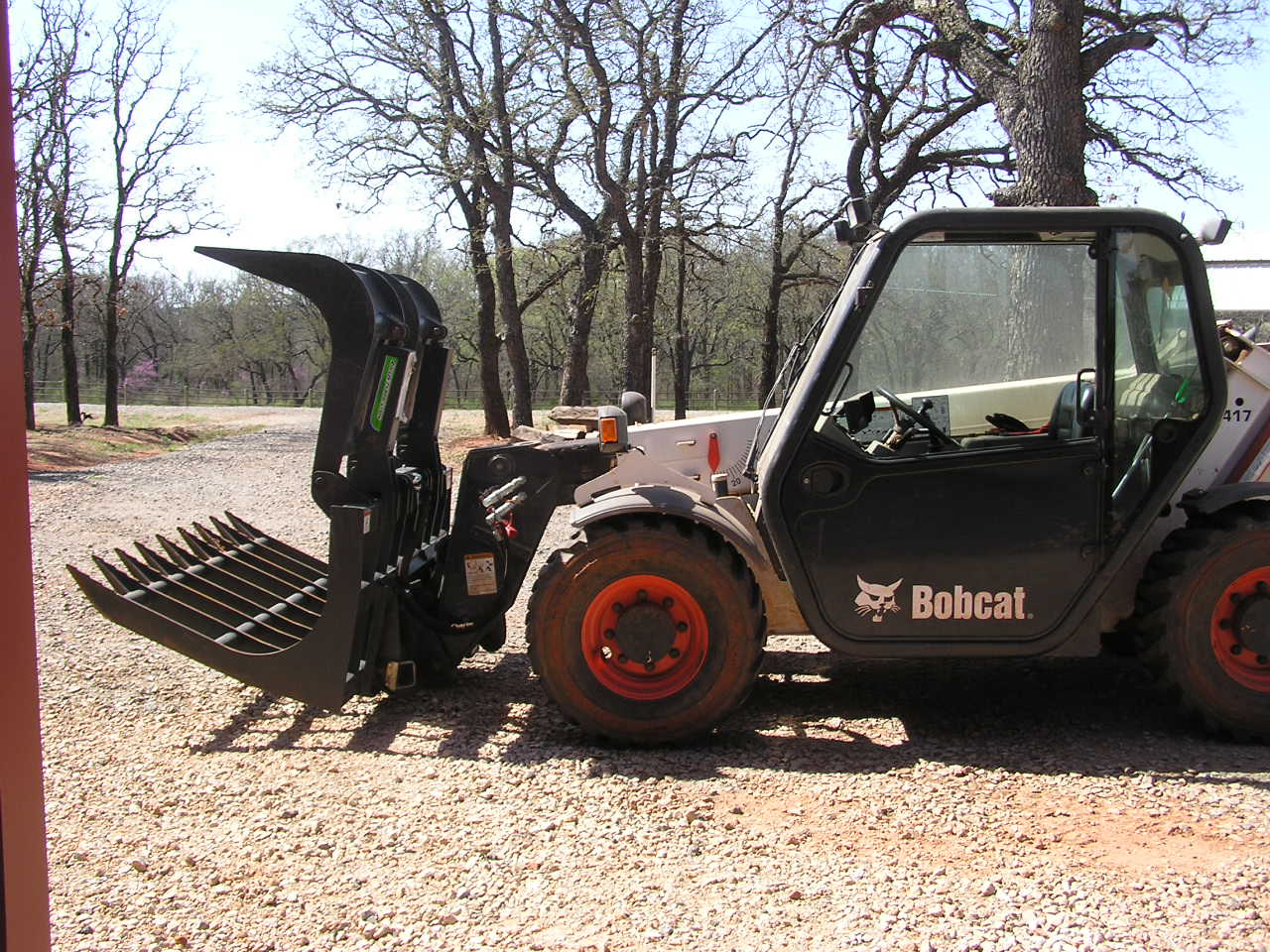

The design is a combination of something I drew up and what the young fellow at the welding shop envisioned. He was particularly pleased with the "tongue".
I know for a fact it saved the grill/radiator at least once. The basic guard is OEM on my tractor. The expanded metal & tongue were added.

Looks really nice. You should think about marketing it.

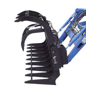

I do have the quick attach on the loader, and the 3rd function hydraulics so that's all ready to go.

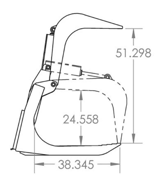

I like the weight and tine spacing on that Wicked Grapple, but I'm thinking that if I tilt it up to get the teeth under the manure mat for scraping it will tend to want to dig into the floor. That little 6" flat doesn't seem like it would support the weight without digging in.
The Anbo UT-S model I was looking at seems like it might work better for that job:
UT-S Utility Grapple for 1-35 horsepower machines
At 440lbs its a little heavier than the EA Wicked but still comparable to a 72" bucket, and the tine spacing is a little wider but probably acceptable at 8". Convince me that the dig in issue when tilting isn't a problem and I might prefer the EA.
-------- Convince me that the dig in issue when tilting isn't a problem and I might prefer the EA.
The 6" flat points don't support any weight, The loader arms support the weight and should not move down as you are going forward.
The angle on the EA Wicked angle looks about the same as my Monster Grapple. I use it a lot with the flat parallel to the ground, pushing under things to pick it up.
