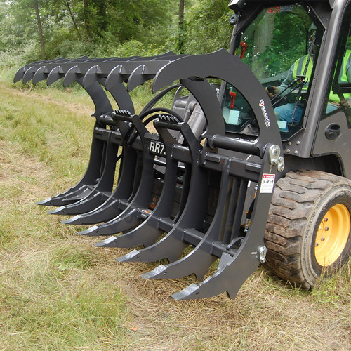

I like this type. Looks like it would be good for digging out small trees and rocks. I think you could grapple anything type 1 could. Negative is the smallest size weighs 500#.
