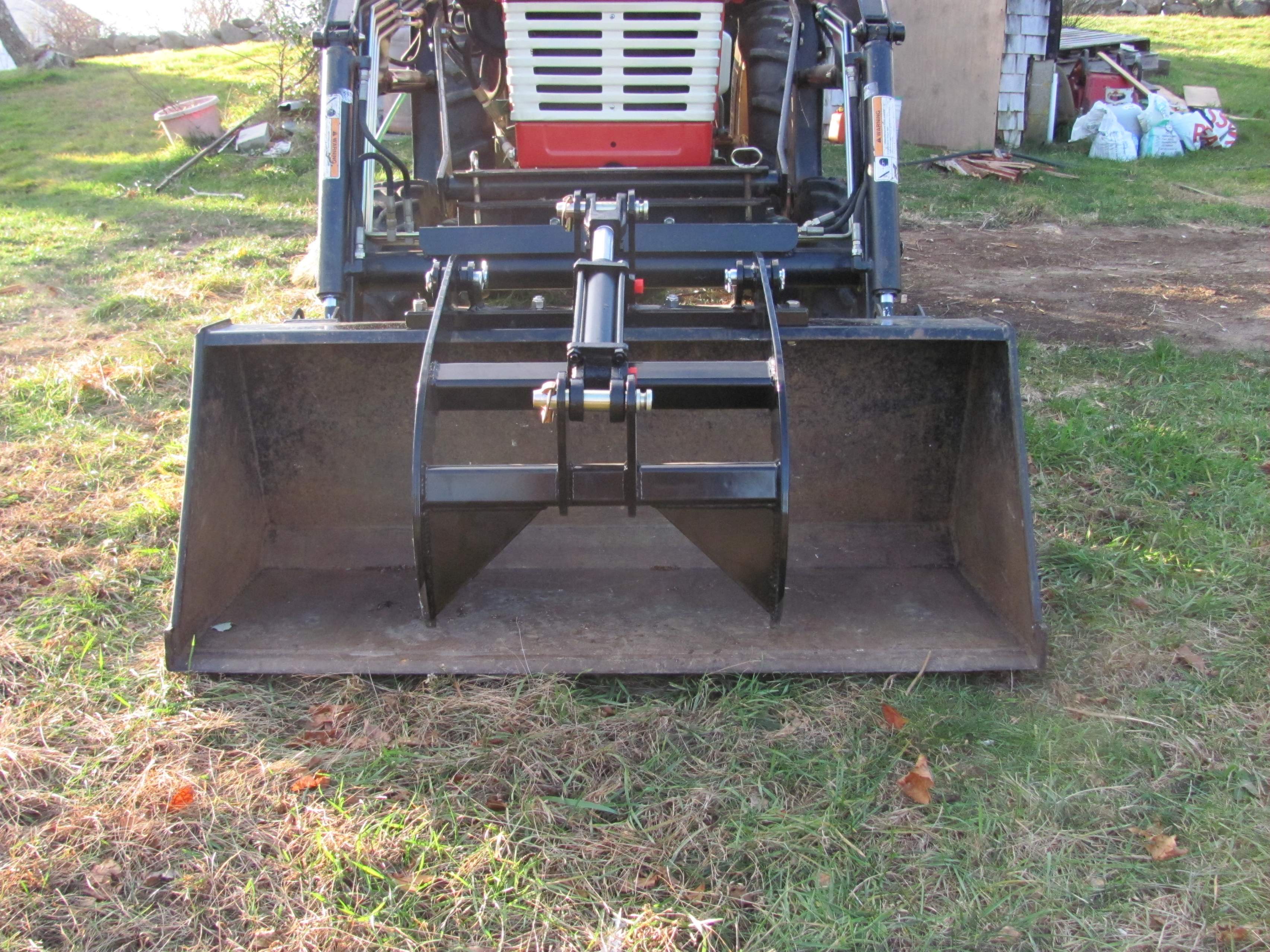

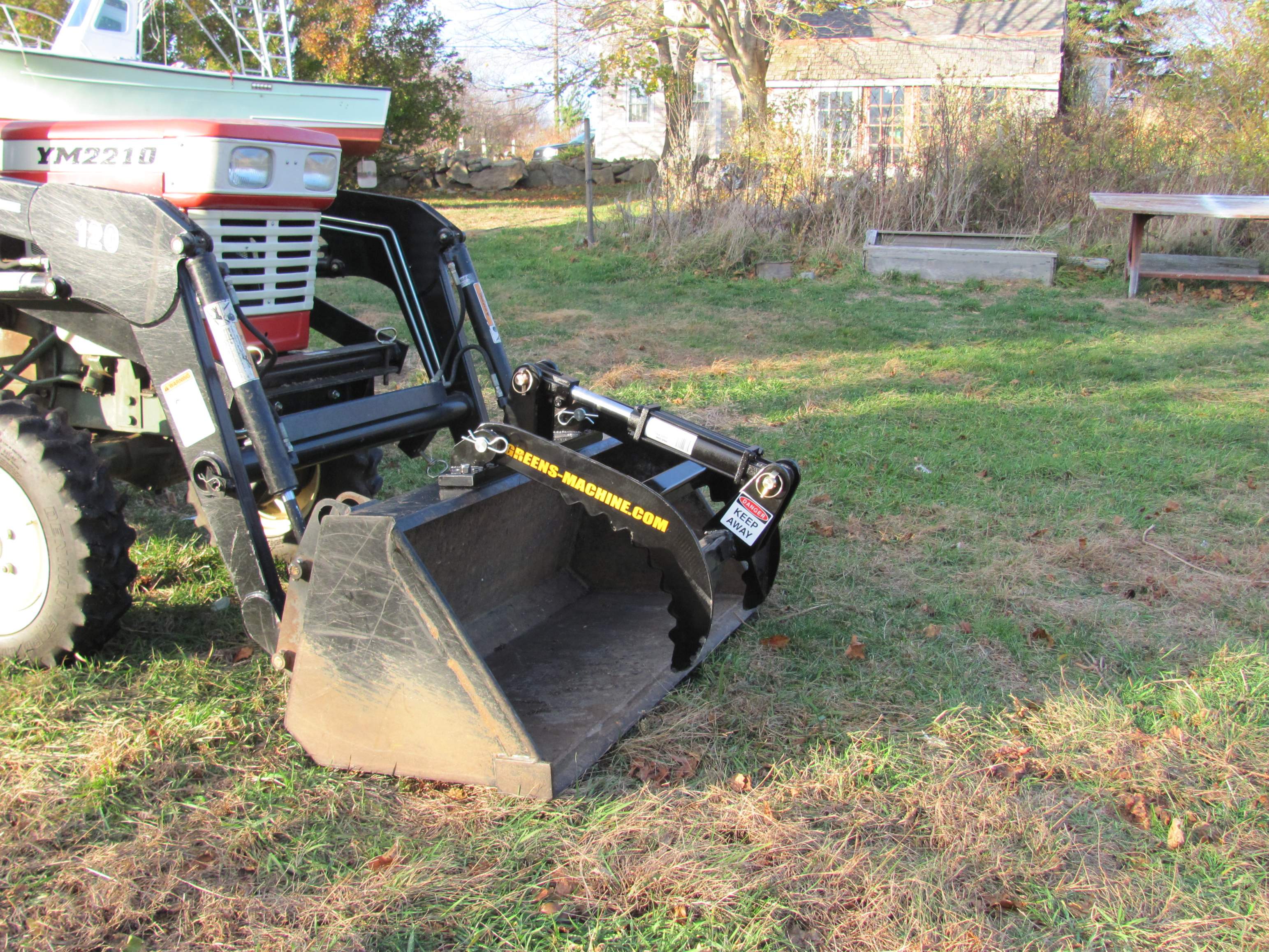

The new grapple arrived today. Man, is this thing built well!! Four holes (and plenty of oil) later, and it's on. Have to figure out valve type, hose length, and a few other things to get the hydraulics set. I now have a decent understanding of how hydraulics work; shouldn't be too hard ;)
Still not totally sure which ports from loader valve to use......but in should be on one side and out on the other.....?
Also, not sure if I have the cylinder pointed in the right direction. Does this matter?
Any suggestions or advice will be much appreciated.

Nice looking grapple:thumbsup: You might want to turn the cylinder around so the hoses don't have to move in and out with the ram.

I have a Green's machine thumb,works great...don't know about your hydraulic connections;but turn the cylinder around and put ninety degree elbows in the cylinder;keeps the hoses back a little.
/ grapple mounted...next hydraulics #8
Forgot,tooth-bar will make the thumb work a lot better...brush ,logs ect.
Thanks Birdman...I ordered the 90s, thinking exactly that!!
