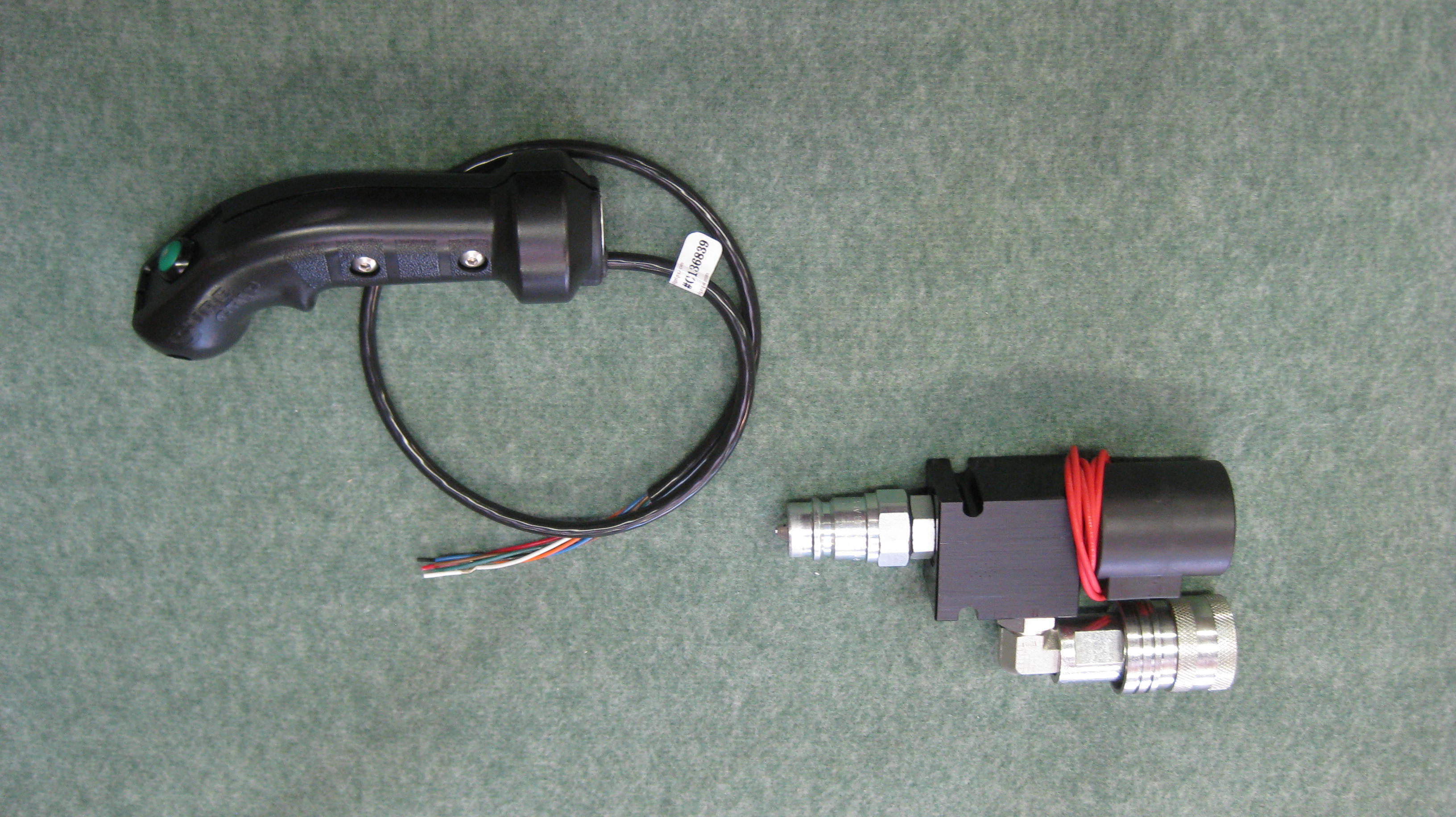

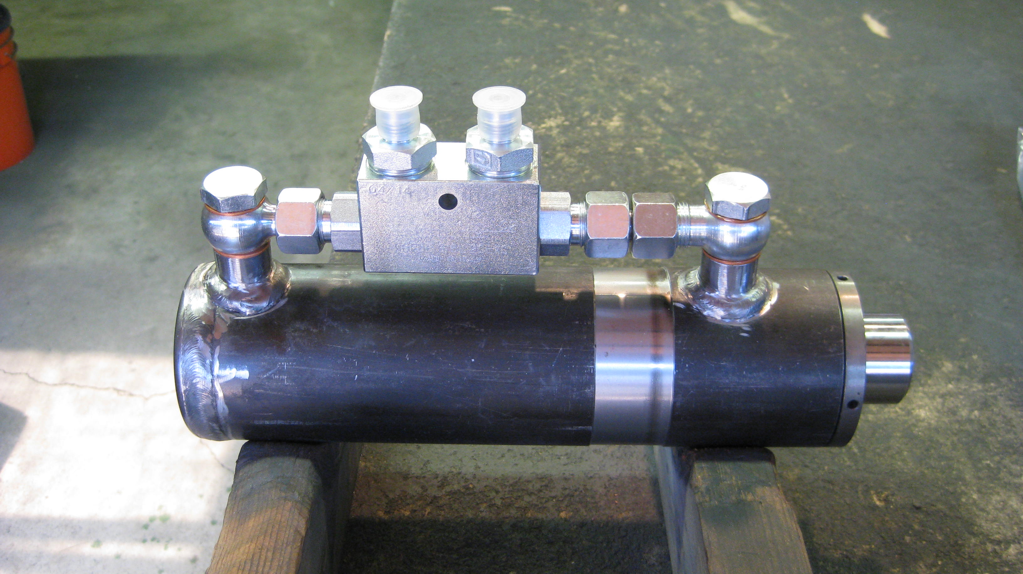

I now have 2 separate types of solutions for you and your T&T drifting issues.
Either The DPOCV for $120 each shipped to you or an electric on-off valve with control grip for $300 to be used at the coupler of the rod end hose. The control grip has a lit maintained switch. This shows you that the valve is either open of closed and is the solution recommended to still be able to use the float feature when-if needed. :thumbsup:
