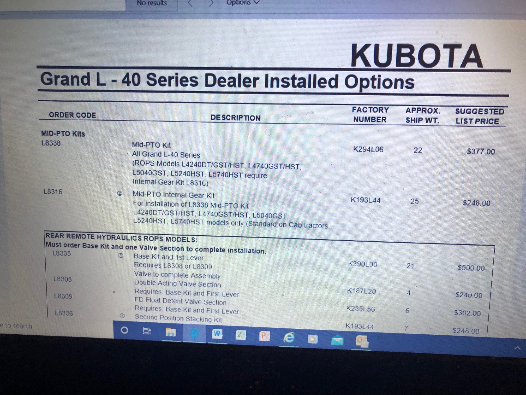

Thanks for all of the replies gentlemen. Not sure if anyone will see this question, but any ideas how much it costs to add a front (mid) PTO to a 40 series grand? I'm guessing that won't be cheap either. I guess I'm realizing in dollars why everyone recommends getting machines with all the extras at the time of purchase. This particular machine is a really clean 5740 with 1500 hours, for $25k. Adding all the hydraulics will be 3 to 4k, mid PTO adds more, and the goal of adding a backhoe adds another $5k bare minimum, if I'd be lucky enough to find a used one with the subframe. This same seller had a really clean L45 a few months back, with a rear remote and obviously a hoe, for $28k. The price of used machines really starts to vary wildly when you get into add ons and backhoes.

With respect to post 11.
Adding the mid PTO is rather simple and reasonably priced. Unfortunately you'll need to confirm if this tractor has the internal gear to drive it. Although only a few hundred bucks, the tractor needs to be split for the installation of the internal gear.
I've attached a copy of the wholegoods document you can read to gain a better understanding of the situation. Also suggest you contact your local dealer with SN in hand to see if they can decipher if it was built with the internal gear. Also have the dealer verify the information about internal gear as these documents can be wrong or superseded. Ignore the prices as the document is old and will need to be confirmed. At least you're armed with info to be better educated. :)
Kubota Backhoe BH92 new will be close to $11,000 once installed.
Good luck
