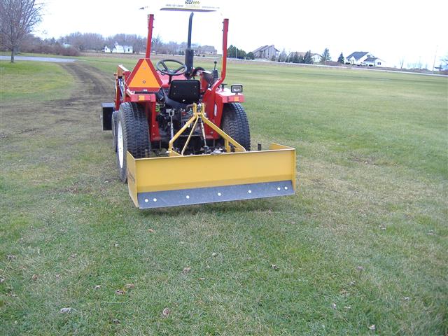

Tery, TSC has a good boxblade. Here is mine. Check Craigslist for what you want also.
