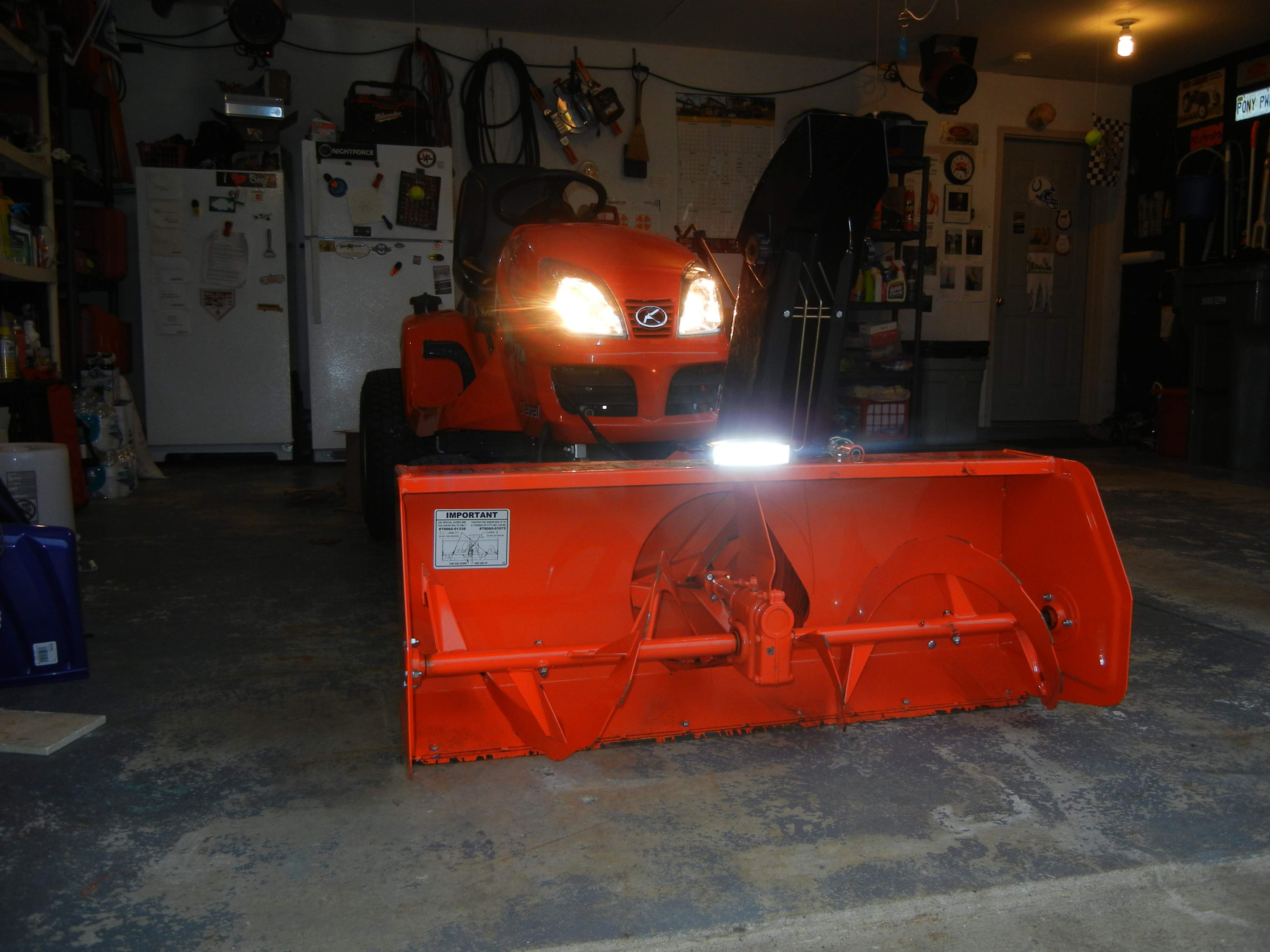

A couple mods you may want to consider....Light for snow blower. Check the exhaust pipe outlet to snow blower frame, mine was really close, so I took and inch or so off the pipe. Racor fuel filter with water separator and drain. I also increased idle speed from 1300 rpm to 1800 rpm. Philip.

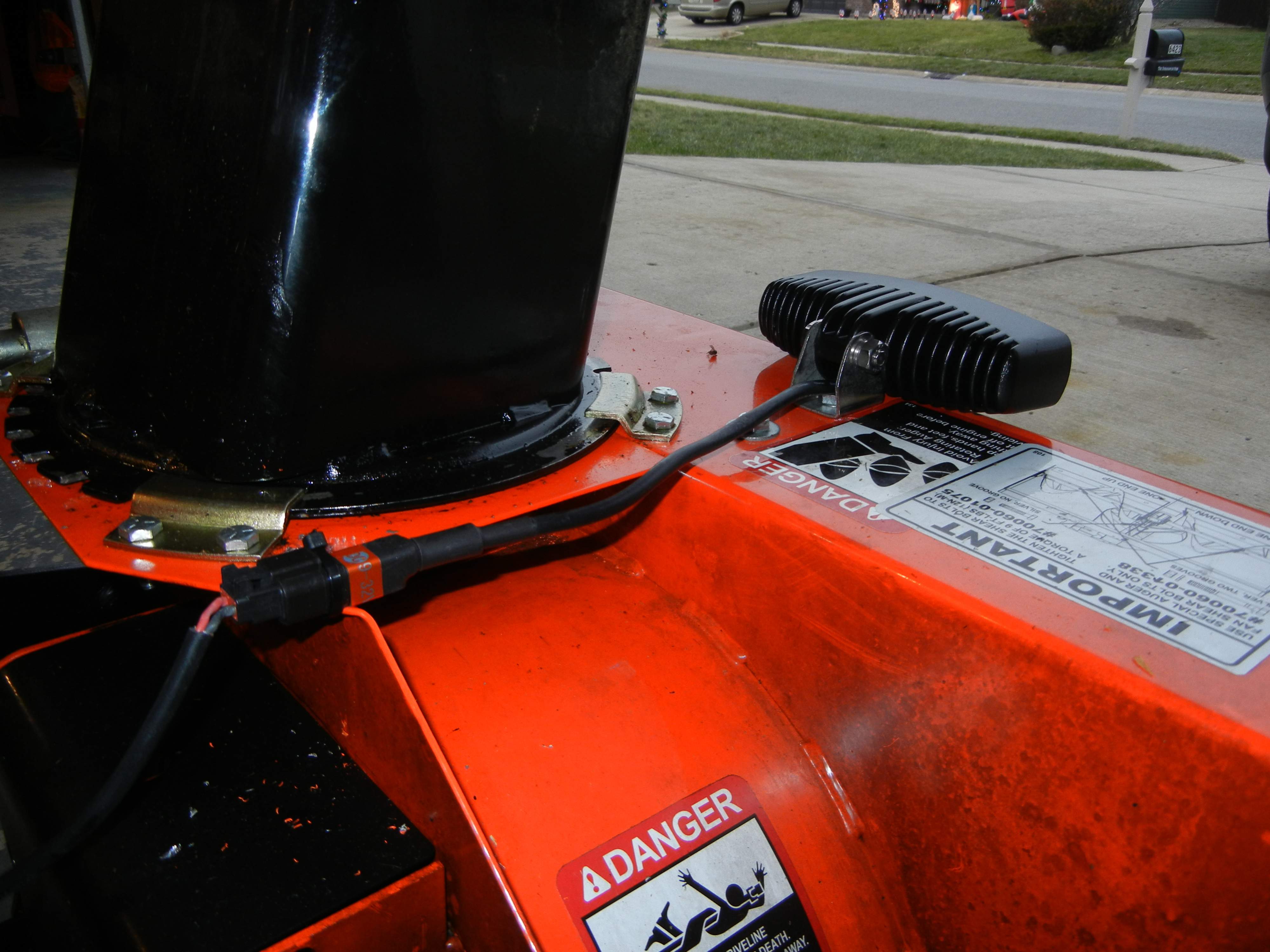

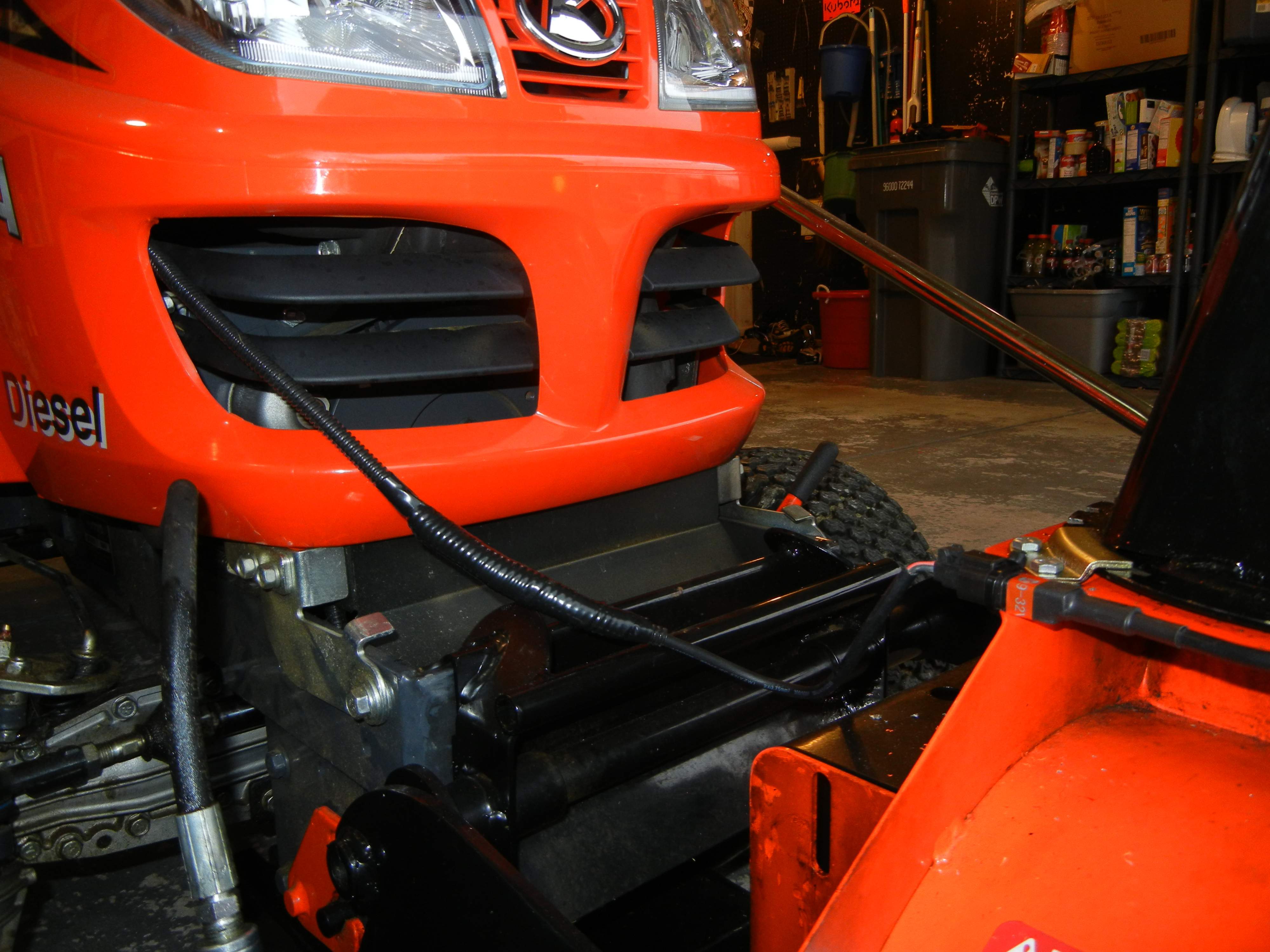

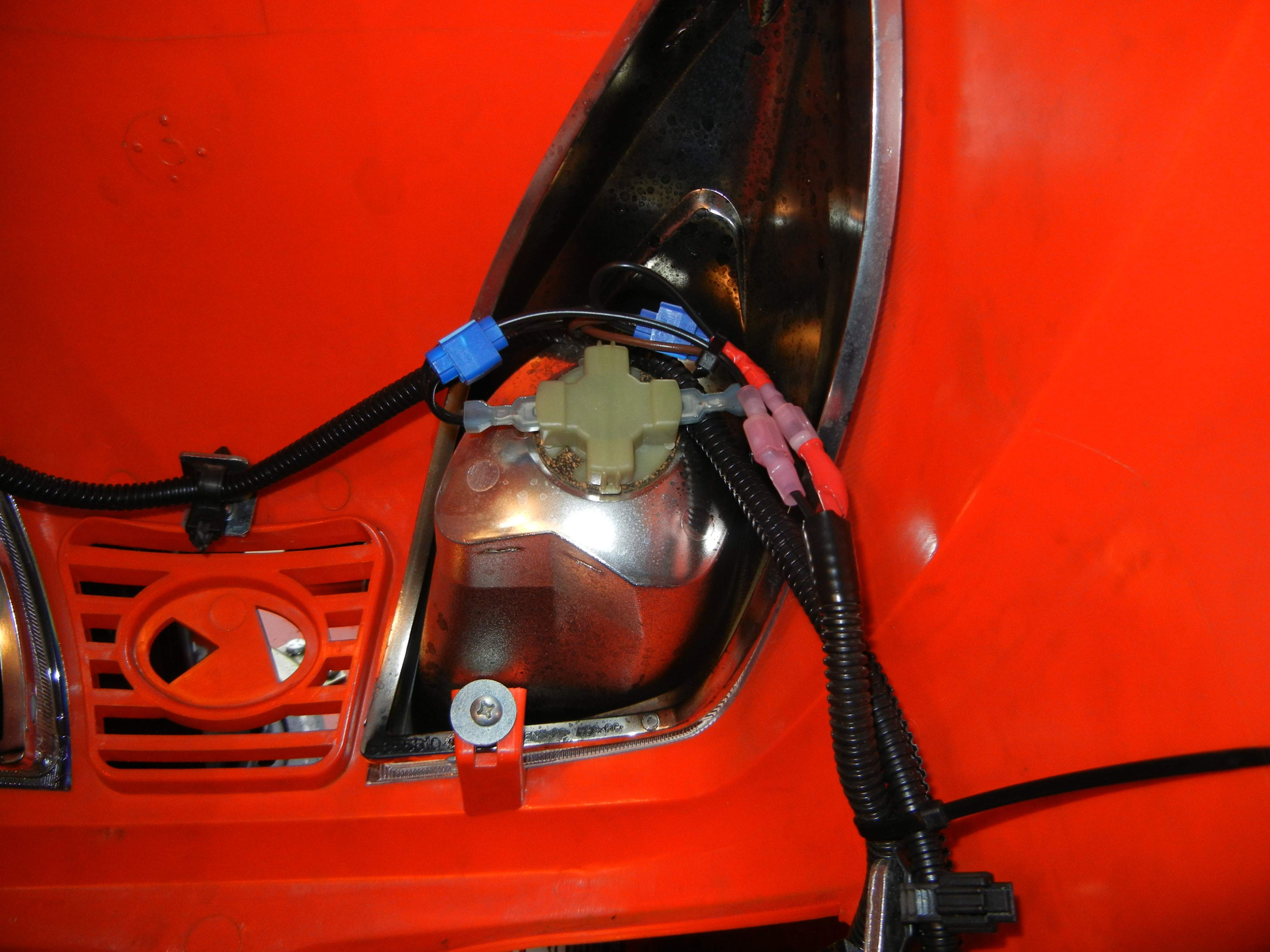

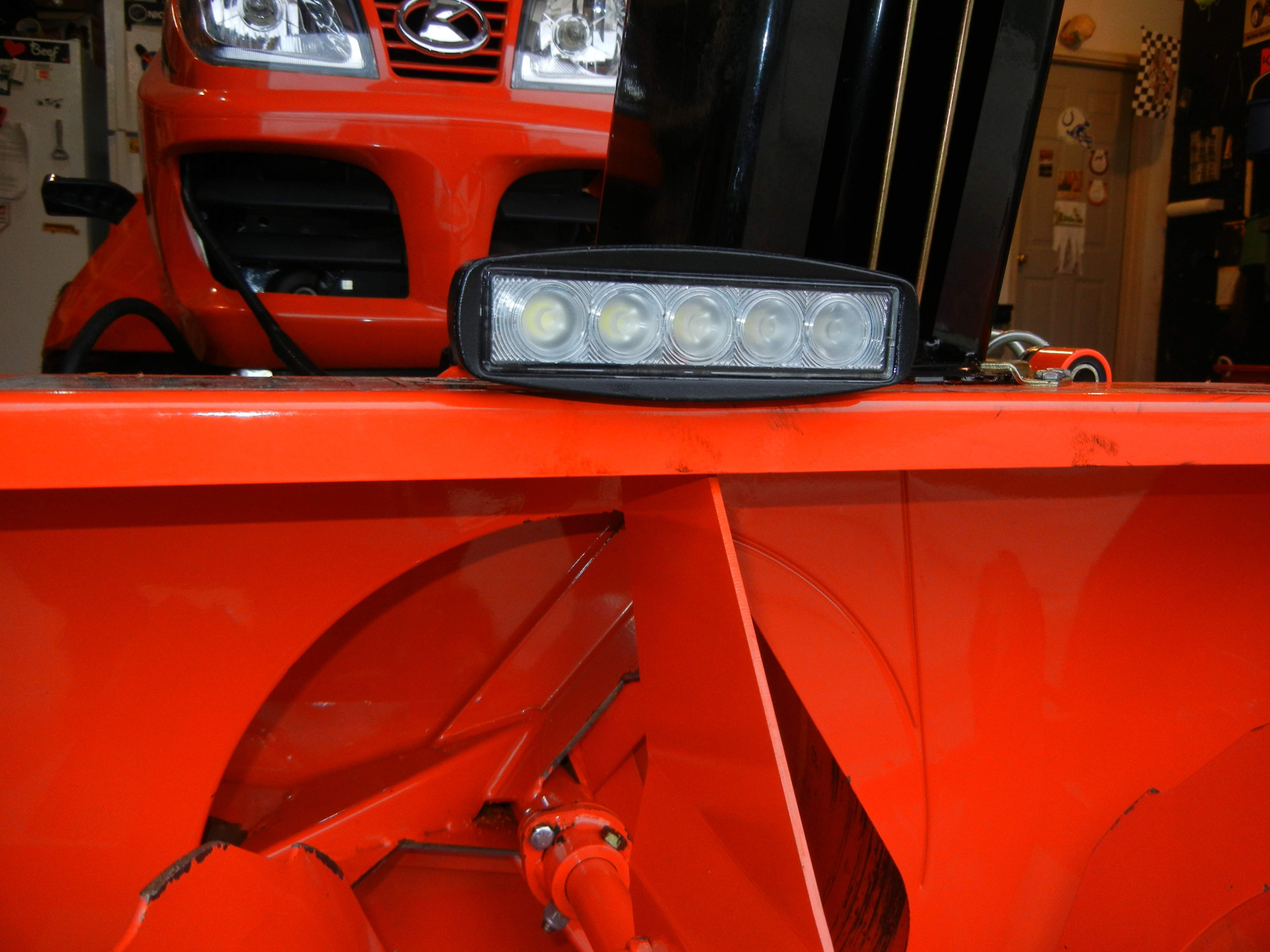

Yeah. I think the light on the blower is a good idea. I have a water separator/filter on my storage tank, so every time I pump the diesel it gets filtered in real-time. I only buy enough diesel to last me about 2 months at a time, so I think I’m pretty well covered for water in the fuel.
How did you connect your light in?
/ GR2120 Would NOT buy again! #20
For the light I am running a low wattage high output LED, so I spliced into the headlight wiring, added 1/4" spade disconnect so I can remove, and ran wire thru grill. See if you can get idea from pics here.
For snow blower, make sure you have spare shear bolts (and nuts). Auger shaft (#9 in manual) is special bolt with grooves, Kubota p/n 70060-01338. For the fan (#22 in manual) I use a 1/4"-20x1" grade 5 (manual call out 3/4").
