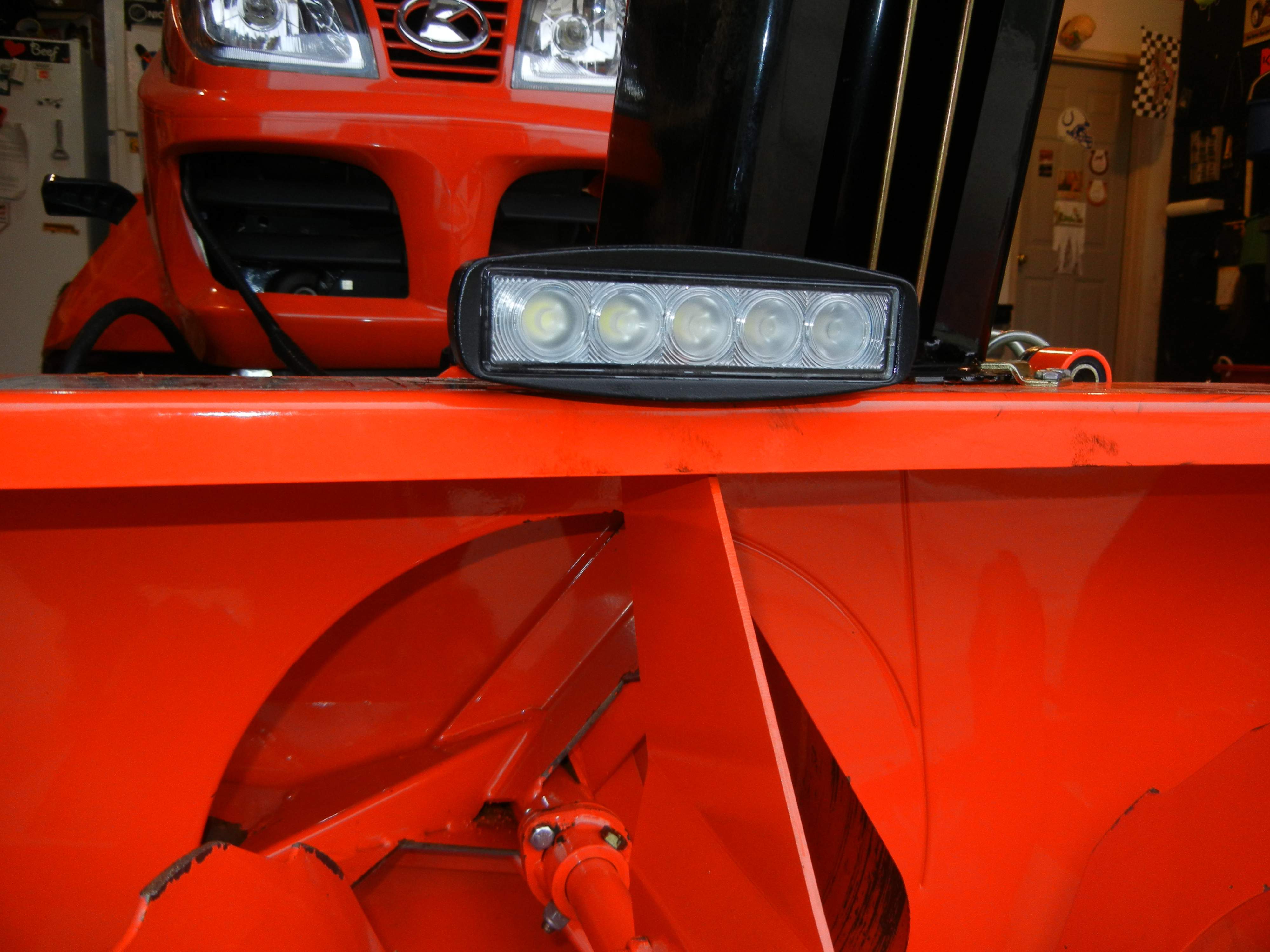

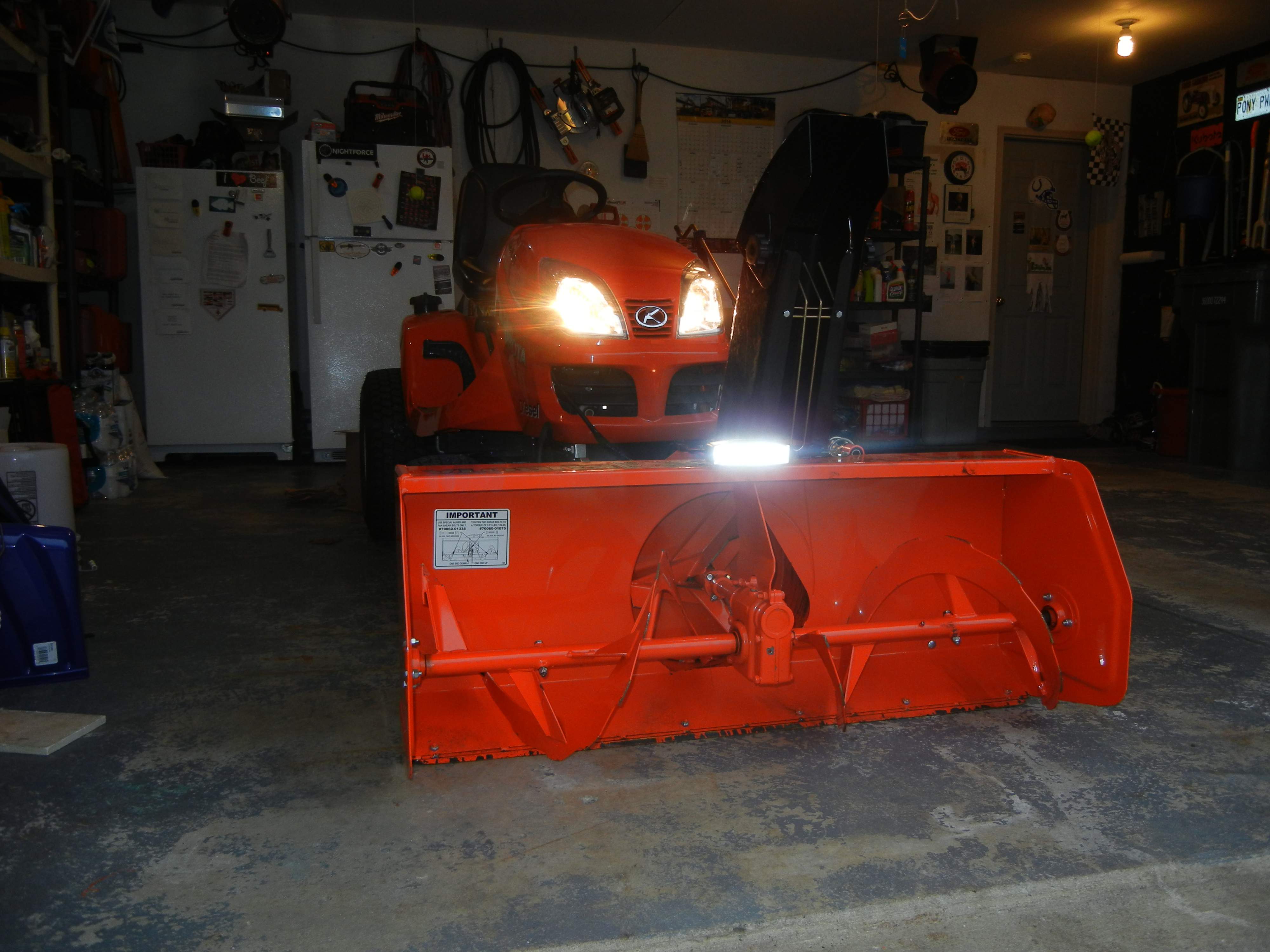

A couple mods you may want to consider....Light for snow blower. Check the exhaust pipe outlet to snow blower frame, mine was really close, so I took and inch or so off the pipe. Racor fuel filter with water separator and drain. I also increased idle speed from 1300 rpm to 1800 rpm. Philip.

Yeah. I think the light on the blower is a good idea. I have a water separator/filter on my storage tank, so every time I pump the diesel it gets filtered in real-time. I only buy enough diesel to last me about 2 months at a time, so I think I’m pretty well covered for water in the fuel.

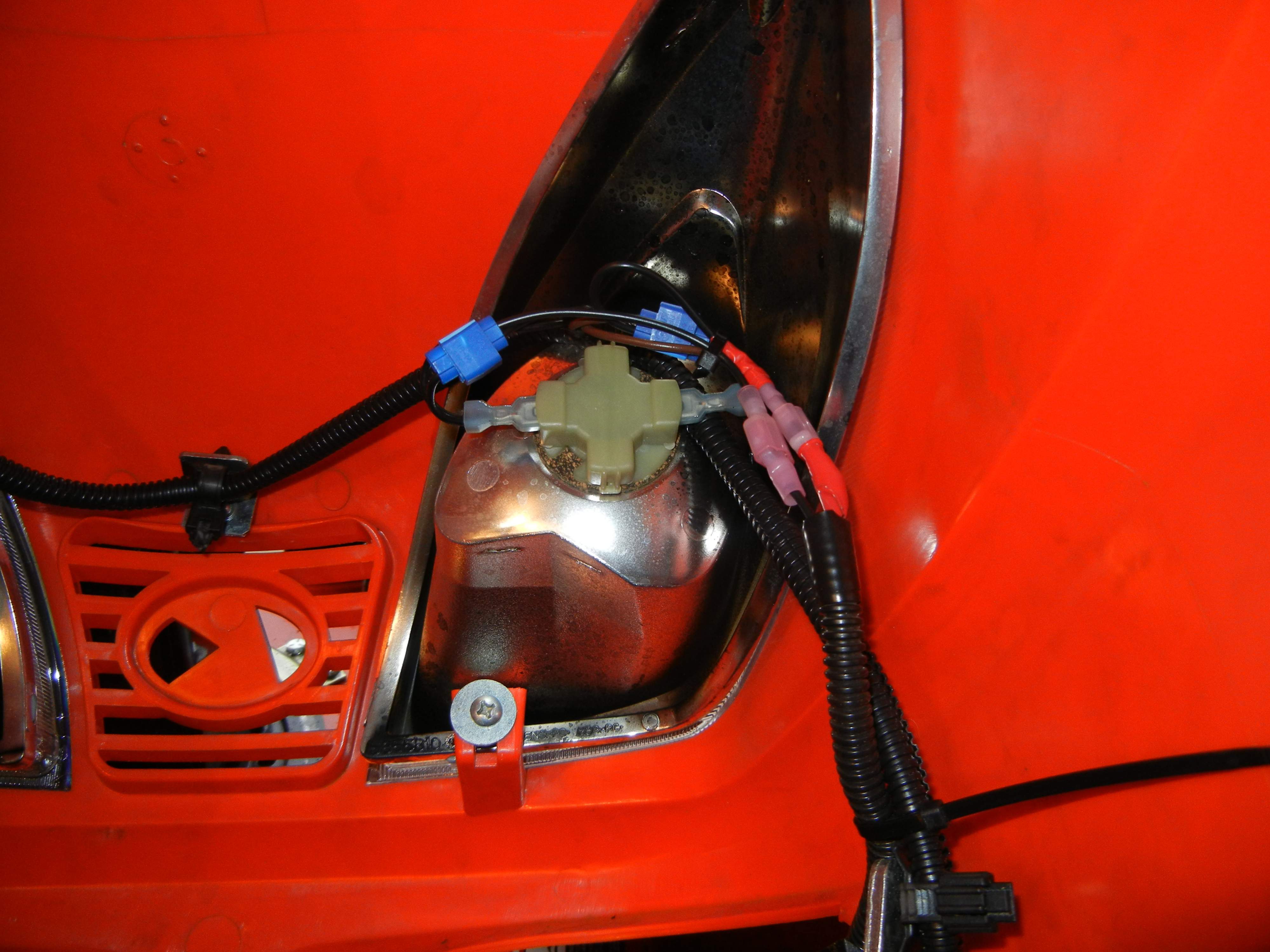

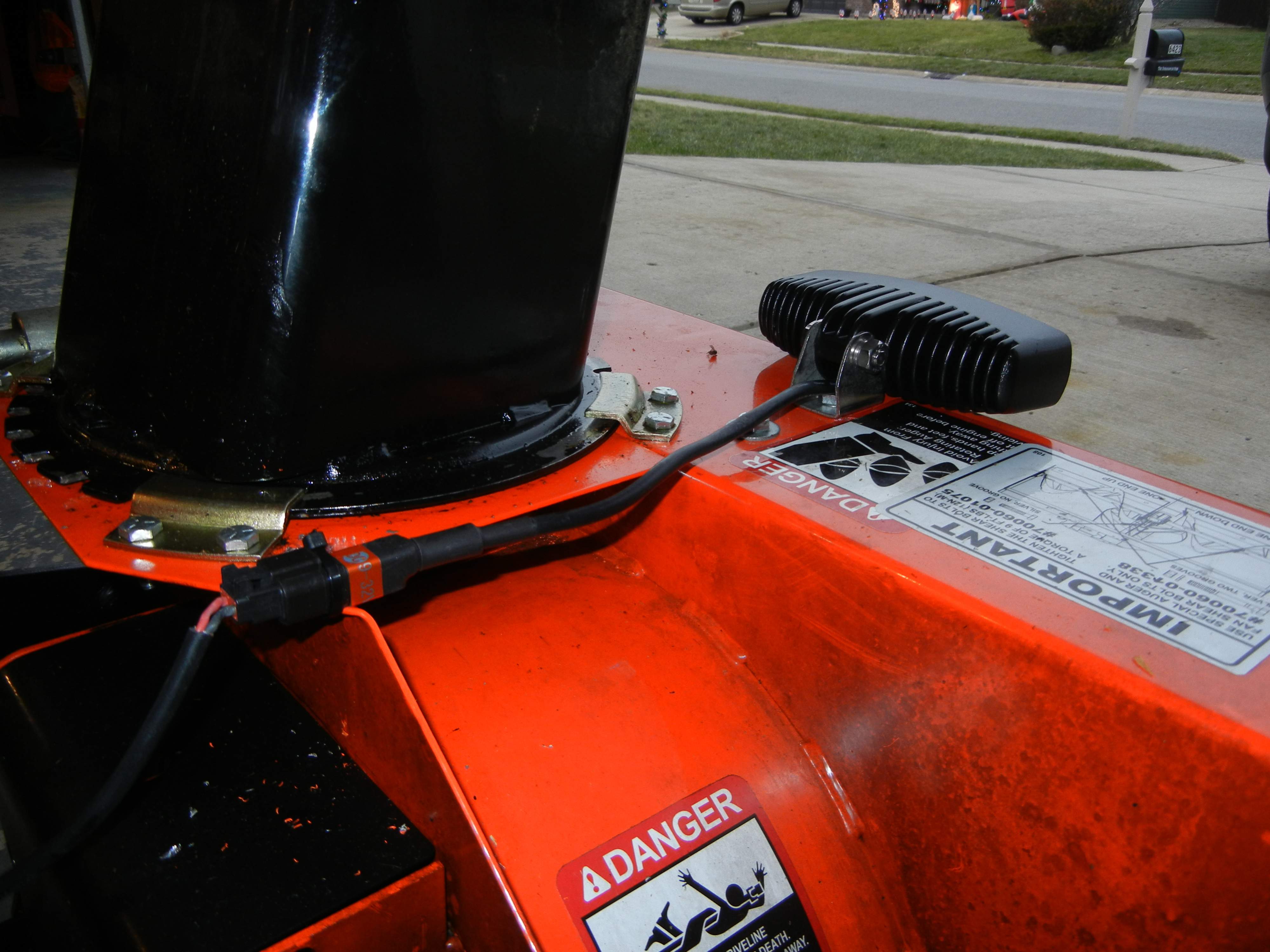

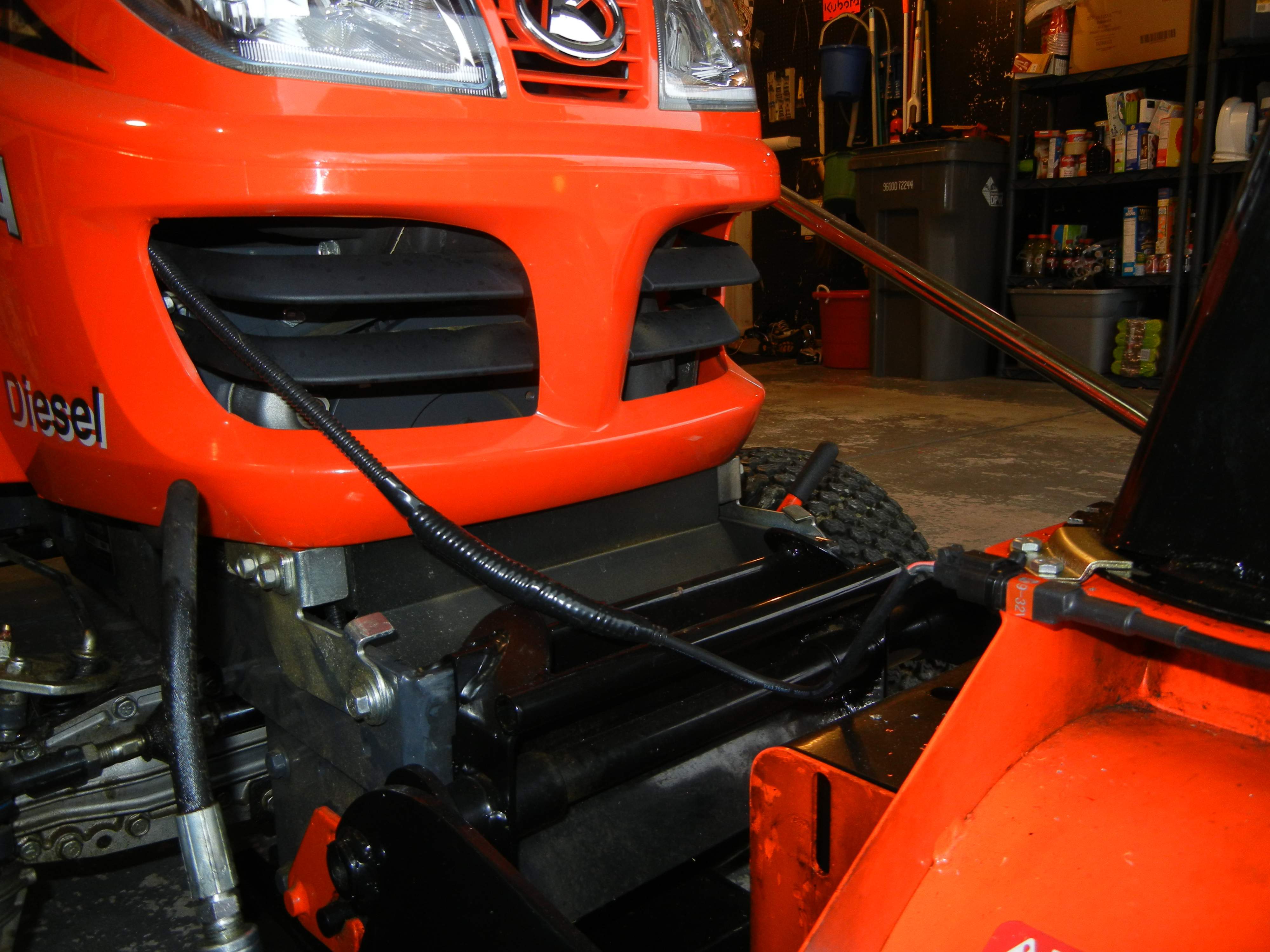

For the light I am running a low wattage high output LED, so I spliced into the headlight wiring, added 1/4" spade disconnect so I can remove, and ran wire thru grill. See if you can get idea from pics here.
For snow blower, make sure you have spare shear bolts (and nuts). Auger shaft (#9 in manual) is special bolt with grooves, Kubota p/n 70060-01338. For the fan (#22 in manual) I use a 1/4"-20x1" grade 5 (manual call out 3/4").

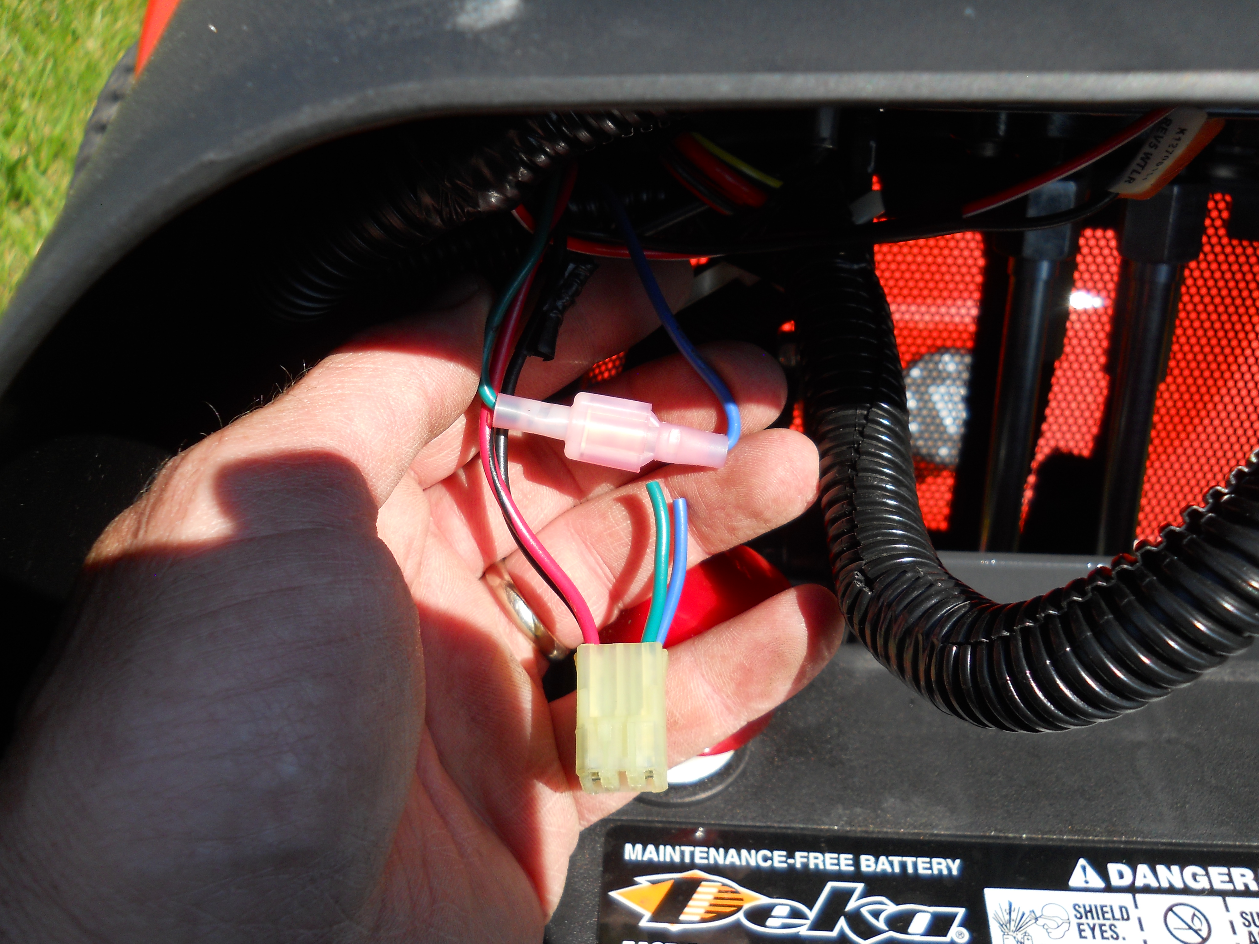

One other thing, this has Reverse Mower Awareness switch, when mower is engaged, you have to push button to go in reverse, PITA. They way I did it: Remove RMA switch from dashboard. Remove electrical connector from back of switch. Re-install switch in dashboard. See pic. Cut and splice together the two light blue wires going back into the wiring harness. Leave the two cut light blue wires from the connector as they are in the picture. Do nothing with the red/black wires. DO NOT put the electrical connector back on switch. Just put the connector up behind the dash with the rest of the wiring harness and tie wrap back.
