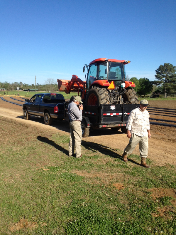

Have plenty of truck . And know its dangerous deal on a bumper pull most likely on a receiver hitch . On one little pin . A bumper pull is no where as stable as a gooseneck load . Really dangerous with that kind of weight .
Hope you stay away from me on the road .
Think I have plenty of truck and trailer if need be .
<img src="http://www.tractorbynet.com/forums/attachment.php?attachmentid=365011"/>
Sent from my iPhone 5 using TractorByNet
Guess it all comes down to comfort level. We pull 25,000# of the bumpers.
As for a 5/8" hitch pin. The sheer point is north of 50,000#.
Chris

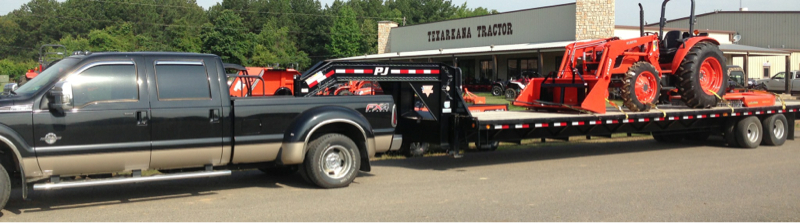

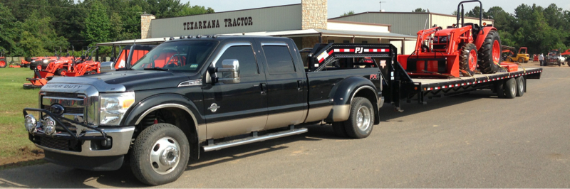

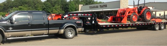

Hard for me to give advice since I have 15 trailers . But I like goosenecks better than bumper pulls .
if I never pull another BP again I'd be happy. I MUCH prefer GN to BP
