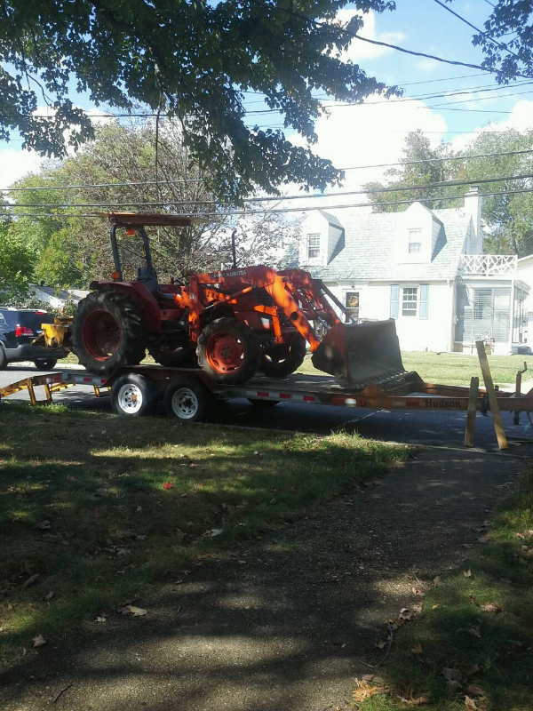

Y'all haven't seen all the wrecks from them heavy loads as I have .that where with bumper pull trailers .
But like said ya just stay away from me on the road . When ya see my front end coming up behind y'all . Pic posted in earlier post . Just stay in the slow lane so I can get around ya in the fast lane.

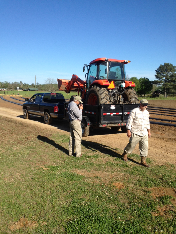

/ Gooseneck or stick with bumper pull ? #18
Six in one hand, 1/2 a dozen in the other. I have no problem with either. I really do not have a preference as far as gooseneck or bumper pull. A well built trailer will do its job. I prefer a low trailer for equipment. The dual tandem trailer in the pic is nice but I would use the bumper pull for that tractor. There is no such thing as a perfect trailer, but it sounds as if you will only have the one. I would pick the one that is most flexible for all your needs.
Sometimes you don't get your preferences!
