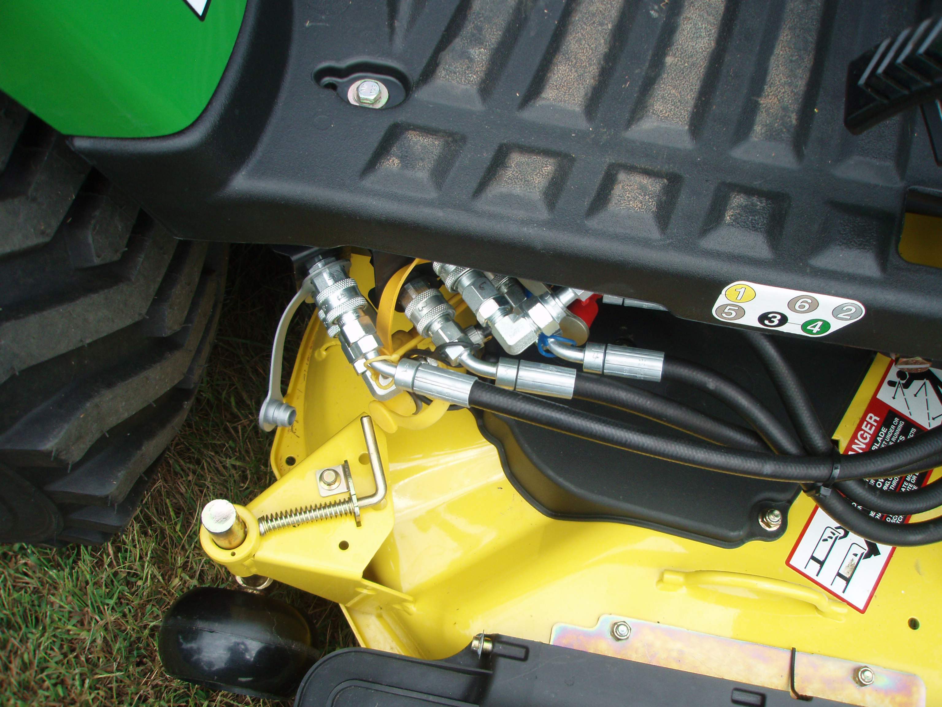

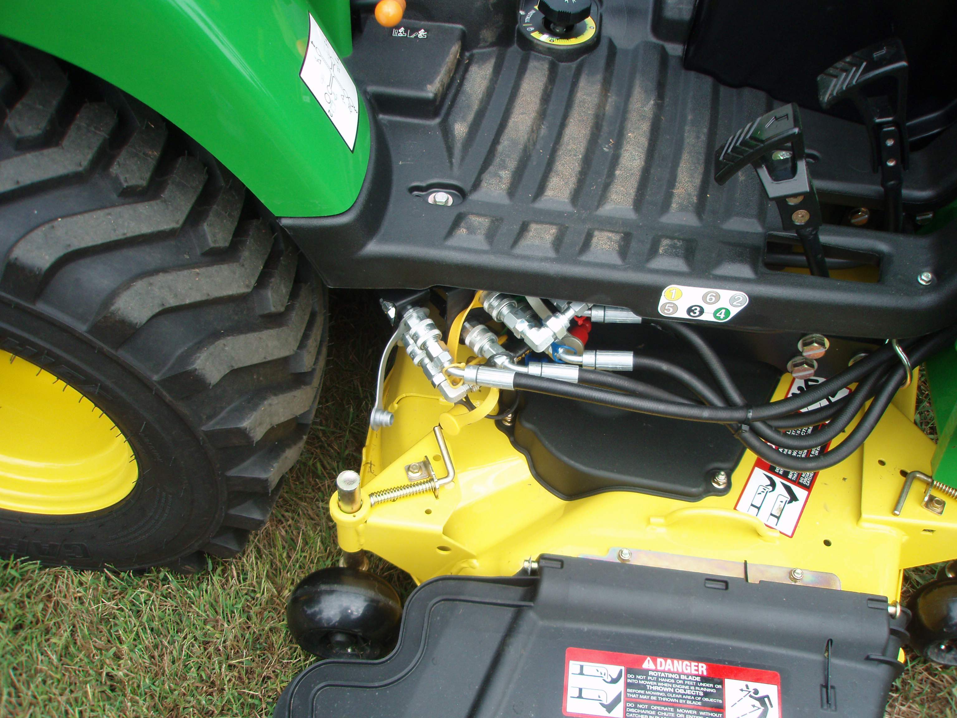

I have the "optional" hydraulic deck lift, and kind of regretting that decision.
Units I have seen with the optional hydraulic deck lift have a valve on the fender. Out the Joy Stick Control works the loader. In the Joy Stick Control raises and lowers the mower. On most, tilt the control lever to the left and the deck raises, tilt the lever to the right and the deck lowers. The control valve is usually located just above the decal on the left rear fender show in the first photograph. The decal is a pictorial guide on how the valve works. The second photo show the hose busy area underneath the right foot, with a numbering system where the houses connect.
/ Goodbye 2305, hello 1025r! #8

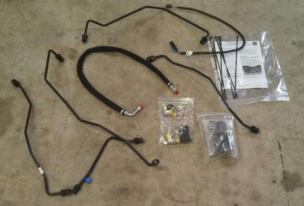

There is yet a third option for the deck lift. The part number (I think) is LVB26207. It has a completely independent electro hydraulic valve. Here is a picture of the kit from a thread over on GTT.
It seems like it would be the way to go...no hooking and unhooking hoses.
